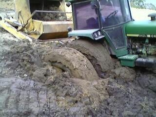

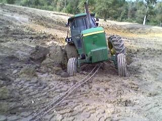

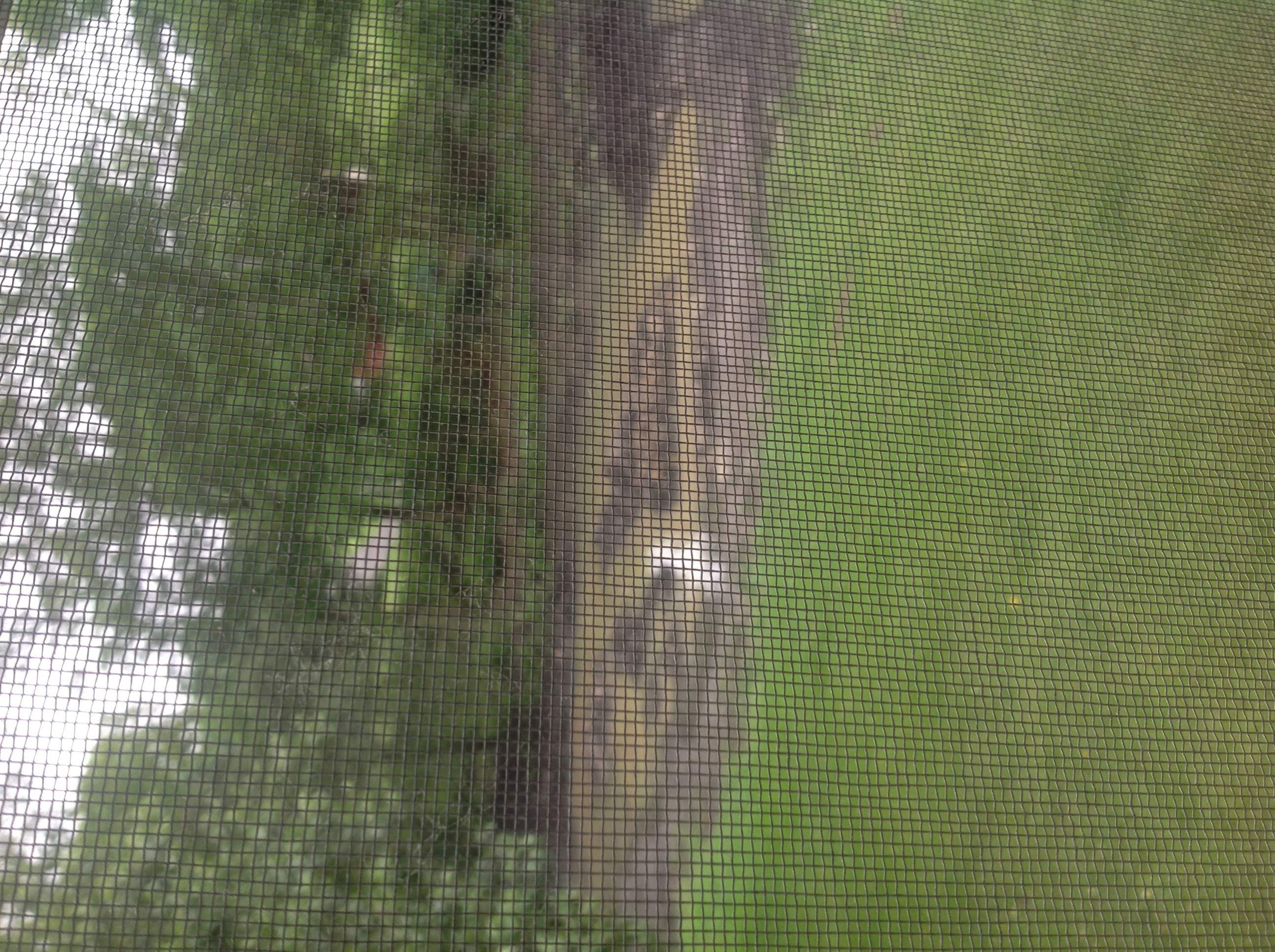

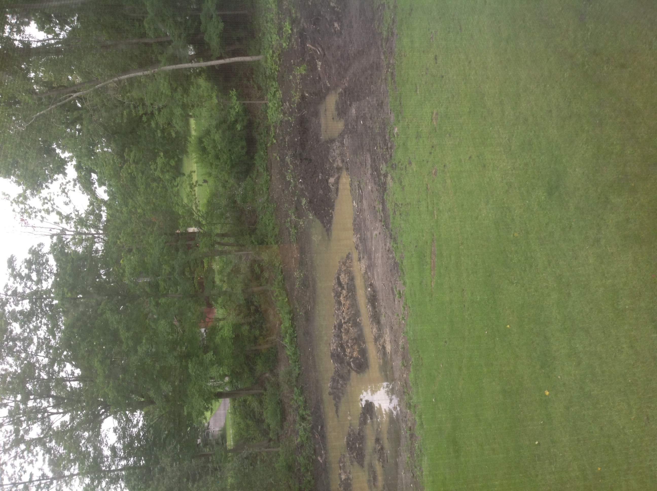

Heres a couple of pics of muck in a pond that was allowed over a year to dry. Notice the left side of tractor is on good firm soil and the right is out of sight. It was just a small damp spot that we had run back and forth over all day pulling out a layer at a time. Then this happened. Two bulldozers, a backhoe, numerous broken chains and half a day later we got back to work.

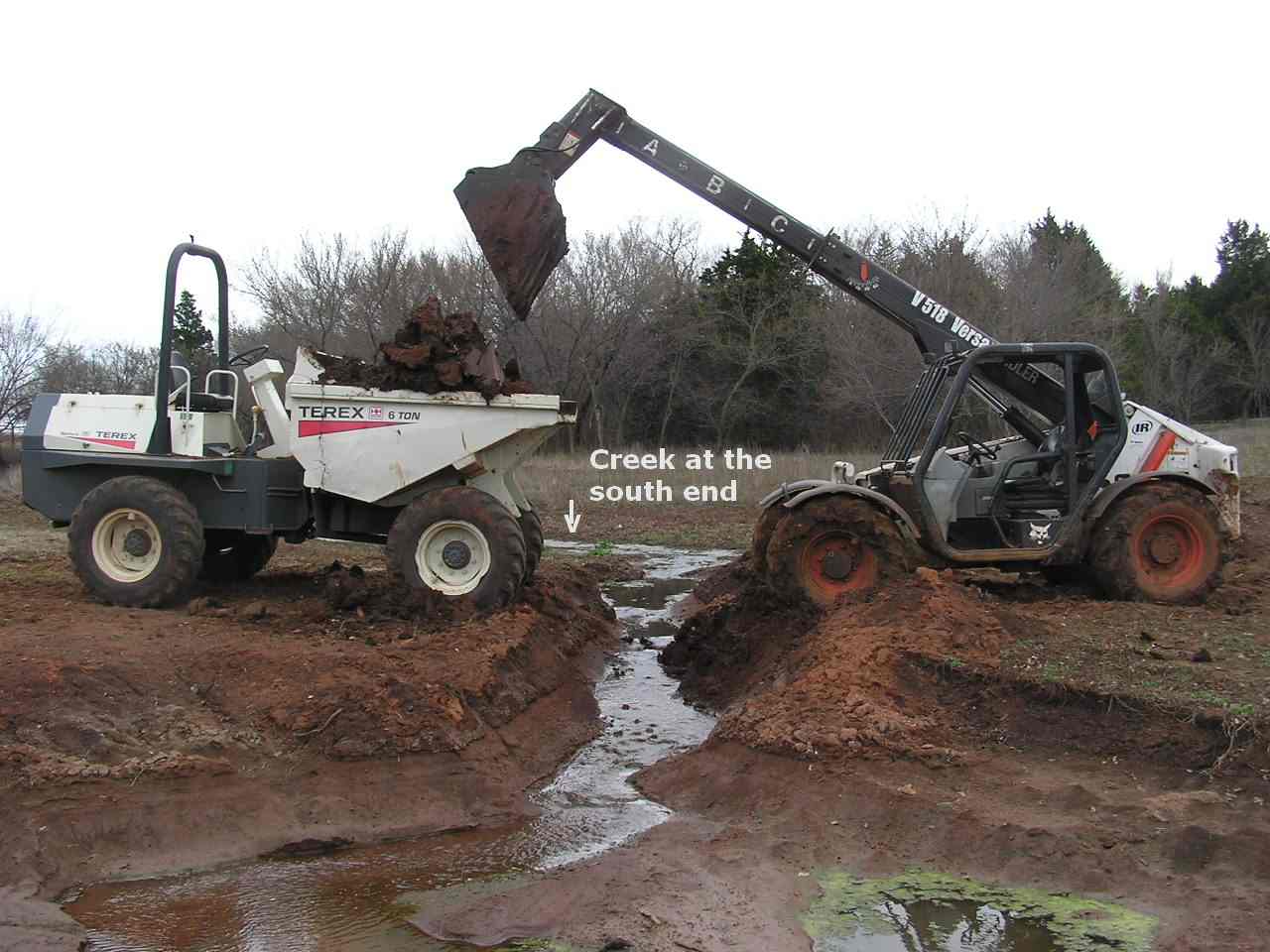

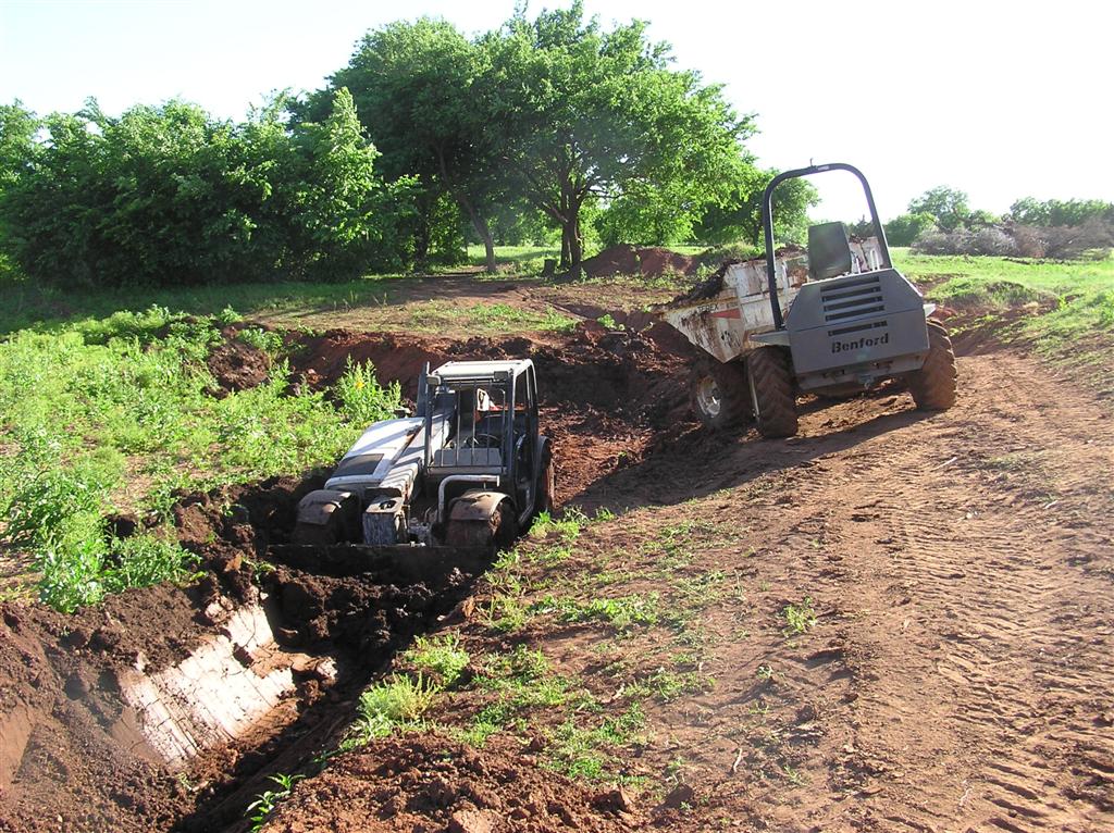

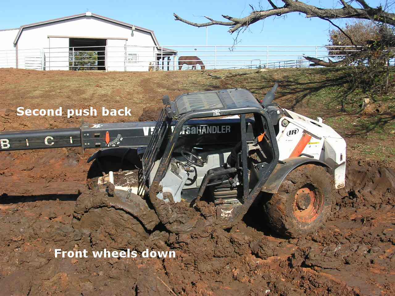

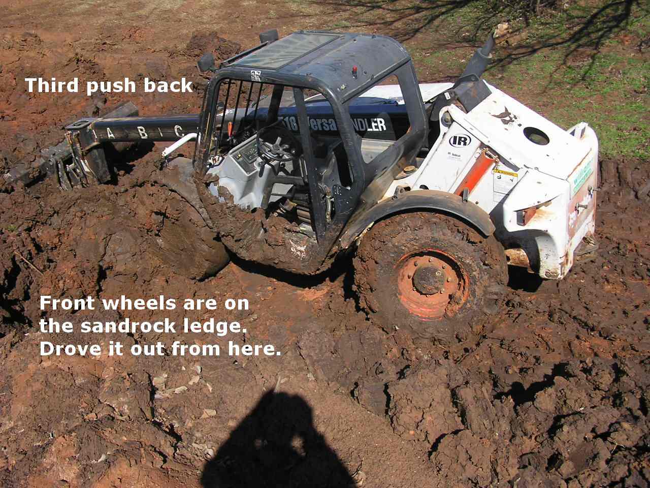

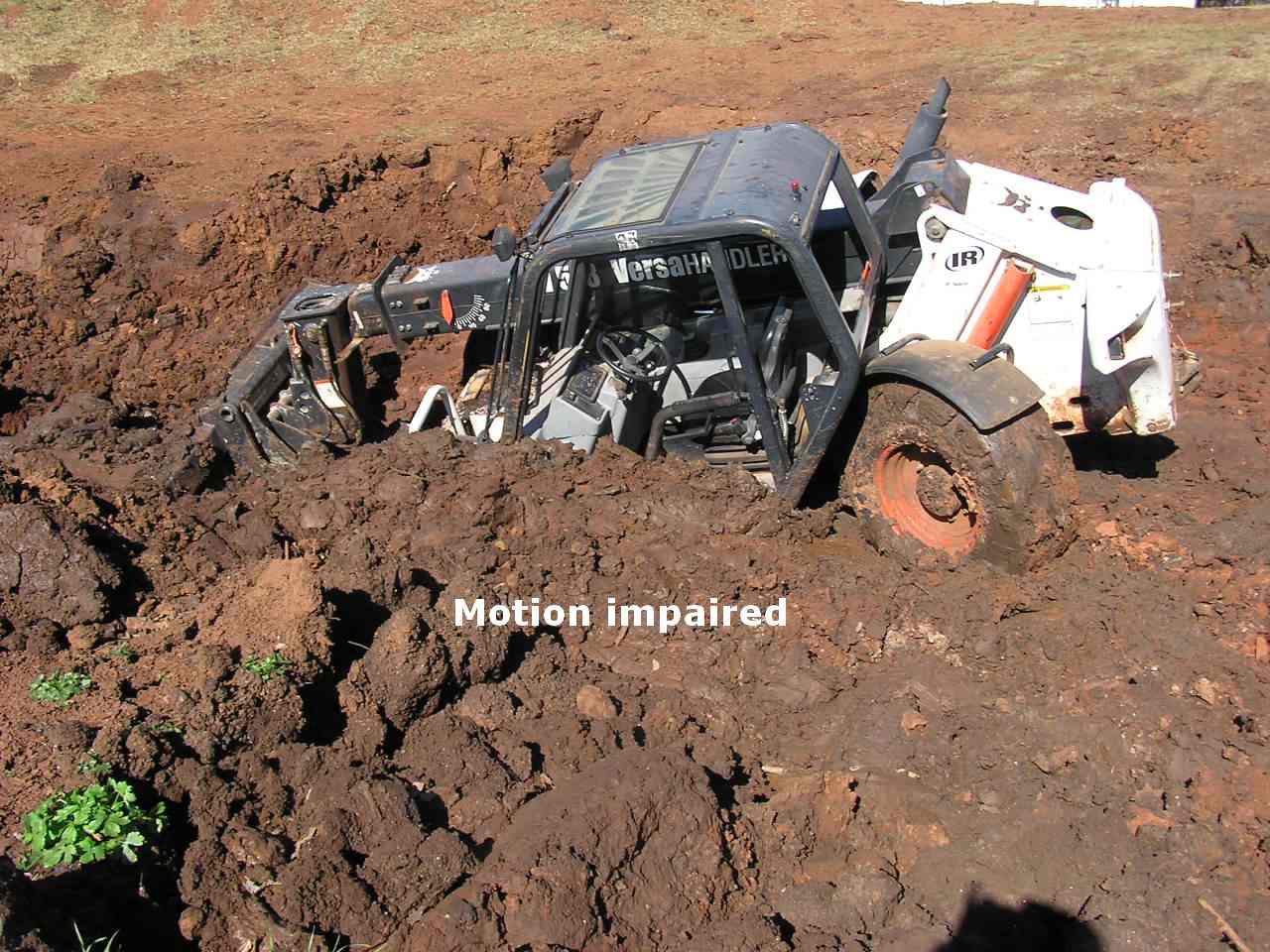

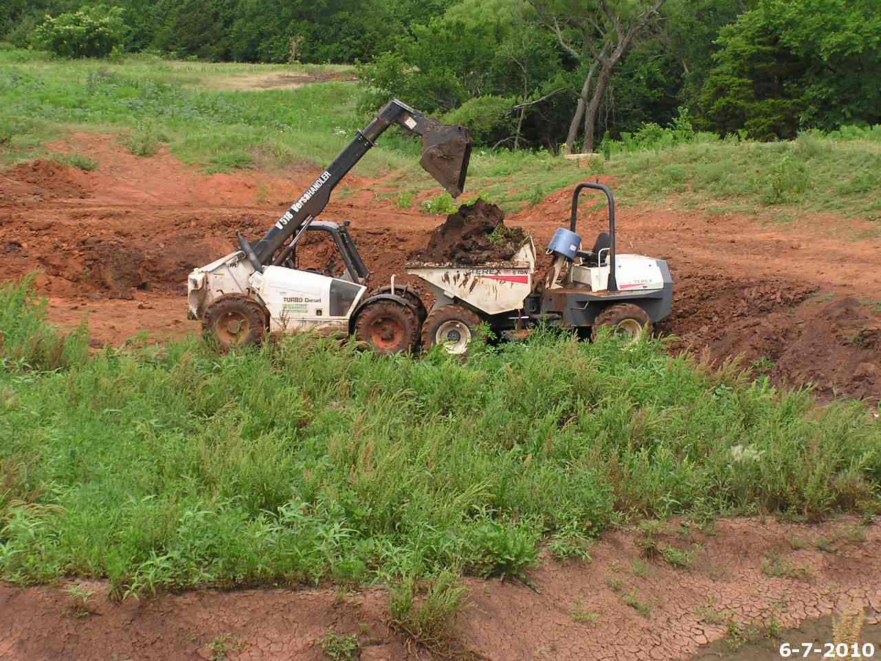

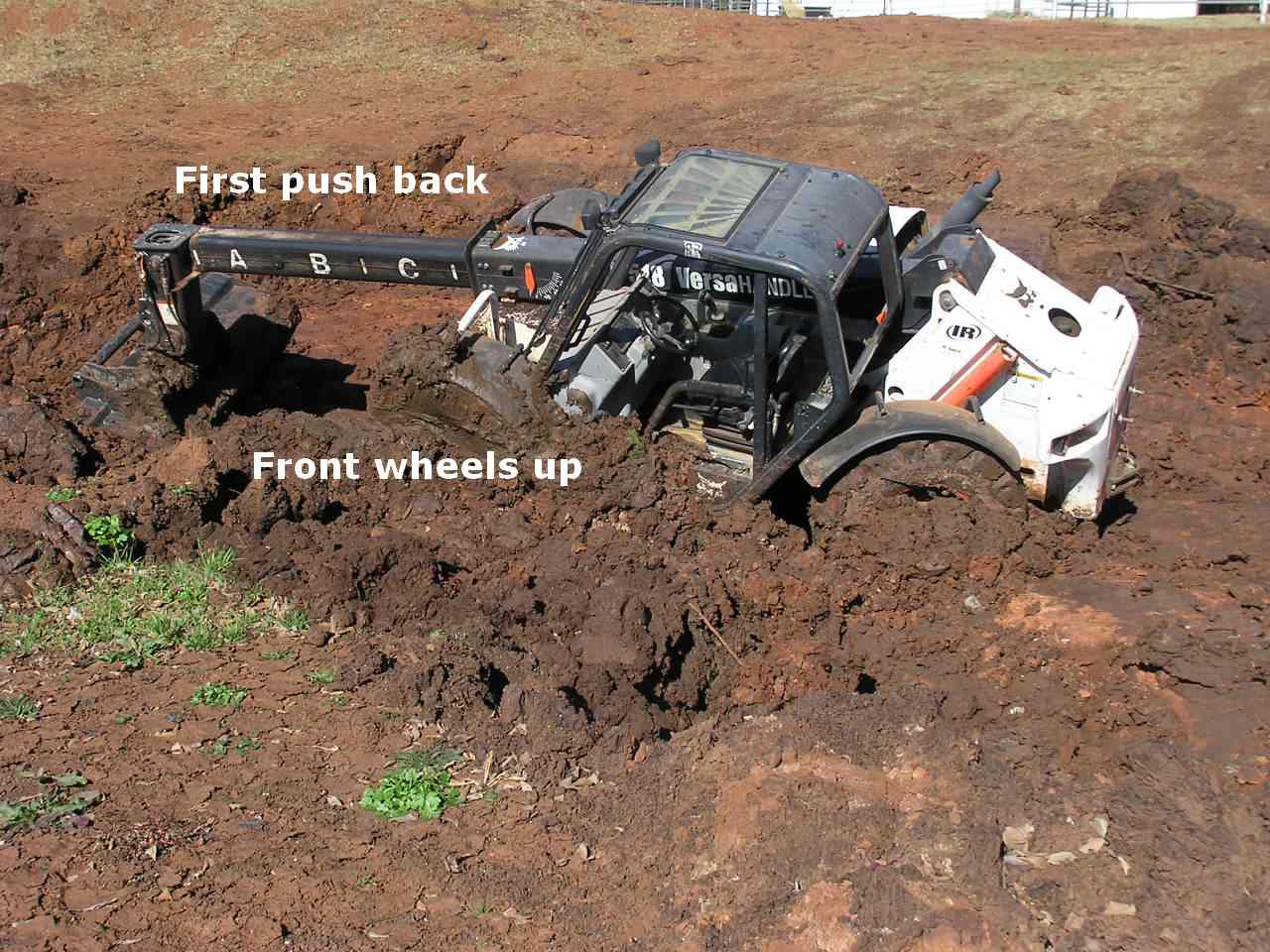

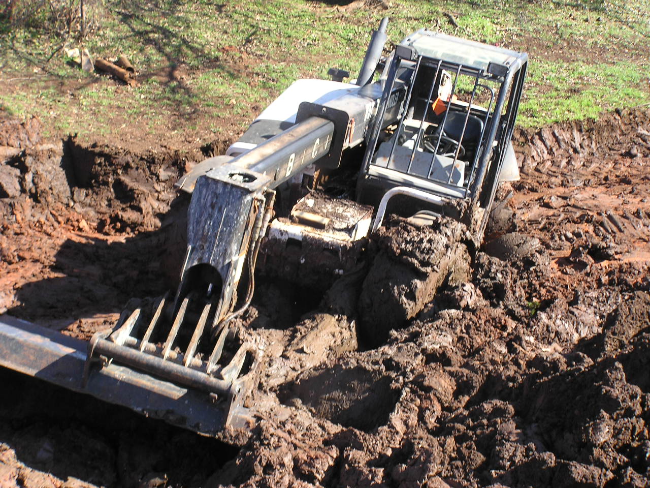

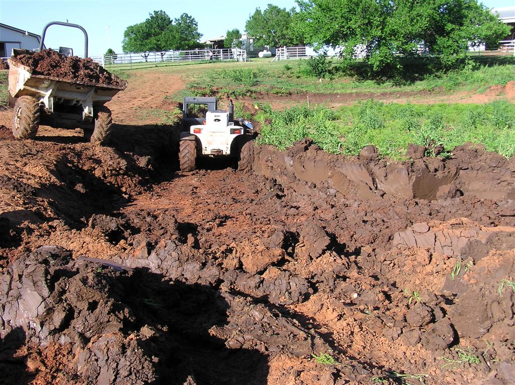

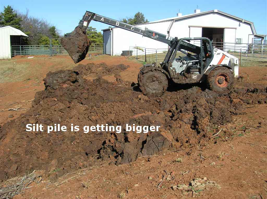

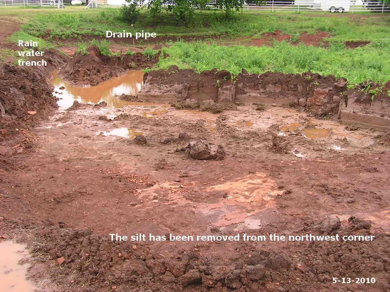

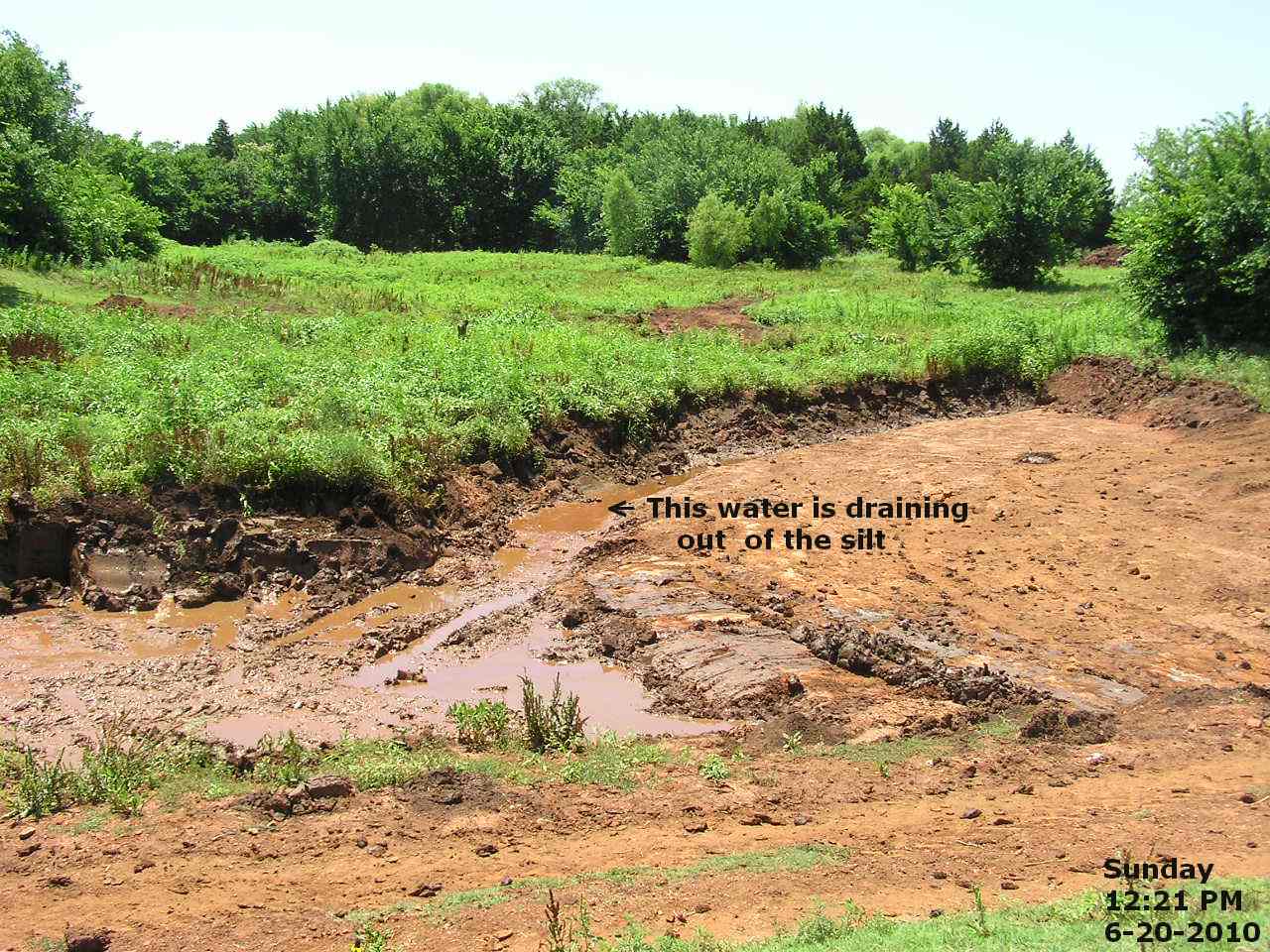

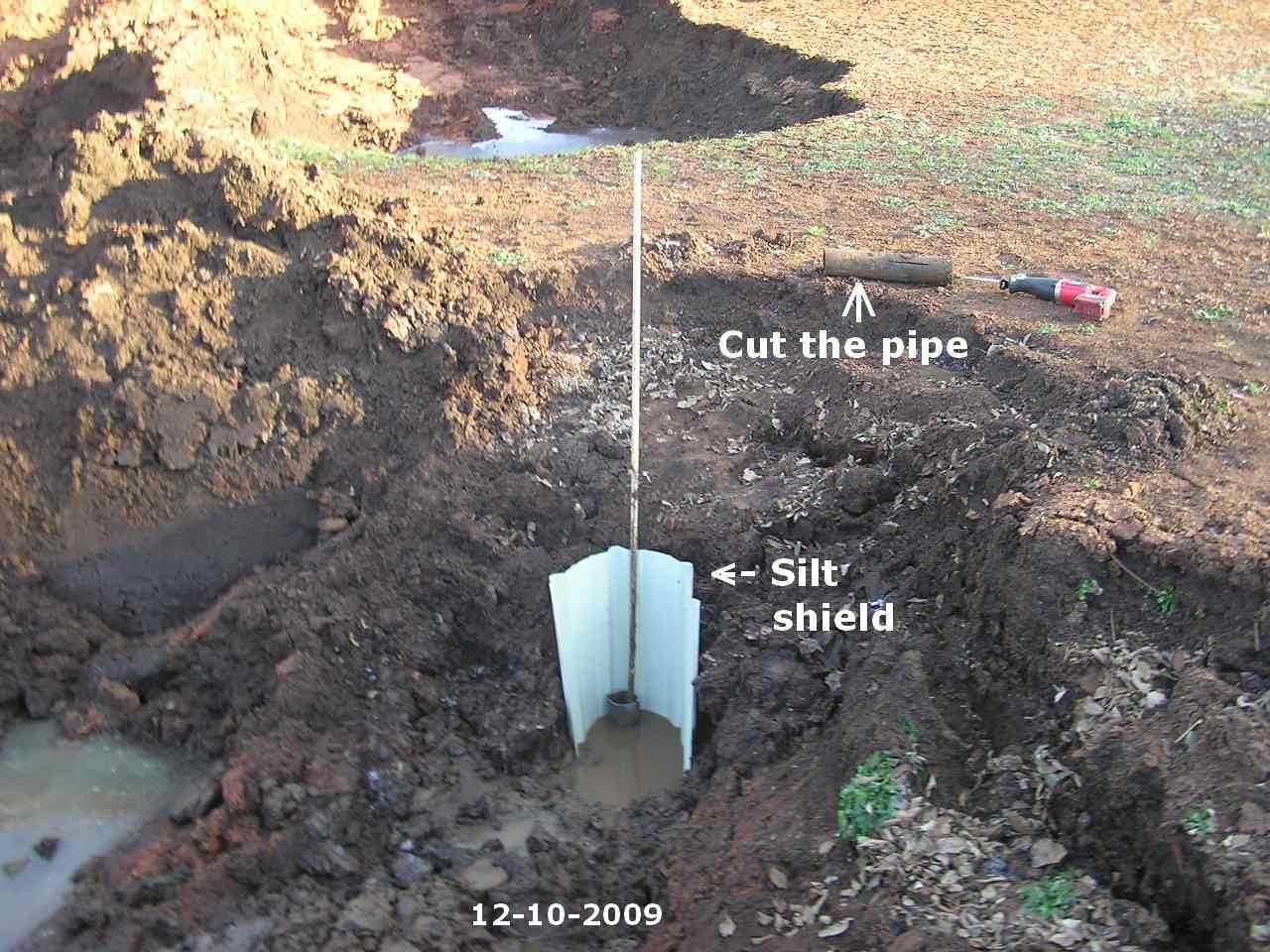

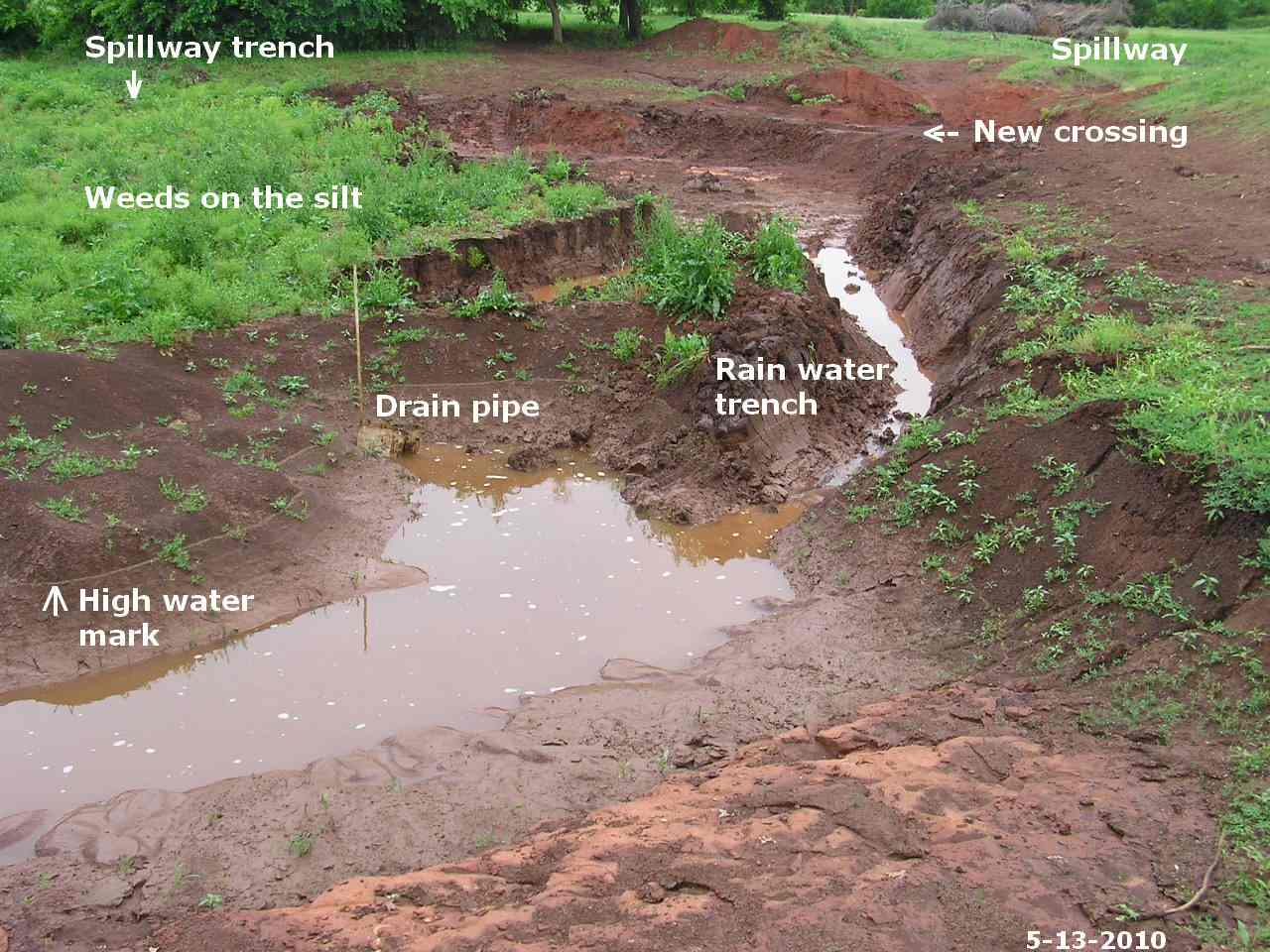

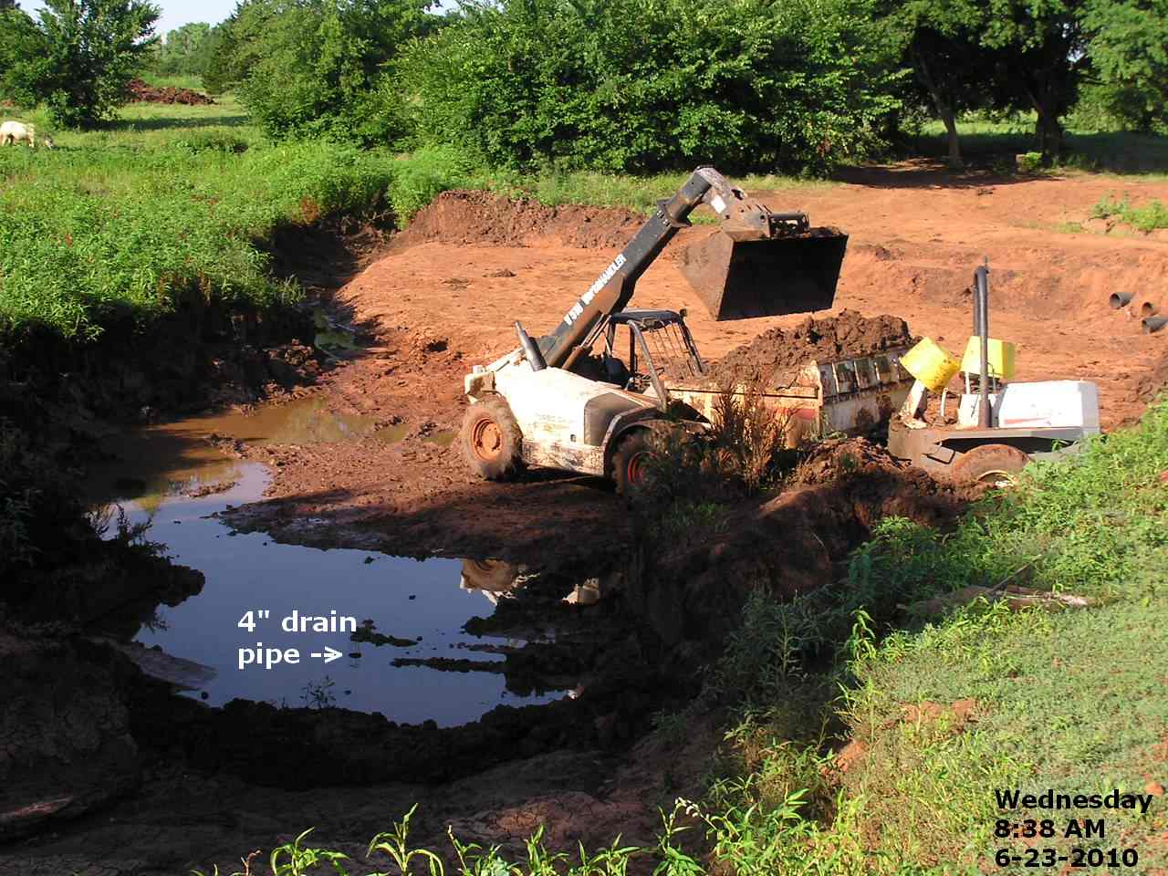

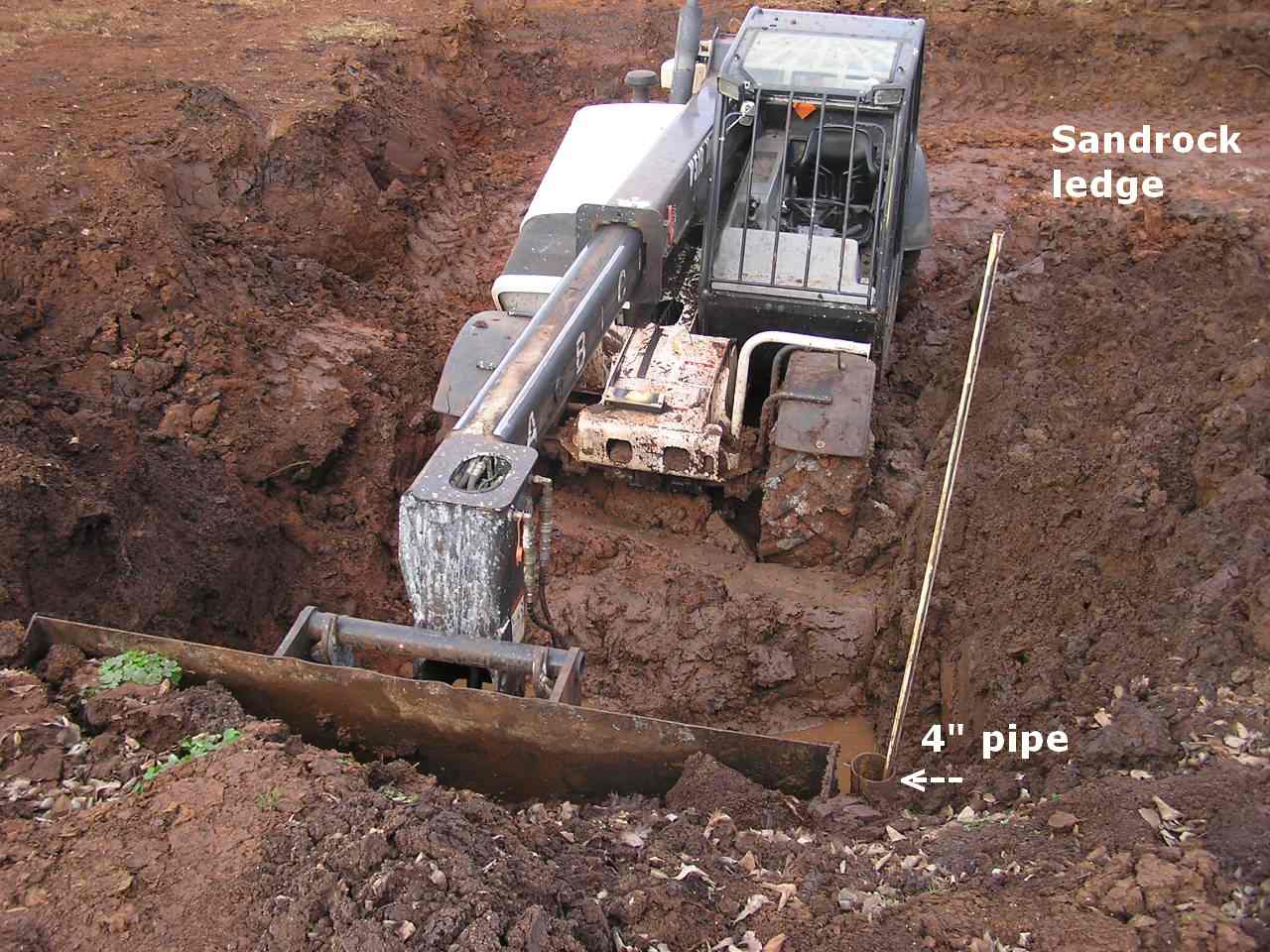

Yep, been there done that, The first pictures are from November 2009. Silt was 5' deep.
The bucket is 7.5' wide, 1.25 cubic yards.
PB300008.JPG PB300020.JPG PB300023.JPG PB300025.JPG PB300027.JPG PB300030 (Large).JPG
Moved 4.5 cubic yards at a time with the dumper.
