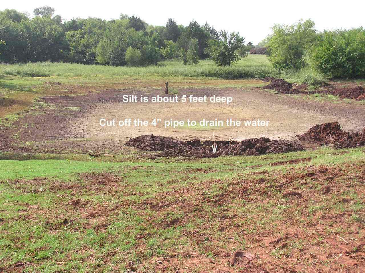

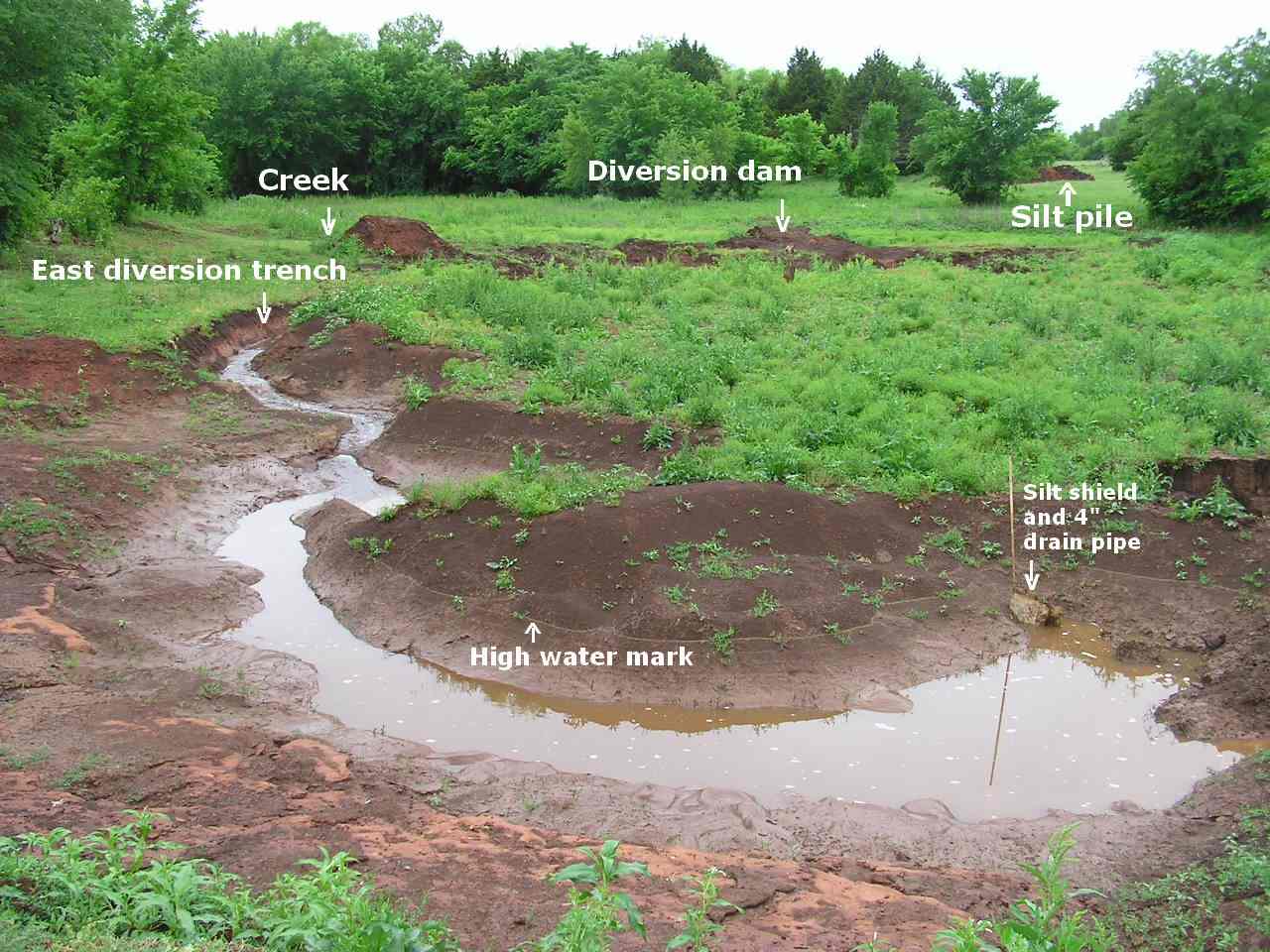

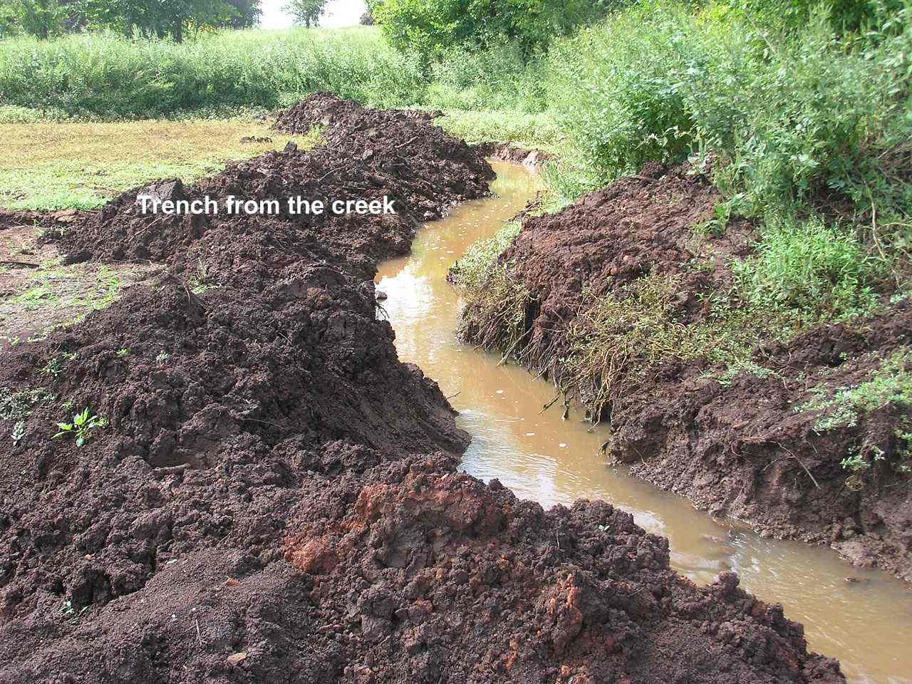

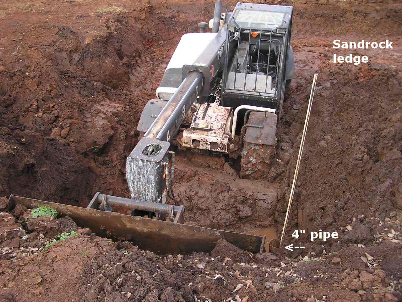

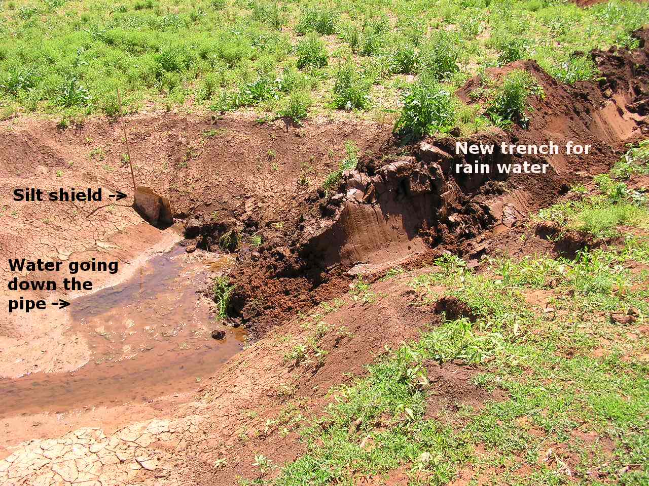

The main reason I decided to do mine myself, was the 4" steel drain pipe that was put in the creek and the dam built over the pipe.
Right click each picture to open in a new tab or window.
P1010001.JPG P9200006.JPG PA090020.JPG P5170142.JPG PC080007.JPG PC100008.JPG
These were taken about 9 months after I started removing silt, moving 4.5 cubic yards at a time, working on it as conditions and other obligations permitted.

I picked up a rate sheet from an equipment place the other day and was surprised to see I could rent a 47,000lb excavator with a 42" bucket for $1600 a week. Fuel would probably run you another $1,000 plus whatever other charges there are (delivery, insurance etc).
The question is "how many weeks"? My bucket was 7.5 feet wide and held 1.25 cubic yards.
Says it has 32 feet of reach. Given the dimensions of the pond you listed you could possibly do one pass down the middle moving dirt to each side as far as you can reach (lets say 40 foot or so swath since you have to pile) then a pass down each side moving the dirt up out of the pond. All assuming of course it is in a fairly open/flat area with no access issues and the dirt can be put to each side and dealt with later. Never having operated a big excavator maybe someone else can chime in on how realistic a plan that is. Biggest problem I see is the pass down the middle would probably be really mucky. Got trees you could use to make a mat as you go like they did in the TV show Swamp Loggers?
Dirt is not the correct word, think "pudding"

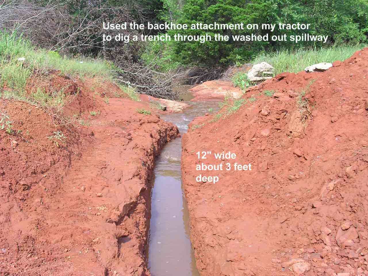

It took 38 years to build up to five feet in my pond. NRCS said it's drainage area was 958 acres.
The spillway was dug out 9/20/2009, to drain the pond.
