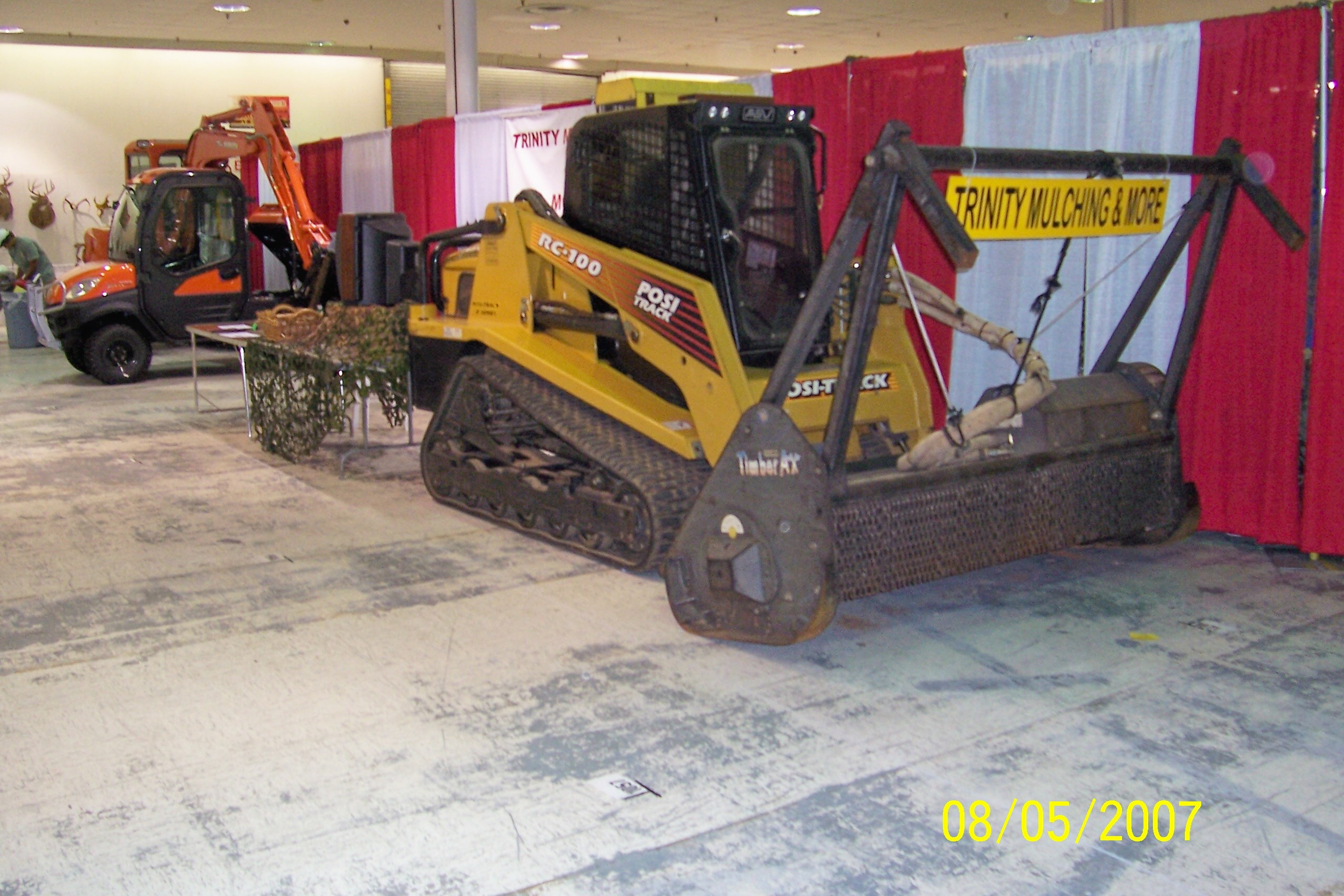

This is what I did to my pushbar. I cut the front bar at the sleeve, cut the back bar where the arch attached. Bolt the swing arms onto the back bar, riase them up and put the two together. You will need to cut the round bar from the top sectionand reuse. This made it extremely strong, and shaved atleast 50 lbs. off. But made a extreme difference because it took the weight off at the highest point. Also made it where you could really control trees and keep them inline with the head for mulching.
