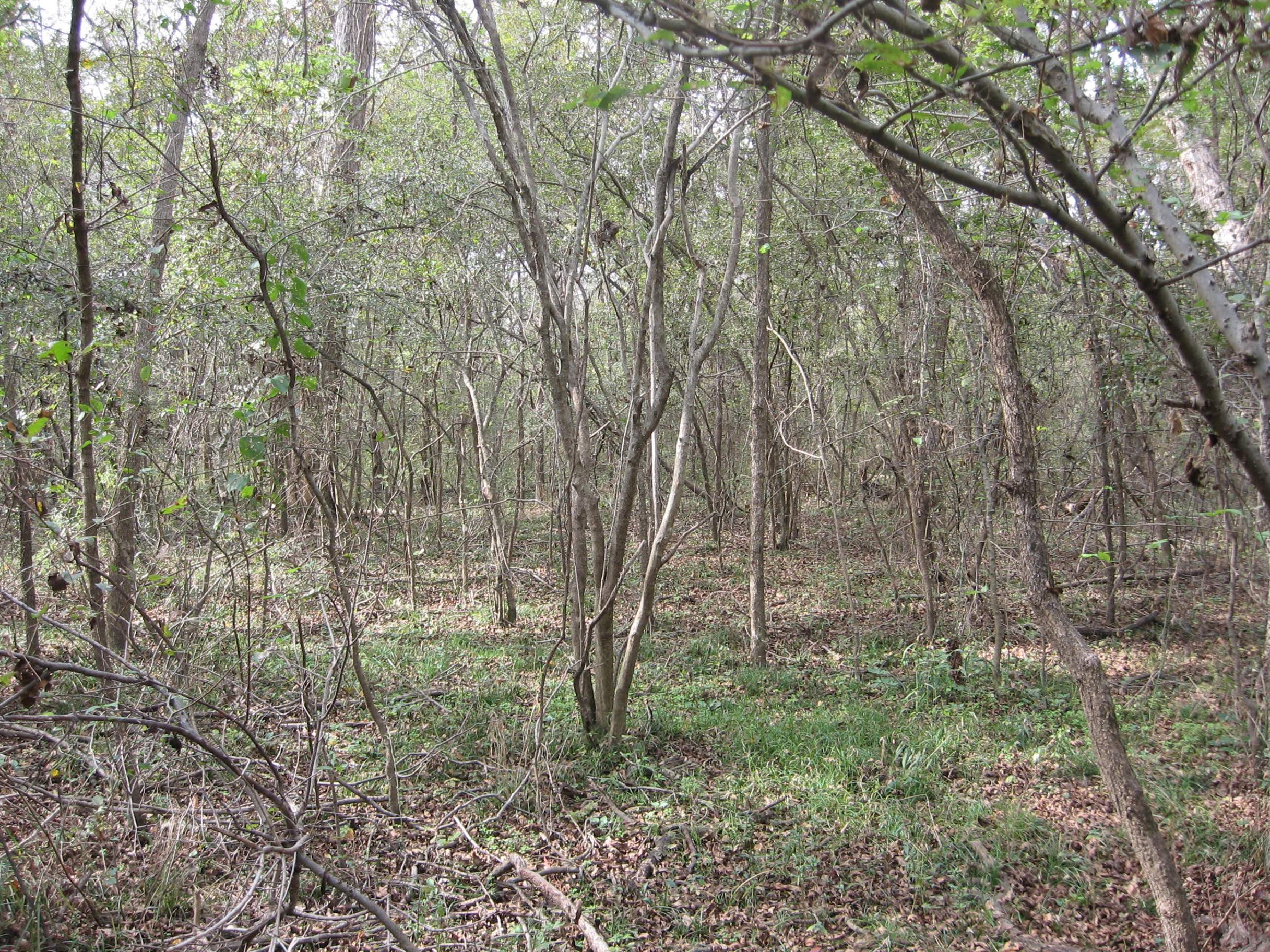

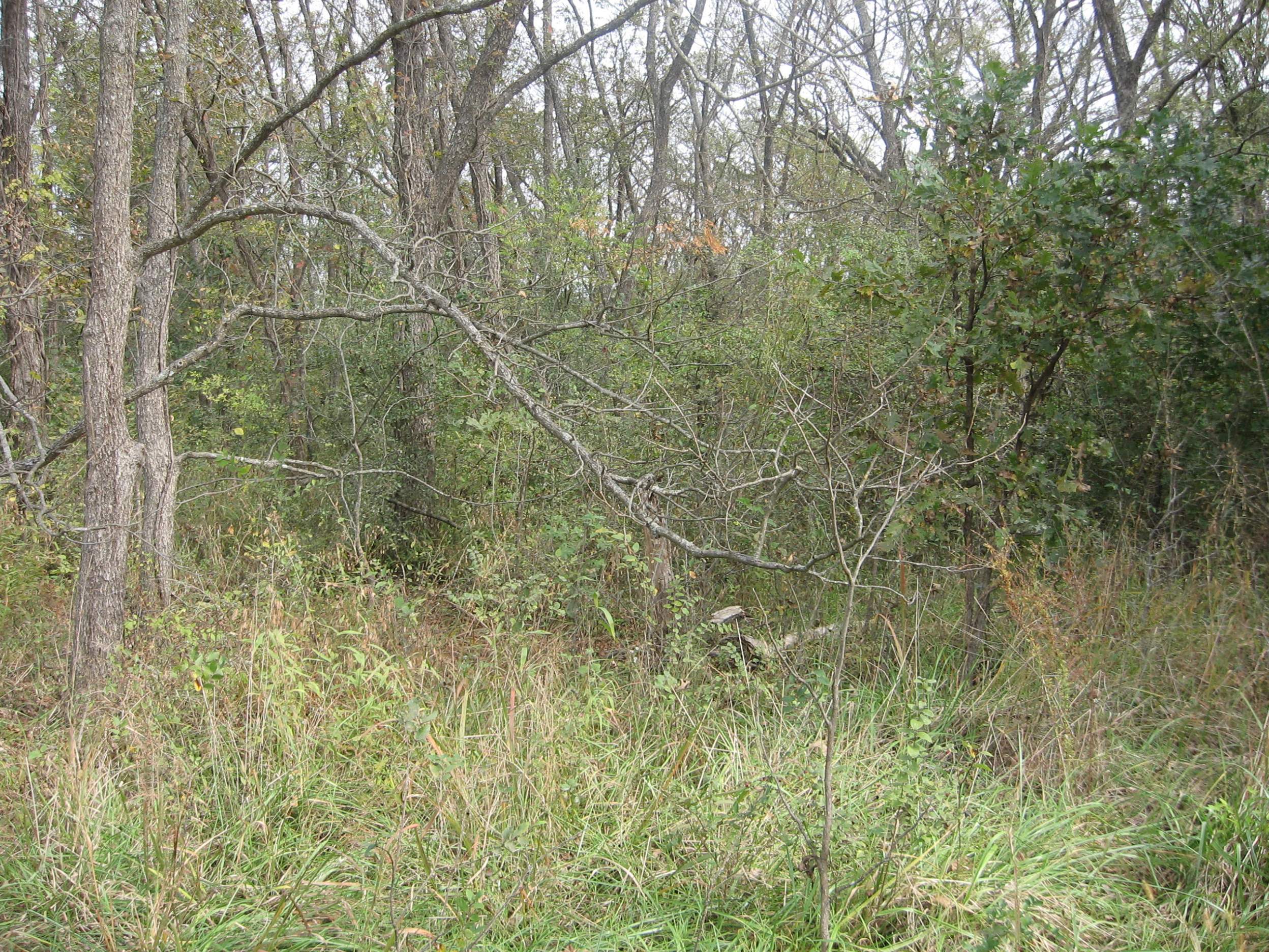

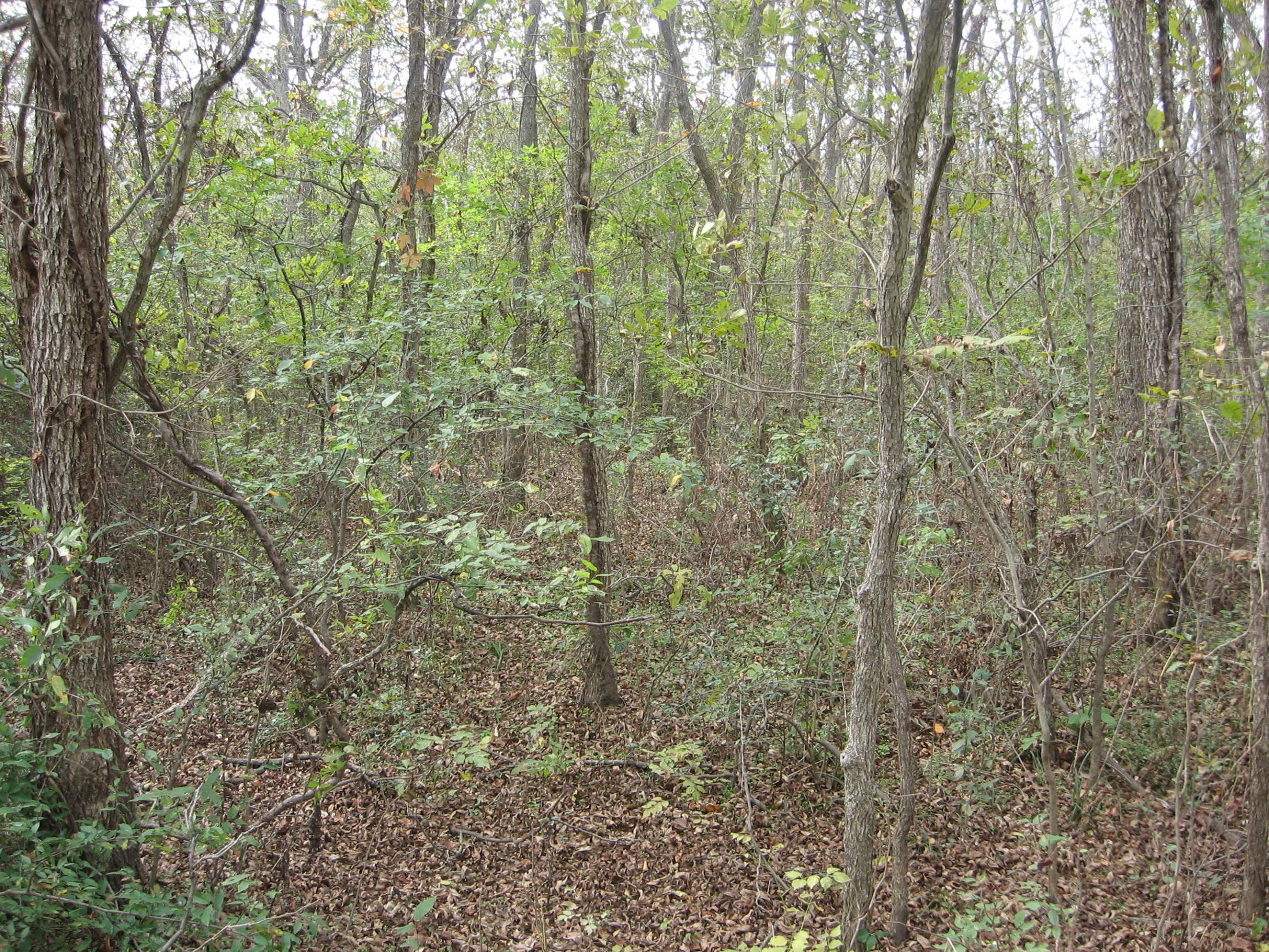

Still more info: a creek divides my place and I have two different situations depending on side. One side (20-30 acres) is like the last two pictures from before and the last one attached here. It just needs the 25 years growth cleared from among the mature trees. I can do this at a fair clip with my equipment but it would still take a few years working many weekends. It seems to be a perfect candidate for mulching.
The other side is like the first three pictures here. There are very few valuable trees, but the brush is much thicker and the seedlings bigger because there there was nothing blocking the sun from it the past 25 years. It is a variety of trees from 4 to 14 inches in diameter and 20' to 40' tall/skinny which I would prefer to have very little if any of it left. This seems to be a better candidate for dozing, but would still leave a huge mess and some work when done. The ground is soft in most areas for most of the year.
I will be having a pond built and some dirt work done with a dozer next August, so I am thinking about having him totally clear a few acres then, but having some of the underbrush in other areas mulched sooner.
Still undecided, but getting much closer.

I would like to say that any good dozer operator using a rake will not push tons of dirt into a pile. I believe something like a 924 cat articulating loader with a rake on the front would make easy and fast work out of your stuff, as long as the groung is dry enough. I personally prefer to get stumps roots and all with a dozer,or articulating loader. I find if stumps have any size and are ground to surface level that in a few years you have holes everywhere in your fields from rotting stumps. If I tear it all out from the start I can disc and level and have a good fieldbed from the start. If stumps are small probably would not be a big deal. Also you will have your spraying cost on top of machine time to clean land. Just another perspective not necessarily right...
