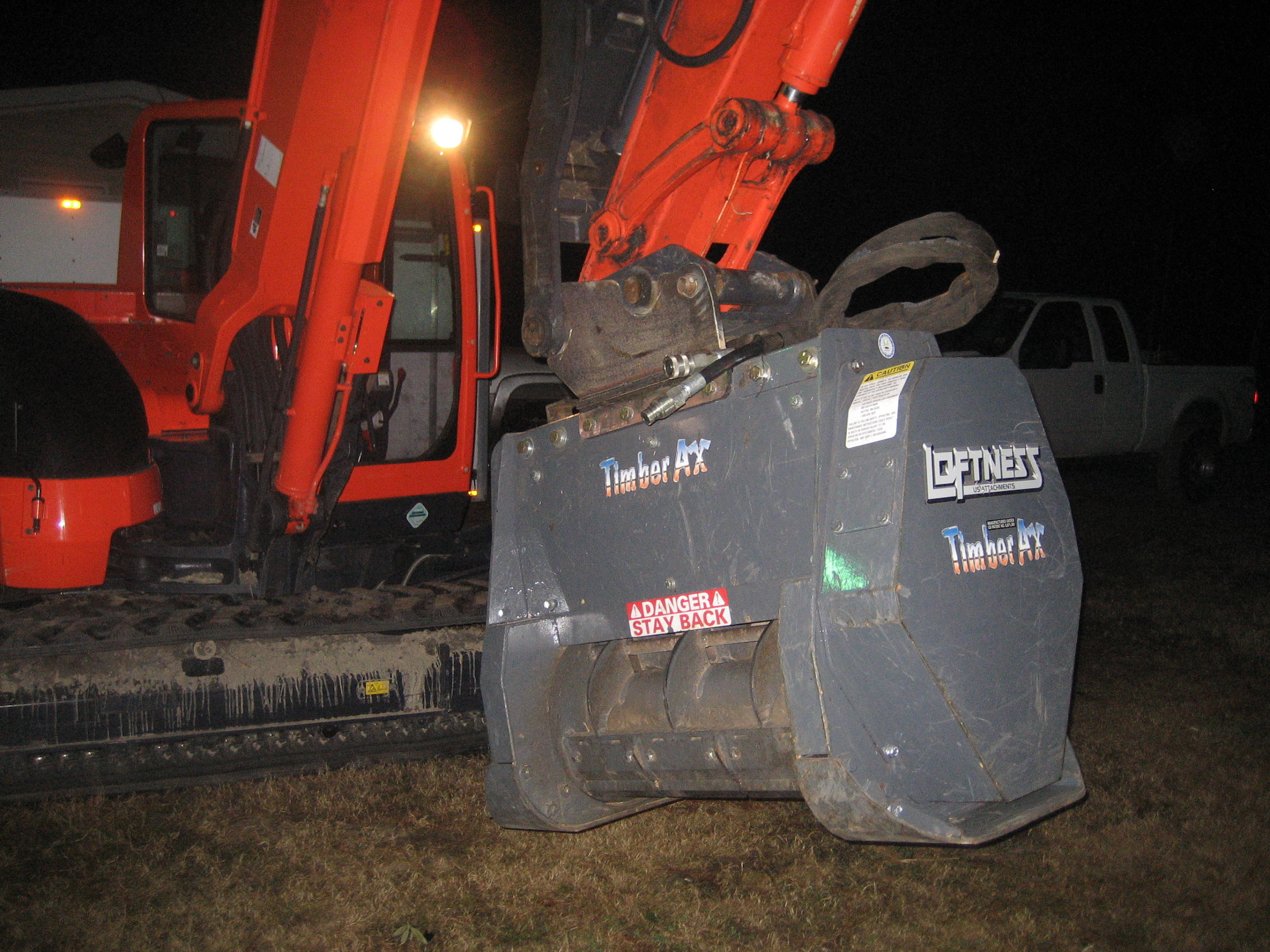

But today, I had the oportunity to run a prototype Loftness Timber Axe made for the Excavator. WOW.......
This thing is easily productive in 5" and smaller material and can cut anything you put it in. We cut 9" pine and a 12" oak today. Also, we cut several huricane blowover trees in the 10"-14" range that were in the way.
It is a prototype, and weighs too much to use everyday on the Kubota (1600 lbs) but it was intended for a JD160. Another is being developed now for the mini's, but I will keep running this one until I destroy it or have to send it back.

OK, Here is a picture of the AXE and the bracket we made to mount it. This is the first night that we had it at the shop.

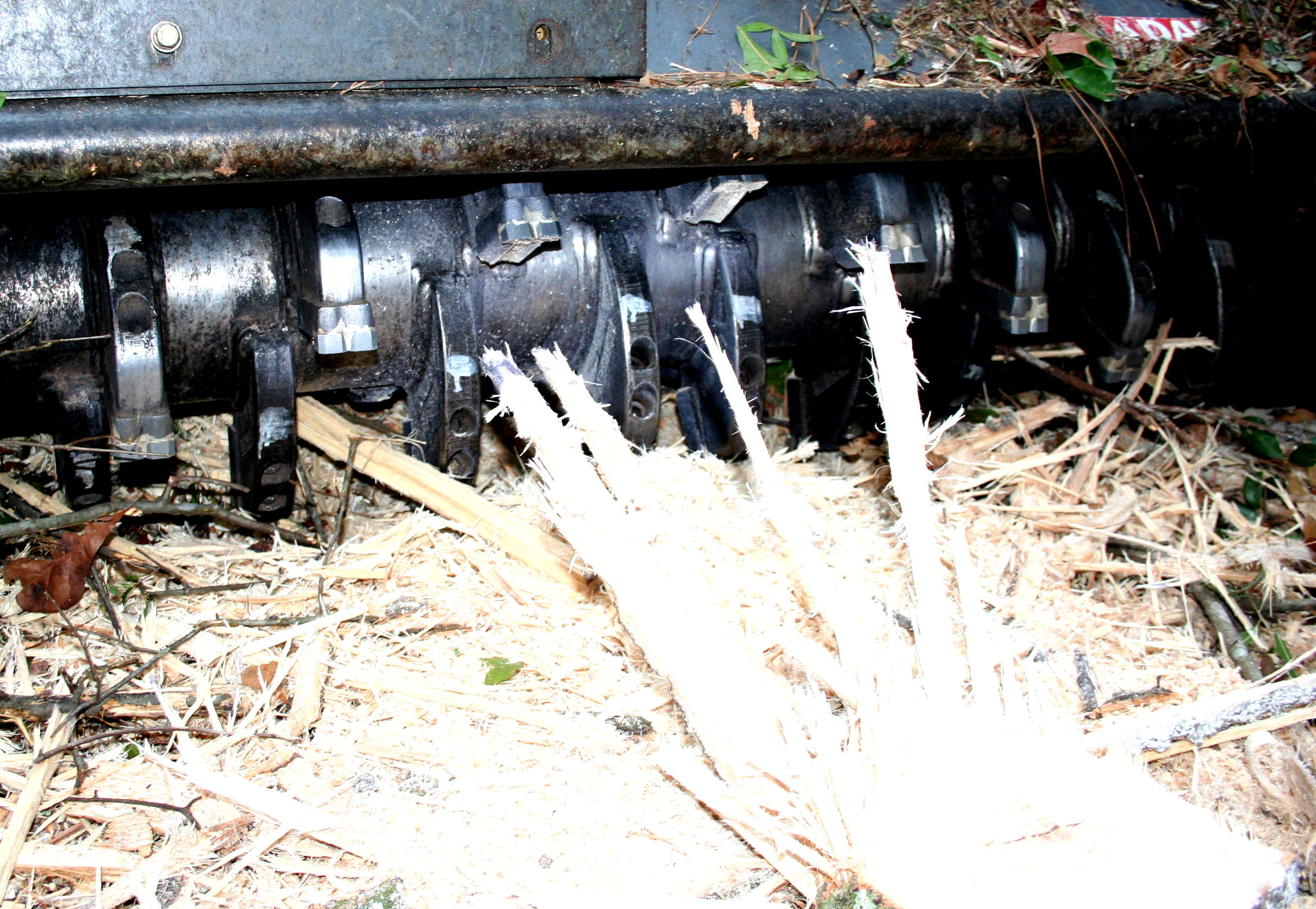

Also, I just put the new Planar carbide teeth on my G1 head yesterday and WOW!!! If you run a Loftness, and don't have any rock in your area- They seem to be worth the money.

Once you get in tune with the Axe, it looks like a chain saw cut it, if you want it to. It can do fast rough cuts, or you can make it fine. The Axe will cut in both directions, but it cuts differently depending on the purpose of the cut. It is open on the right side, to allow for larger material that is standing. It has two rows of knives. They spin to the right. The downward direction of cut when swinging to the right allows for quick cuts.
Where it shines is when you cut the material to the right, and then swing left. The knives pick up the material and hold it against the shear bar. Smaller material gets sucked through, and it looks like you out it through a chipper. Larger material gets picked up and chewed on, processing it down until it goes through. Big trees, you are milling, taking 3-4" per pass. Looks like you ran it through a planer. Then just move back and do it again. There is no limit to what size material you can cut except for time.

Bill @ Loftness is taking my input and rebuilding a lighter version for the small Excv. Estimates are around 1000lbs instead of 1600. It is so heavy now to allow it to be used as a foot for a much heavier machine. Aslo, there is a bolt on section in the back that is to be used by the customer to put on a thumb saddle (so that it can match your machine).
The thumb is actually more useful for grabbing vines and broken off limbs, and pulling them down to the ground for mulching. You can use it for shoveling pretty big material close to the ground, but lifting large material high is a little too much. We braced our rockhound thumb saddle with 3/4" through bolts to give it side to side strength.
As far as recovery time and width of cut- The protype is 36" and the smaller version will more than likely be 30" wide. That is plenty for this size machine. Recovery is usually within 2-3 seconds from a full stall. I will say this also. You can not hear the head inside of the machine, so you don't know that is has stalled. When the chips stop flying, move. They are working on a remote mounted LED gauge with green, yellow and red indicators that will either mount inside of the cab or on the boom, so you can tell the RPMs of the head.
I think I answered all of those.... Keep firing.
