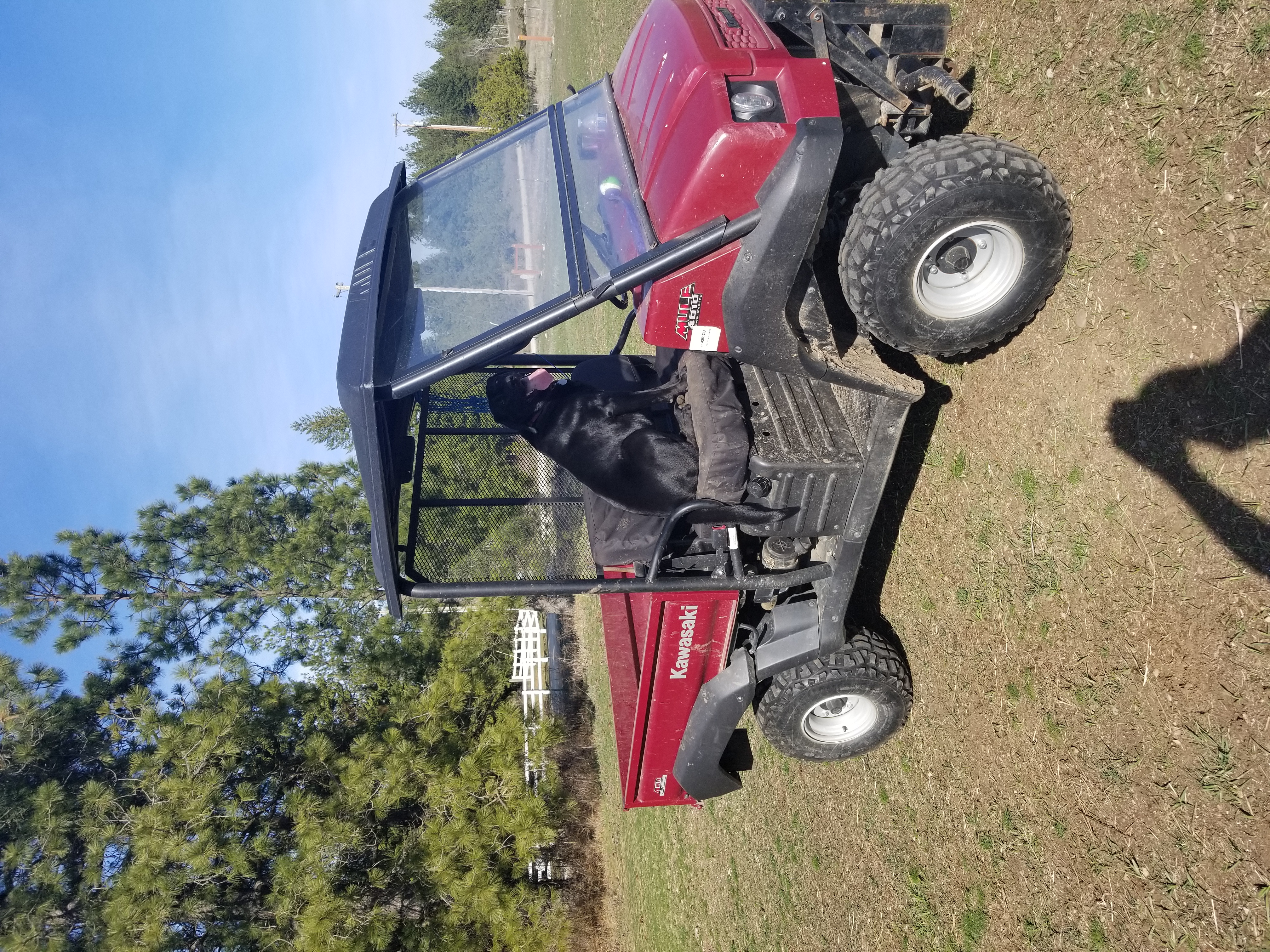

D8984890-DEC7-412C-B914-B5ACA3D17405.jpegWho the heck wants to sit 3 abreast......... my only passenger is my dog
   / MULE 2510. What can make a vehicle so USELESS in the Snow?
#22
I couldn't agree more. Maybe people don't realize, I'm talking about being able to stick your legs out the front on the passenger side as that side doesn't have a dash.
