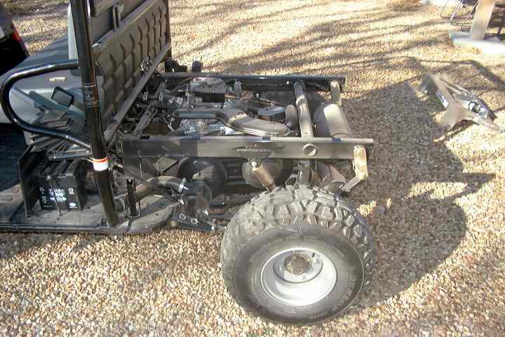

First we removed the Mule's bed. It has a wiring harness for the tail lights and two pins for the bed pivot points. We set the bed aside, out of the way.

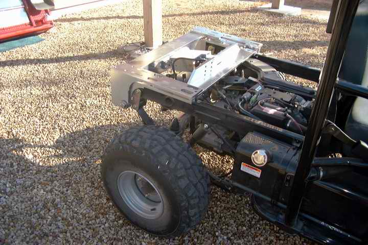

The Power-Hoist assembly sits directly on top of the Mule's frame and is slid forward until two stop pins contact the frame.

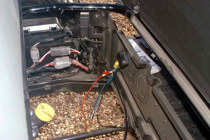

The operating relay mounts underneath the Mule's seat. There is no hole to drill (it's already there) and the hardware includes a screw and aircraft locking nut. After the harness is attached, the red and black wires attach to the battery terminals. All connectors are pre-installed for an easy job.

The control swithch mounts close to the operator's seatbelt and then the lift assembly cable is routed and connected to the wiring harness. Detailed instuctions on routing and cable ties are provided for this step.

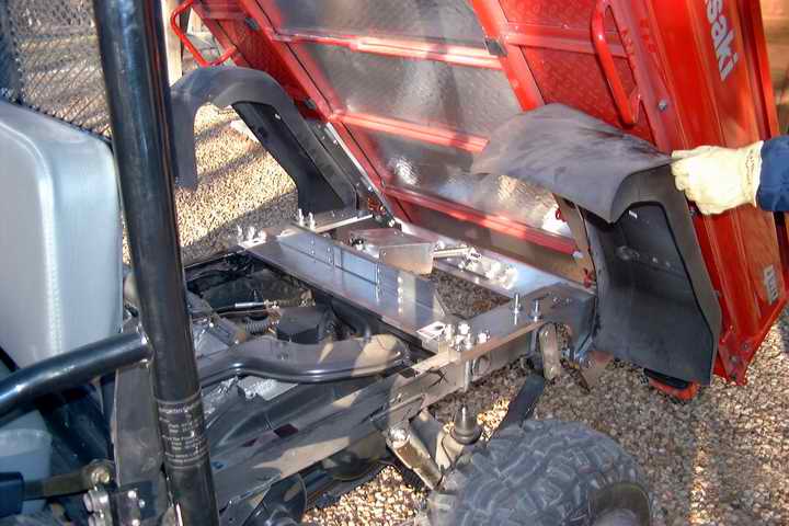

It's now time to reinstall the bed. The pins that were removed to take the bed off are used to attach the bed to the Power-Hoist. You have to grind one side of the pins flat so they will fit, but there are detailed instructions on how to do this.

After attaching the bed with the pins, you have to drill two 1/2" diameter holes into the bed for the front mounting of the lift arms (see yellow circle in attachment). After the holes are drilled, a 1/2" carriage bolt is placed through the lift arm and a white nylon spacer installed. Only one of these is visible in the photo.
To complete installation, spacers are added to the Mule's frame so they will hit the bed's pads when the bed is lowered. See the blue circles in the attachment.
Finally, the taillights are reconnected to the Mule's wiring harness.

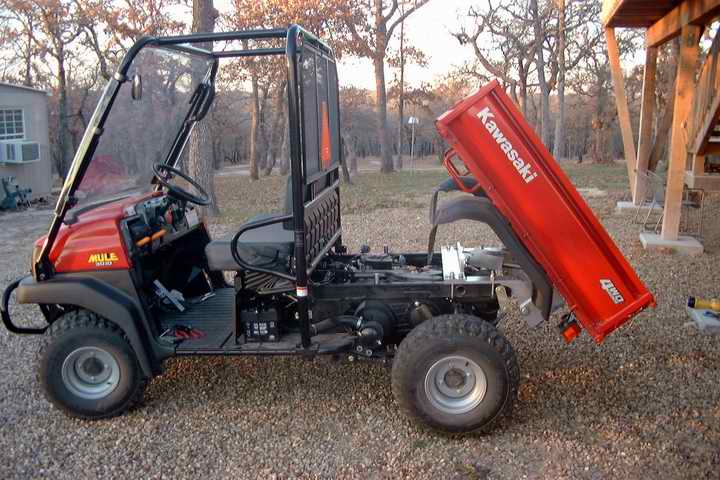

Finally, the job is done and it's time to back off and look at the finished product. /forums/images/graemlins/cool.gif /forums/images/graemlins/smile.gif
This product was a pleasure to install and the only way I can describe the way it works is "WOW!". The entire bed is raised 1-1/2 inches and this will allow larger diameter rear tires if you want them. The lift capacity of the Power-Hoist is 1,200 lb, and that's above the rated capacity of the gasoline Mule.
Also, notice the mirror installed on the windshield. This is a perfect addition if you drive on any street or county road.
