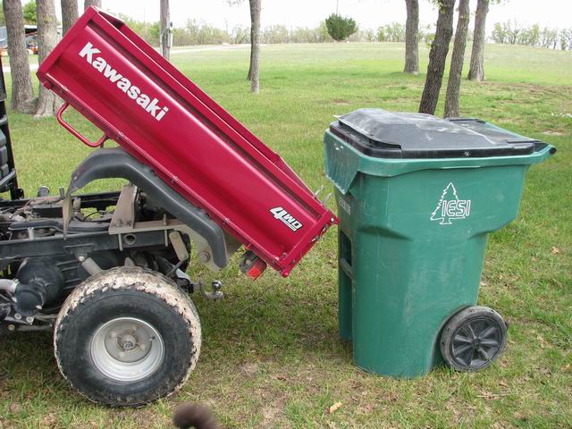

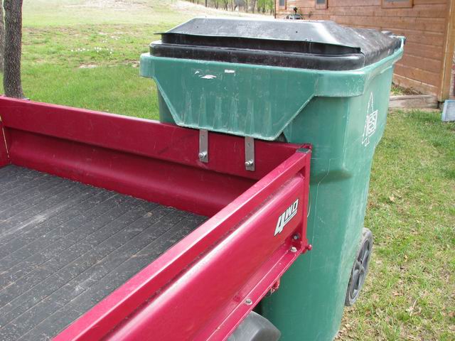

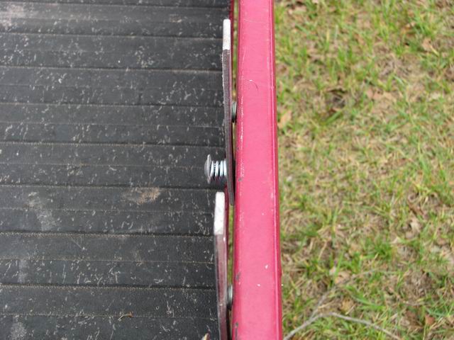

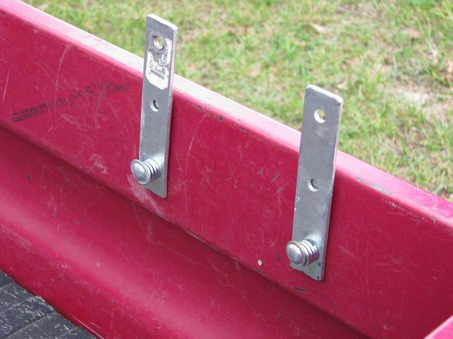

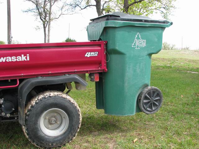

That's what I call my contraption I built for the bed on our Kawasaki Mule. It's shown in the pictures below. Does anyone want to venture a guess what these "Mule Ears" are used for? I'm going to start a little guessing game by showing pictures of my ears without showing what they are for. After a few guesses or if someone guesses correctly, I'll show the ears in use. I can assure you that these are an extremely handy and labor saving device. That's the first clue. The second clue is that they get used twice a week. What are they for?

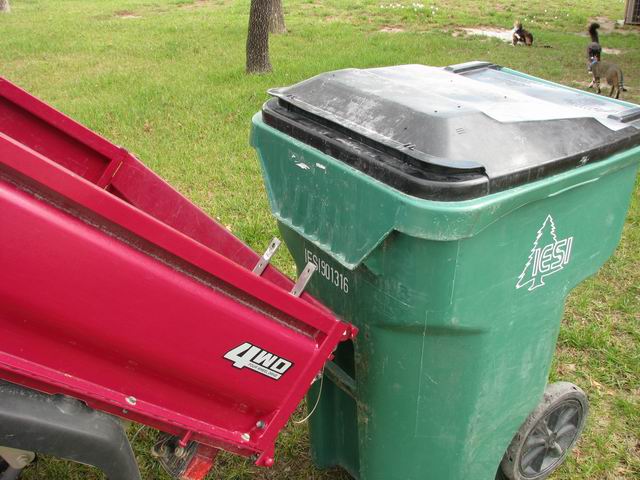

Okay, I guess I made it too easy with my clues. :eek: Both of you got it right on the first guess.:D Here's "the rest of the story...."

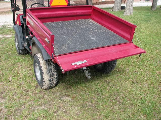

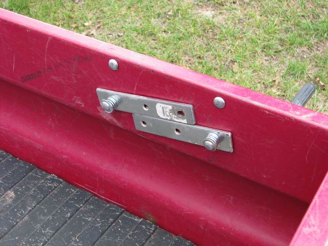

The holes in the aluminum barstock against the carrriage bolt heads make a very good indent to hold the ears while hooking the garbage can. Also, the springs let the ears flex without bending if I get too close to the can before raising the bed to hook up. Sometimes simple works the best. This is easy to use and folds away easily. I think it took me all of 20 minutes to do once I decided how to do it.:cool:

The rest of my story is I've thought about something very similar for my FEL bucket. Good to see your design in action Jim. Any worrries about bending your tailgate?
Rob, the tailgate is really tough and there's no worry at all about bending. If I did not have a hydraulic bedlift, I might have a hard time getting the bed down if the garbage can was stuffed and weighed over 250 lb. I don't think I've ever seen it that full of anything approaching that weight. Anyhow, the ears" on the inside of the tailgate cause the trashcan lip to actually sit on top of the tailgate. most of the weight is straight down rather than twisting. even so, i'd bet those 1/4" bolts would shear off before the tailgate bends. What I didn't show is that I've got some 3/4" diameter washers under the nuts on the back side of the carriage bolts. That spreads any load over a large area. I guess if you have a plastic bed and/or tailgate, you'd want to be cautious, but I don't think I'll ever come close to bending the gate.
Billbill: I never thought of using a pipe because one of my first thoughts was that I wanted to be able to fold this down out of the way and take away the temptation for someone to use it as a handle. The Mule bed has a lip on each side that makes an easy job of hooking bungee cords or any S-hook under that lip. I've never been in a situation where I was short of tie-down points. The round heads on the carriage bolts and the rounded edges I made on the aluminum stock should prevent any scratching or snag points for clothes. At least that's my hope. :)
