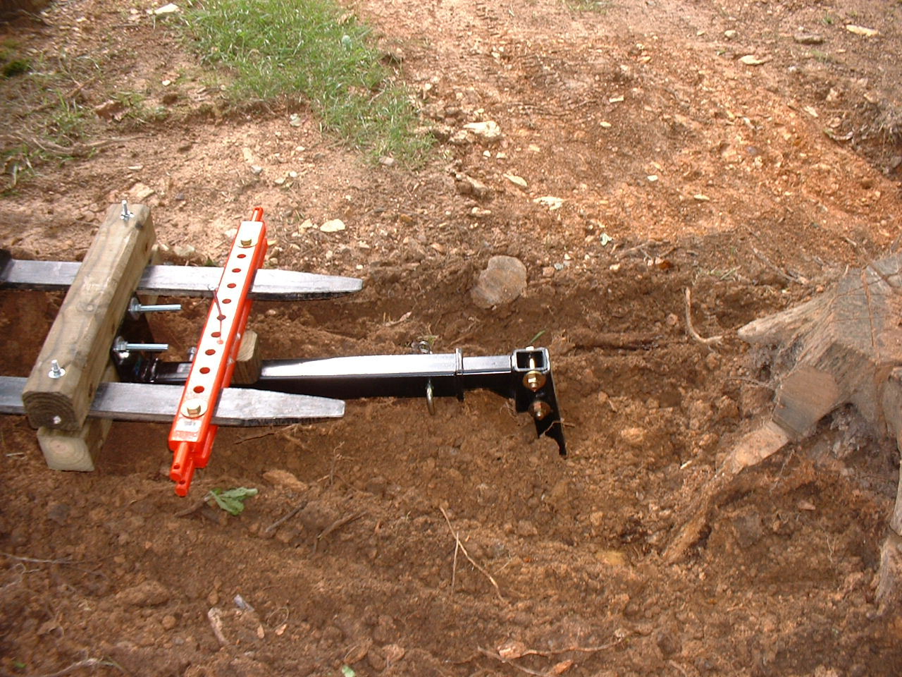

I added another attachment that seems pretty handy. I used a shorter tube this time and made a trench maker/cleaner to go with my ripper attachment.
For now, I am still using the forks as a base for testing these. I decided to go ahead and just dig up this stump by the driveway. I'm real tired of looking at it. A few pictures of the work, and trencher. First one of the trencher/digger.

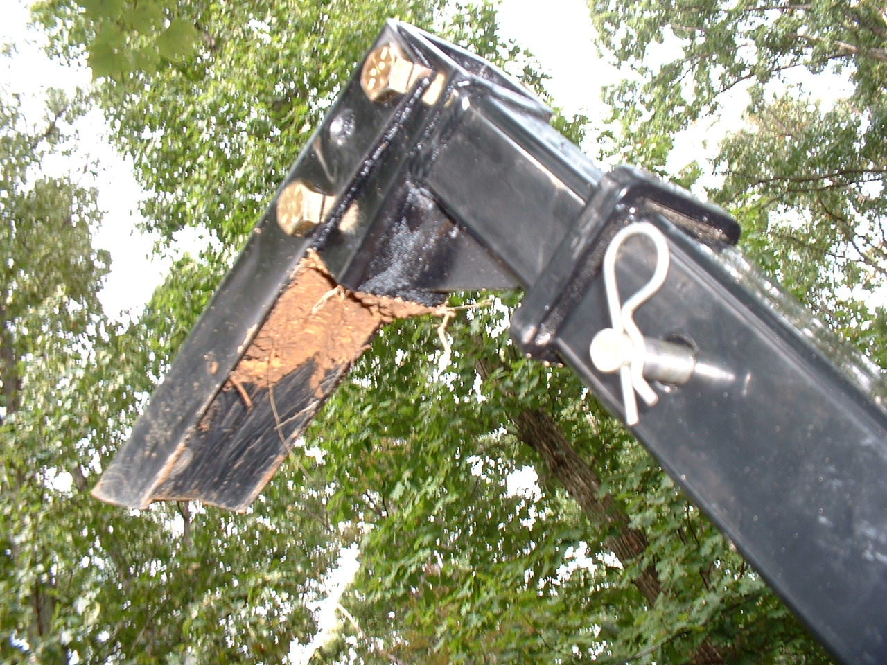

Another shot. I used # 8 grade bolts which seems to be over kill.

Digging around the stump.

Another.

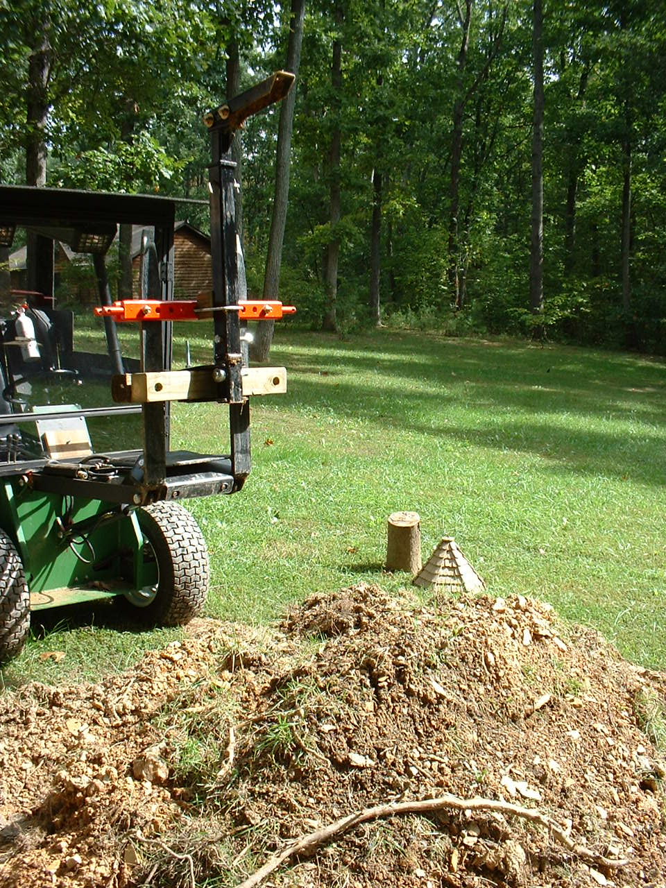

Last one of attachment and 24 inch tube. I also used this to dig a trench and bury some cable going to an outside yard light I made.
