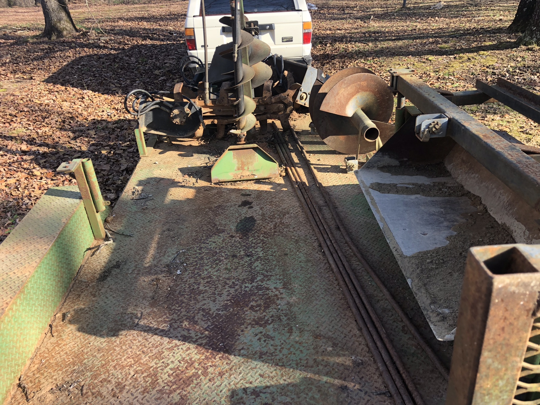

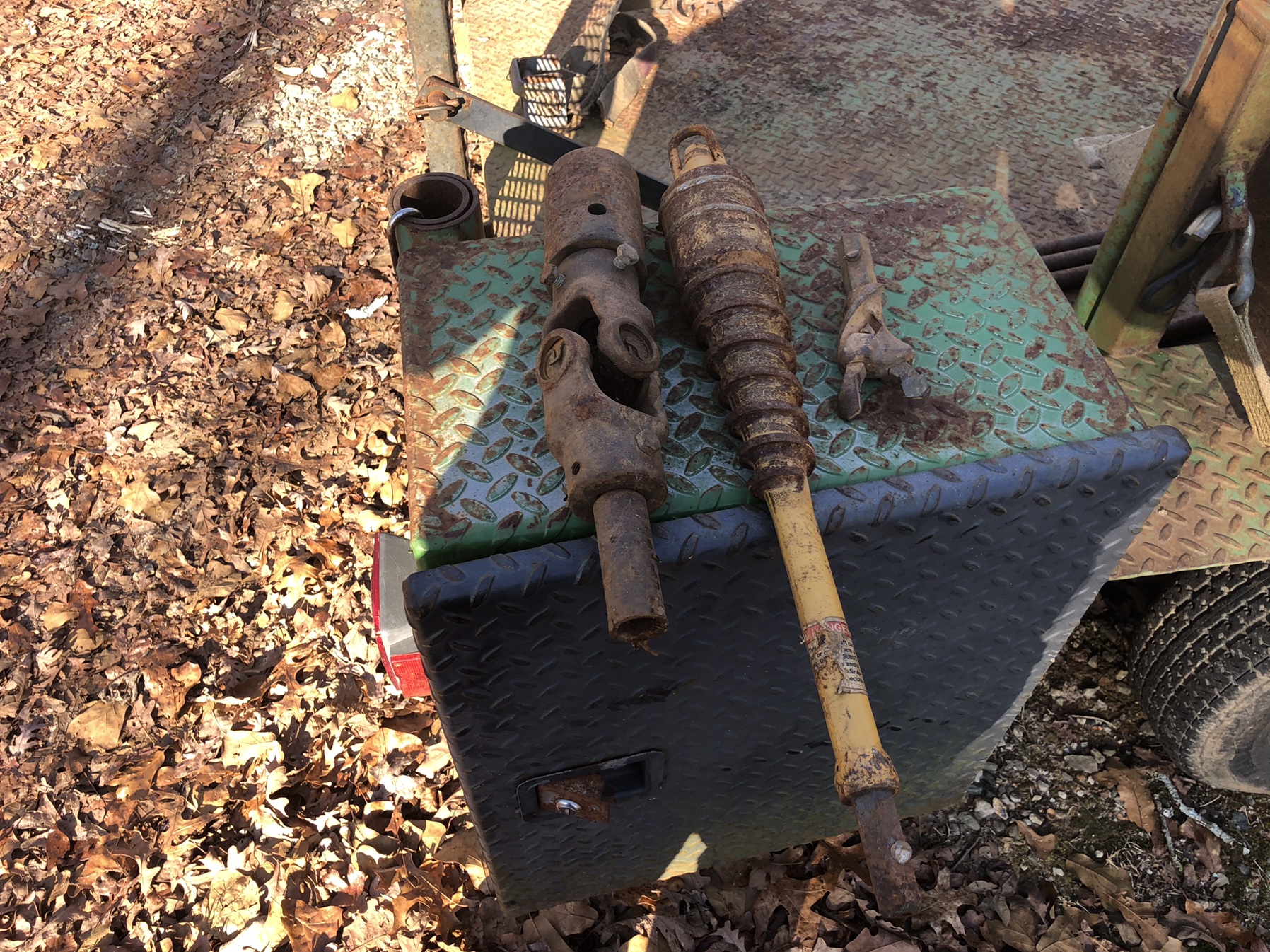

I have another capability with this unit that i was pleasantly surprised with and didn’t not see it listed on the PT. Website. It is a setup to do directional boring, to run any type of line up to 3 inch diameter under roadway, plumbing under slabs etc.... was another cool piece to my arsenal..... will send pics.

Congratulations on the directional borer! I would love to see a thread on it; I have always wanted one- for three locations for pipes on the ranch.
