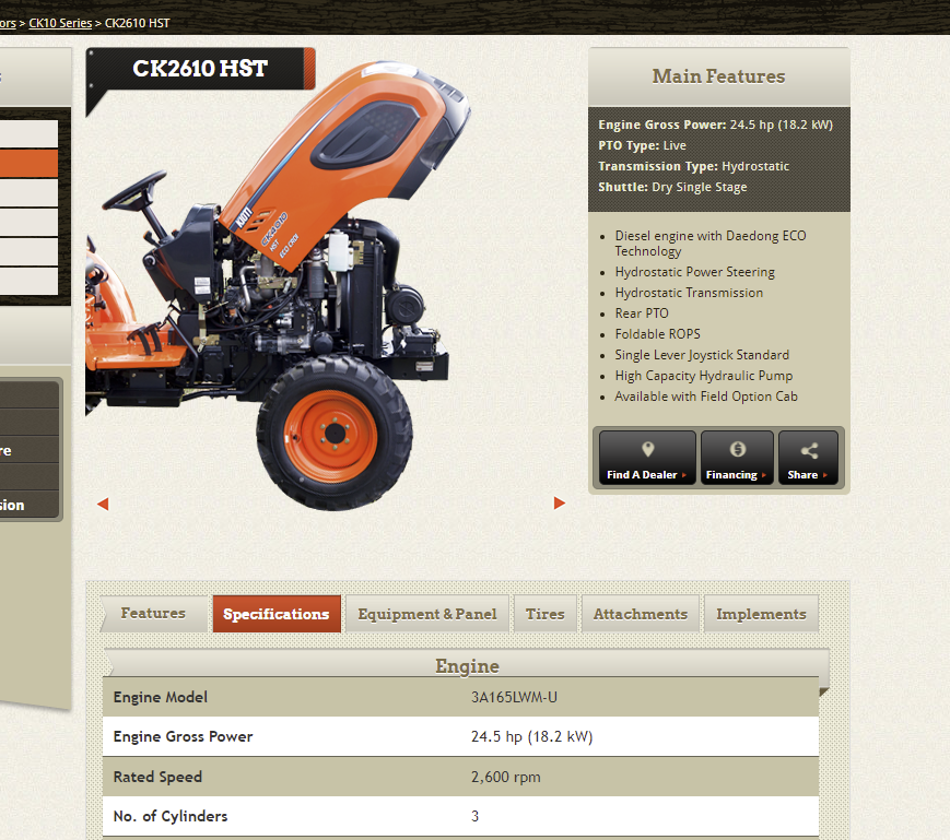

Hey all, I have seen many threads but no real conclusion.
Both the CX2510 and CK2610 have the same CC of 1600 the website claims but the CX has an 87CU engine and the CK2610 has a 105CU
I will start by the fact I am not mechanically included, own a massey GC and upgrading in spring, but looking at these, and cant understand the power difference here for the bigger tractor, ive also thought CC indicate the power, but the the bigger engine is obviously different?
CK2610
Engine Model3H-TM4B
Engine Gross Power24.5 hp (18.3 kW)
Rated Speed2,600 rpm
No. of Cylinders3
Fuel TypeDiesel
Displacement100.5 cu. in. (1,647 cc)
Fuel Tank Capacity9 gal. (34 L)
CX2510
Engine Model3A165LWH-U3
Engine Gross Power24.5 hp (18.2 kW)
No. of Cylinders3
Fuel TypeDiesel
AspirationNatural
Displacement87 cu. in (1,647 cc)
Fuel Tank Capacity6.6 gal. (25L)
87cu. is *not* 1647cc, so its a misprint, simple as that.. The smaller engine will have its PTO (and torque) RPM higher than the bigger engine.

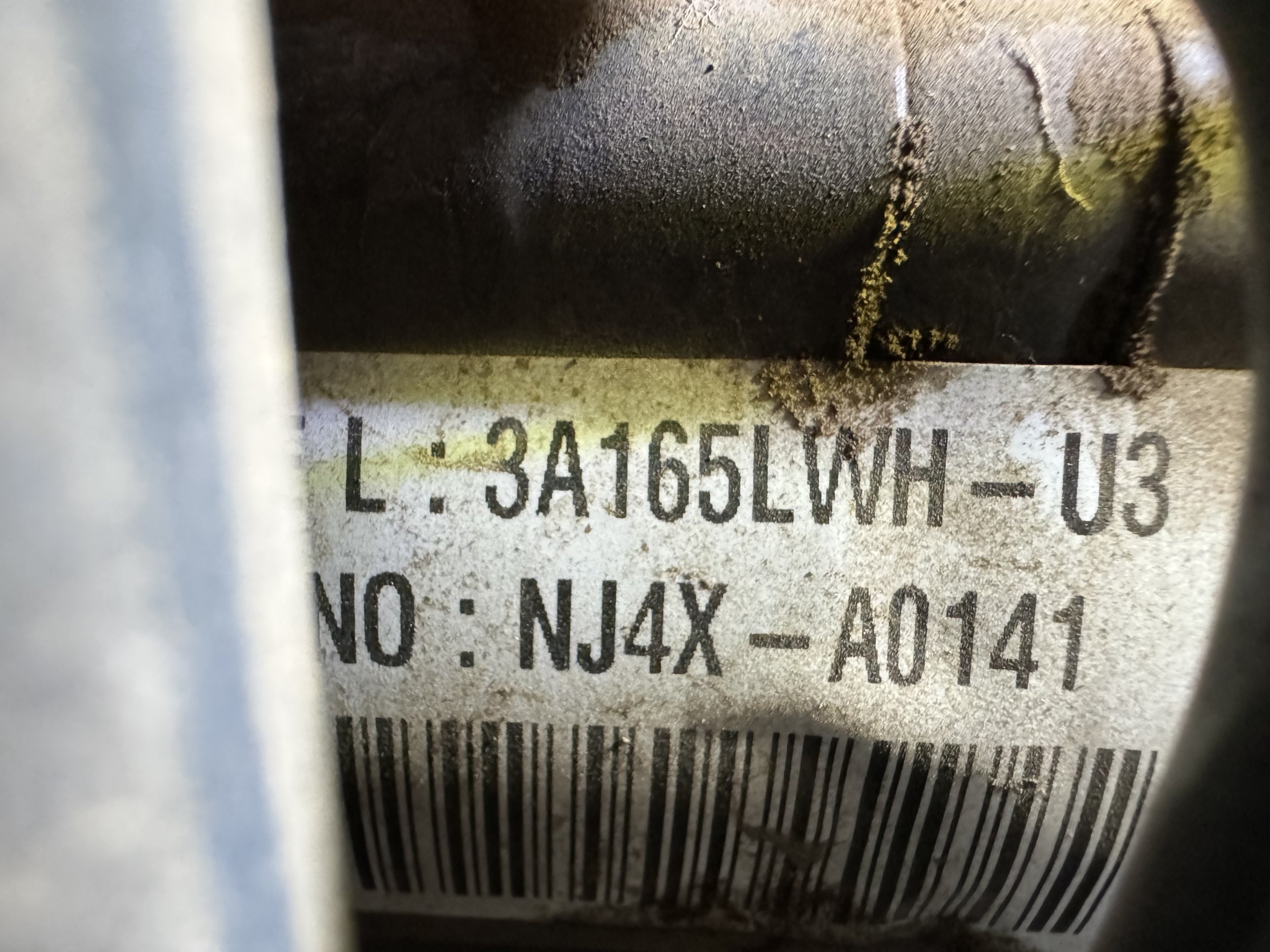

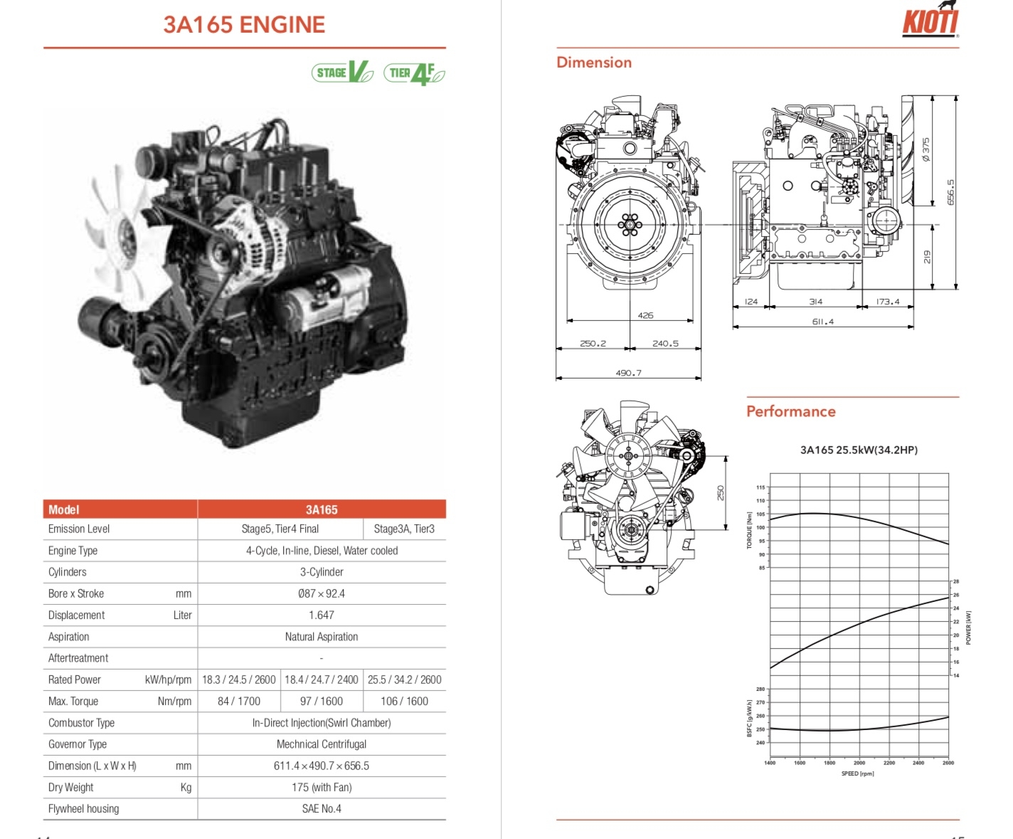

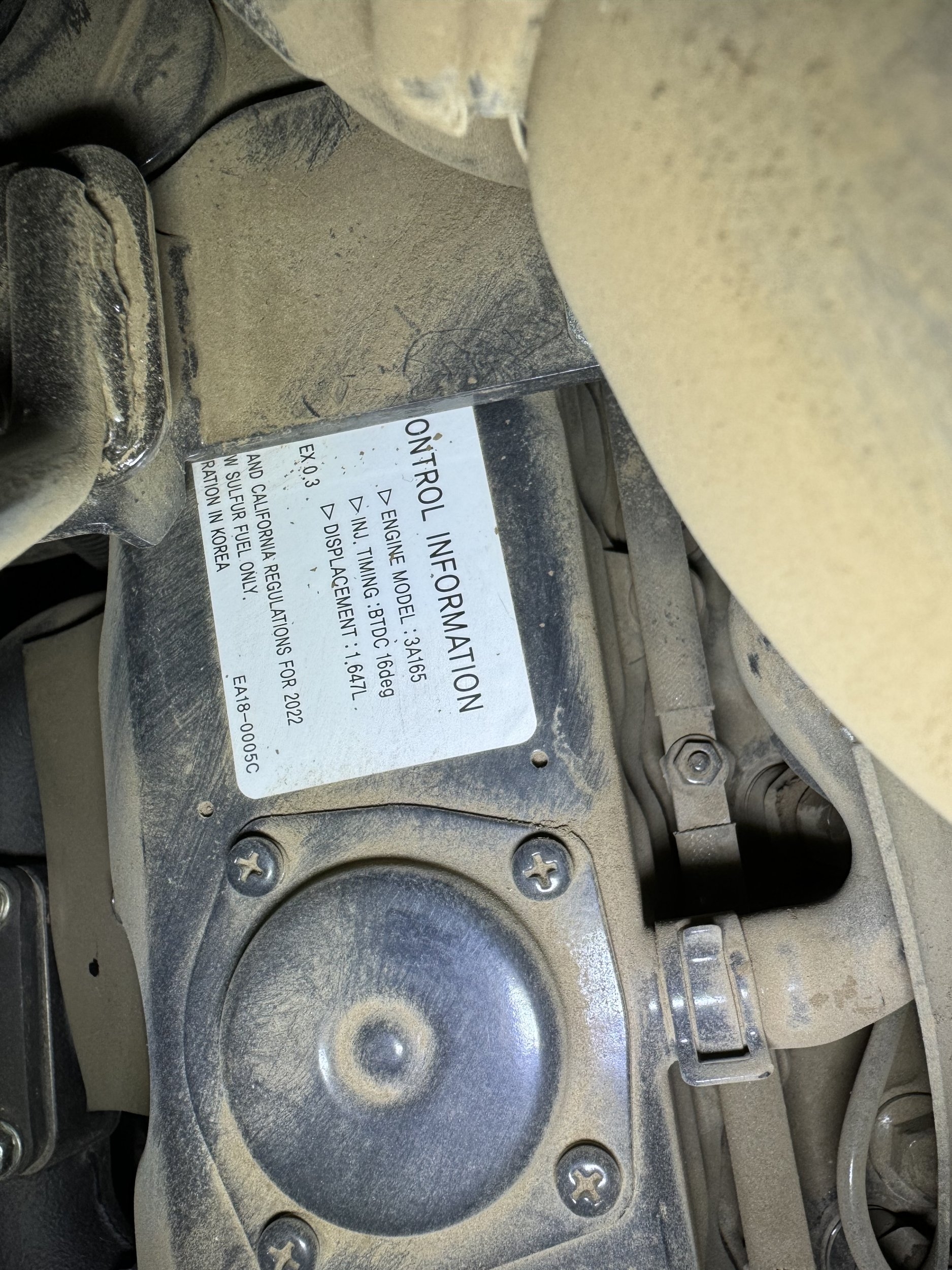

I’ll help answer the question. CK2610, CK2620, and CX2510 have the same 3A165 engine. There was an older tier 3 emissions compliant version in the CK35 that made 34 horsepower. People tune the fuel mixture screw and pump timing to 18 degrees to “match” the 34 horsepower configuration.
The photos are from my CX2510 and the Daedong Kioti diesel engine series brochure which confirm the above statements.
