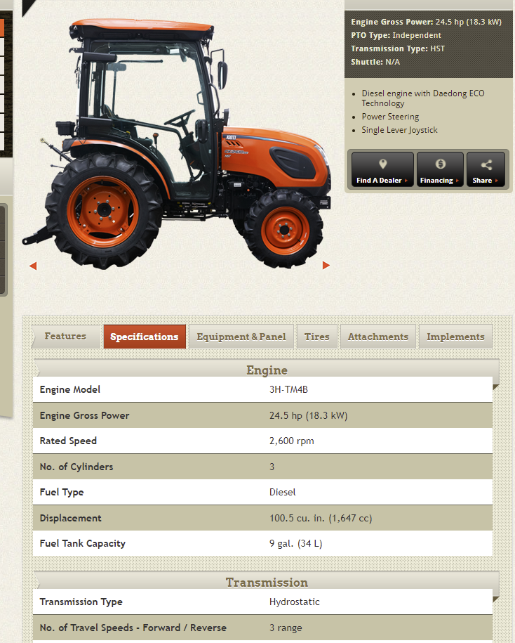

Hey all, I have seen many threads but no real conclusion.
Both the CX2510 and CK2610 have the same CC of 1600 the website claims but the CX has an 87CU engine and the CK2610 has a 105CU
I will start by the fact I am not mechanically included, own a massey GC and upgrading in spring, but looking at these, and cant understand the power difference here for the bigger tractor, ive also thought CC indicate the power, but the the bigger engine is obviously different?
CK2610
Engine Model3H-TM4B
Engine Gross Power24.5 hp (18.3 kW)
Rated Speed2,600 rpm
No. of Cylinders3
Fuel TypeDiesel
Displacement100.5 cu. in. (1,647 cc)
Fuel Tank Capacity9 gal. (34 L)
CX2510
Engine Model3A165LWH-U3
Engine Gross Power24.5 hp (18.2 kW)
No. of Cylinders3
Fuel TypeDiesel
AspirationNatural
Displacement87 cu. in (1,647 cc)
Fuel Tank Capacity6.6 gal. (25L)

1647 cc is about 100.5 cubic inches. 87 cubic inches works out to about 1426 cc. The engines are obviously not the same size and I suspect a typo on the spec sheet.
/ Multiple threads no clear answer CK/X2510 engine vs CK2610
Thanks, seems odd they havnt fixed that after all these years as the soon to be #3 tractor in the US but agreed does seem like a typo. I have seen alot of people mention being able to dial some screw to get more power out of the CK but never the CX and the engine model itself is different too.

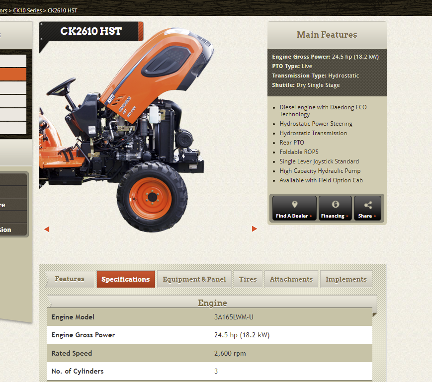

Where are you seeing the CK2610 having that engine? The Kioti website shows the CK2610 as having the 3A165LWM-U.
/ Multiple threads no clear answer CK/X2510 engine vs CK2610 #8
What's the link? Maybe a different engine in Canada?
#9
/ Multiple threads no clear answer CK/X2510 engine vs CK2610 #10
Ah, you're talking about the CK2610SE.

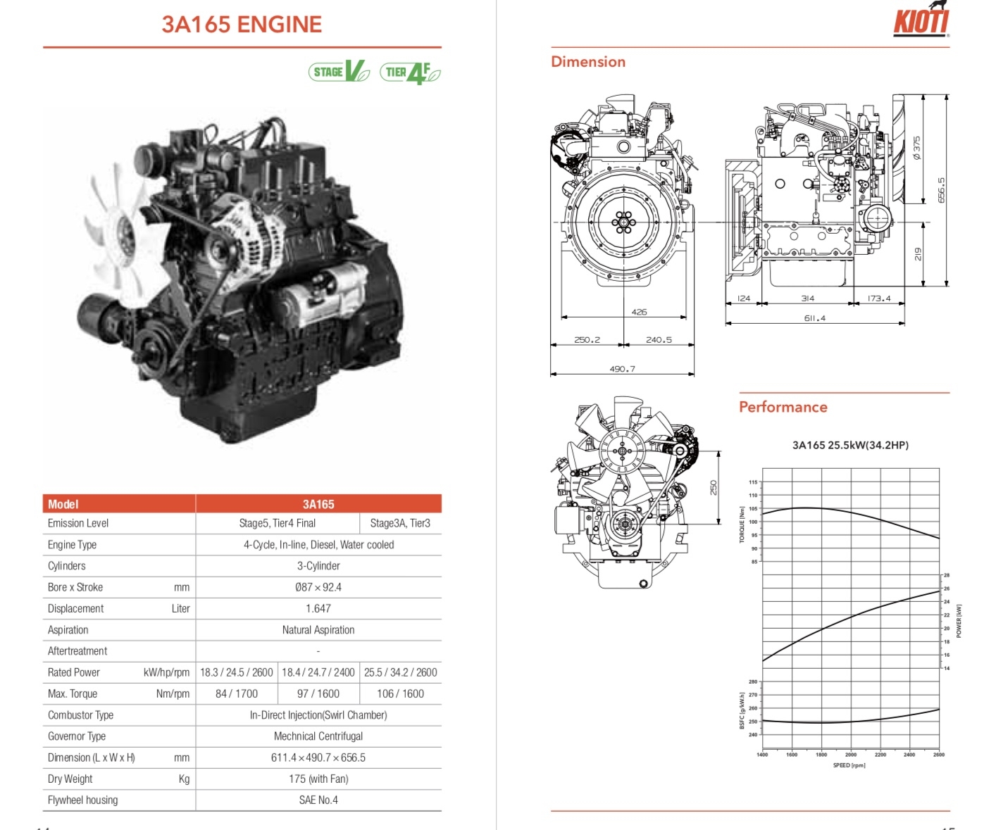

The cx2510 and ck2620 have the same engine according to the dealer site, there is a mistake listing the cubic inch vs cubic centimeter. Both are 1647 cc. Which is a 32-35 HP engine as far as I can tell. I have been interested to find if the cx can be turned up. Most 24.5hp tractors use 1000cc engines.
/ Multiple threads no clear answer CK/X2510 engine vs CK2610 #20

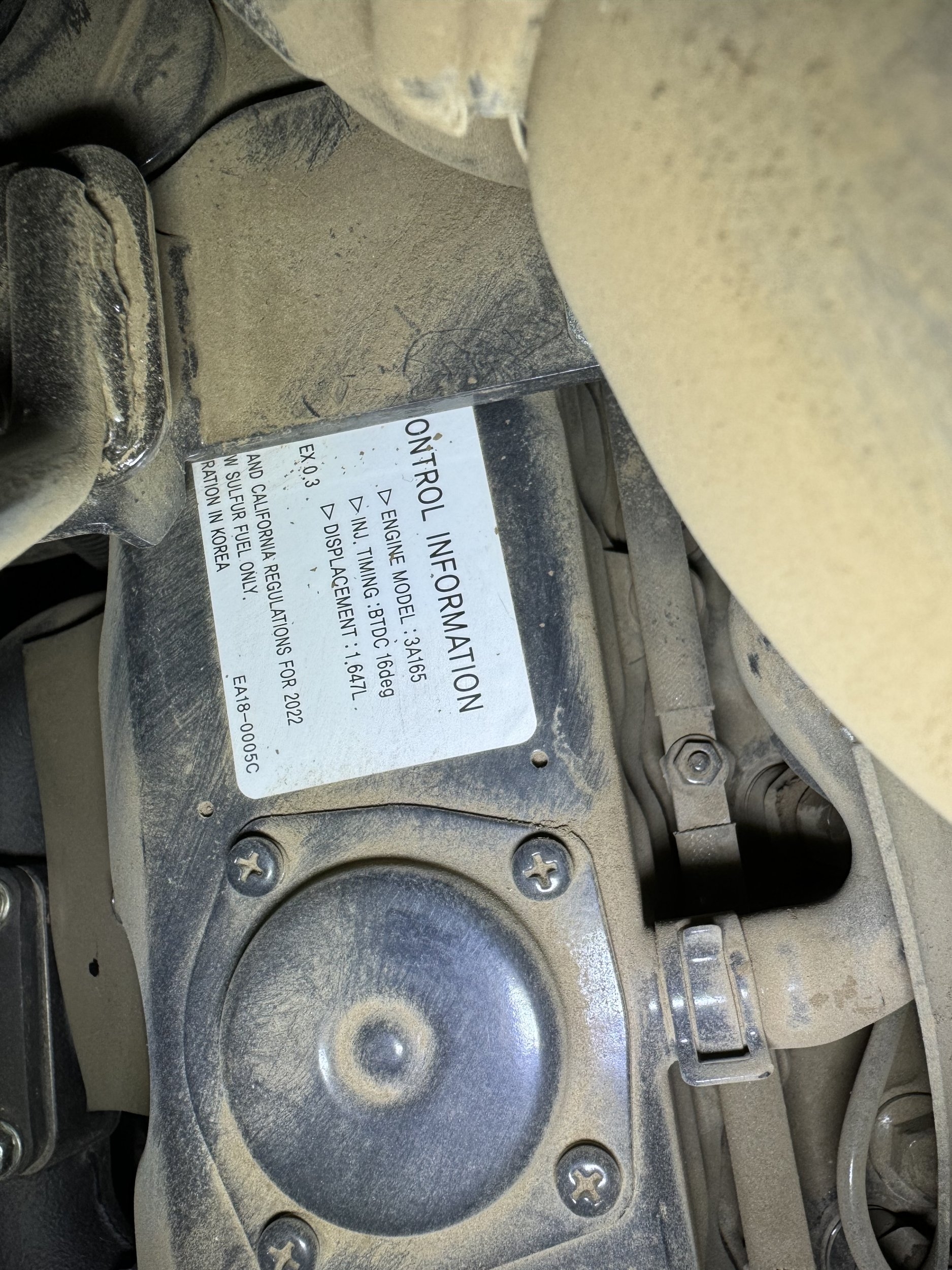

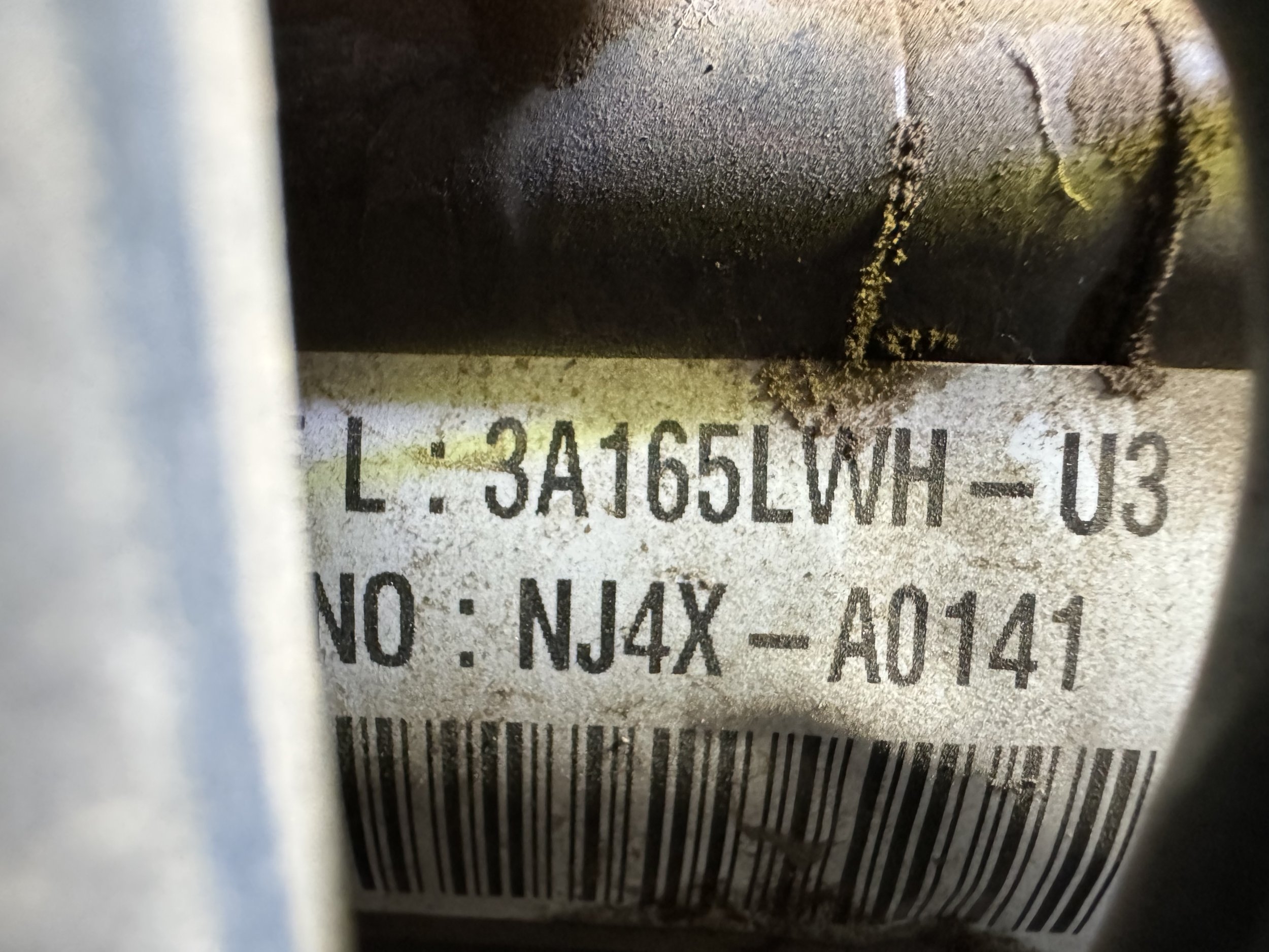

I’ll help answer the question. CK2610, CK2620, and CX2510 have the same 3A165 engine. There was an older tier 3 emissions compliant version in the CK35 that made 34 horsepower. People tune the fuel mixture screw and pump timing to 18 degrees to “match” the 34 horsepower configuration.
The photos are from my CX2510 and the Daedong Kioti diesel engine series brochure which confirm the above statements.
