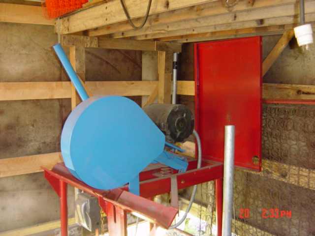

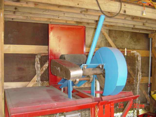

At one time I seriously thought about buying one of these, just because it would be faster to cut angles. But so far my Ellis is doing a fine job. So much so I removed my shop built chop saw from the shop and stored it in an out building.
