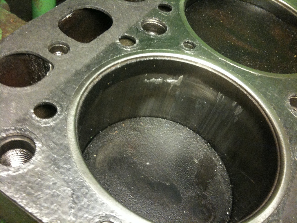

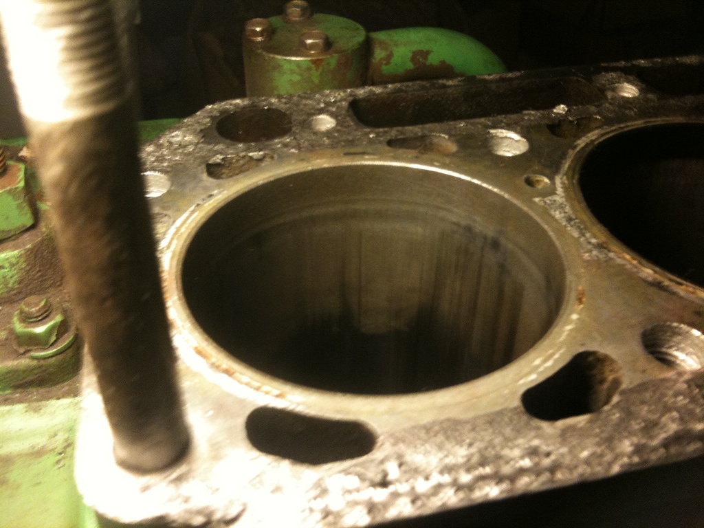

Did I introduce my new best friend? Muratic Acid!
$7.00 - Gallon of Muratic Acid from Lowe's.
$3.00 - Pair of plastic gloves.
It took about 30 minutes to remove all the aluminum buildup from the cylinder wall. I packed the cylinder with paper shop towels to protect the crankshaft from dripping acid. Then used paper towels to apply the acid to the build-ups. The aluminum immediately bubbled and turned black. After a few minutes, wipe and repeat. Once the buildups got down low, I used a razor blade to scrape off the black residue so the acid could penetrate better. All clean now :) !

Glad it worked for you... it actually looks pretty good. I've repaired quite a few chainsaws that had lean seizes and ruined a piston, but once the cylinder was cleaned up and a new piston and ring in place they were fine.
I'd be tempted to check the cylinders for out of round now. If they come up good, run a deglazer through them just enough to get a new surface for the rings to work against, check your end gaps, then slap the new piston and rings in 'er.
Before you deglaze, check the end gaps on a new ring. If it's close to the limit already, you may have to go very lightly with the deglazer.
I've used a piece of emery cloth and done it by hand in a pinch. Never had any problems.
You just might be lucky enough to get away with it...

I'm looking around for someone with a bore gauge, but no luck so far.
Out of curiosity, I did take one of the old compression rings, and checked the end gap....Tech manual says new rings should be (.025 ish) and max is (.060) the old ring measured around .035. Doesn't tell me if the cylinder is egg shaped, but I thought it was good news nonetheless.
I don't want to jinx myself, but everything except the piston skirt has looked suprisingly good. Rod bearing, cylinder wall has no scoring, wrist pin slid right out and measured within limits (I'll still use the new one, though), wrist pin bushing measured OK with no scarring, valves etc.
Parts will be here this week, so this weekend I'll deglaze all cylinders and replace the one piston and all the rings. I'm impressed with your emery cloth technique....now that's skill :) If anybody's looking to buy a Flex-Hone, this place was way cheaper than the locals ($35 v/s $90)Brush Research Manufacturing: Industrial Brushes, Flexible Honing Tools, Wire Brushes .
Thanks again for the info Chilly, I really appreciate it,
