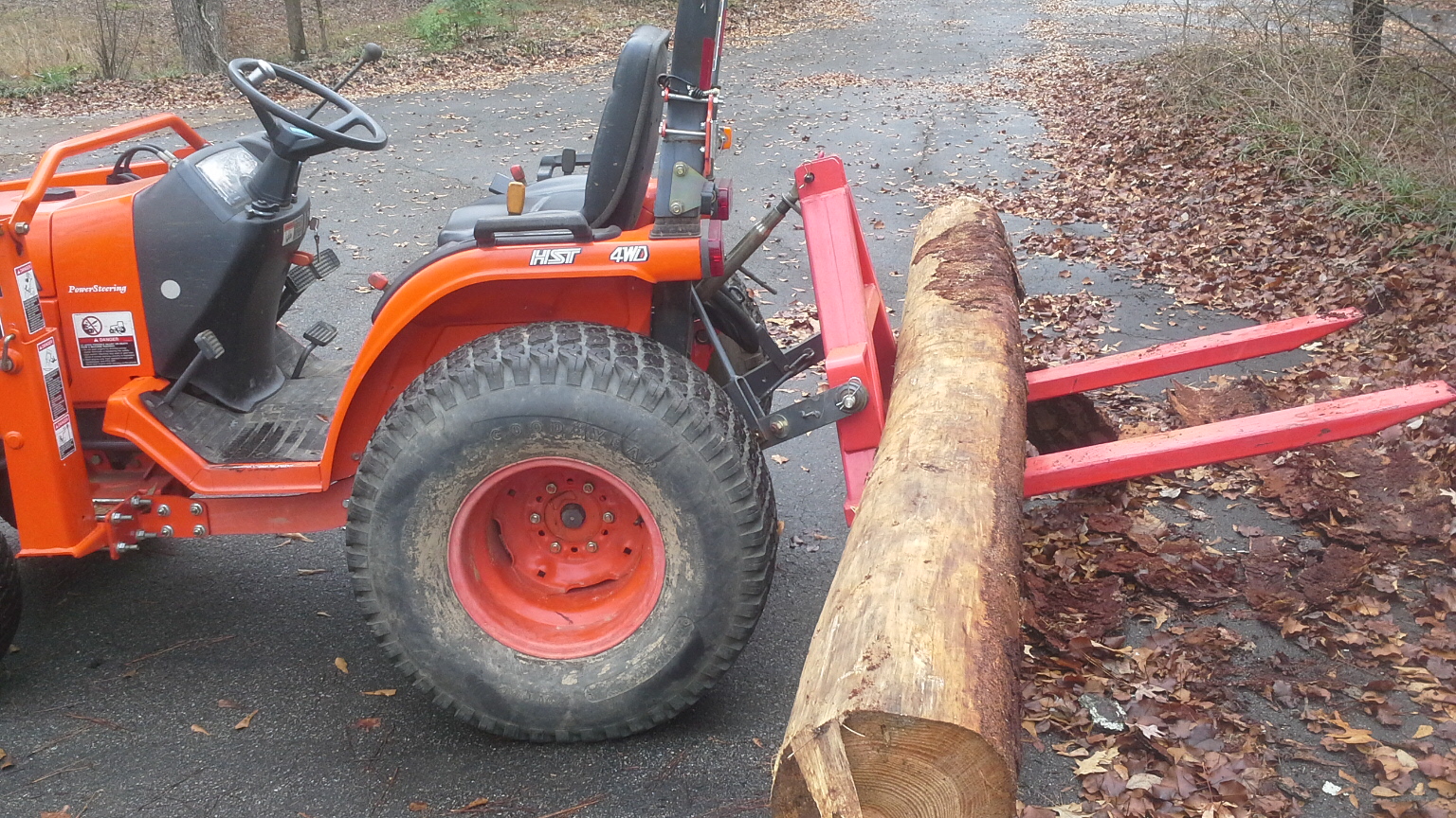

In regards to carrying firewood or anything else for that matter, maybe you would be well served with a 3pt tote box. Add Quick Hitch to your 3pt and you can set it down/pick it up and never get off the tractor. This keeps your FEL available for piling brush or loading the tote box.
I use my FEL Grapple almost all the time. But I don't think you would get much value out of it on a 2wd tractor. You are going to do most of your lifting/carrying work with your 3pt. Maybe a set of 3pt forks or 2 low prong bale carrier. Then build a tote box that you can pick up with the forks.

Thanks everyone for the replies. I have a pretty well stocked machine shop so I am not really lacking on non tractor tools.
The carry all / tote box is something I had been thinking of but not know by a name. Seems like you can get a frame for fairly inexpensive and build whatever box on it you want. The quick hitch also seems like a nice upgrade.

In order of importance to me for working with trees:
ROPE
3pt forks
front forks
a mount for your tools (chainsaw, wedges, bowsaw, etc).

Second the Piranha Tooth bar, and ballast box- make sure to leave room for carrying your chain, chainsaw, and long handled tools...
Then forget about the tote box and use pallets on front forks for moving wood etc.
We use wood bags on pallets to store and move our split fire wood, other use box pallets or build frames on them.
Regrading bucket forks vs true loader forks, it really depends if you have a QA (quick attach) for your bucket to make switching between forks, bucket, and grapple painless, or not...
We don't have one, but really get great utility using our chain-on bucket forks from the Yankee Warehouse. We never have close to exceeding their rating and the price is prett hard to beat too. I can get them off or on in less than 5 minutes even on a bad day, and they store easily too.
