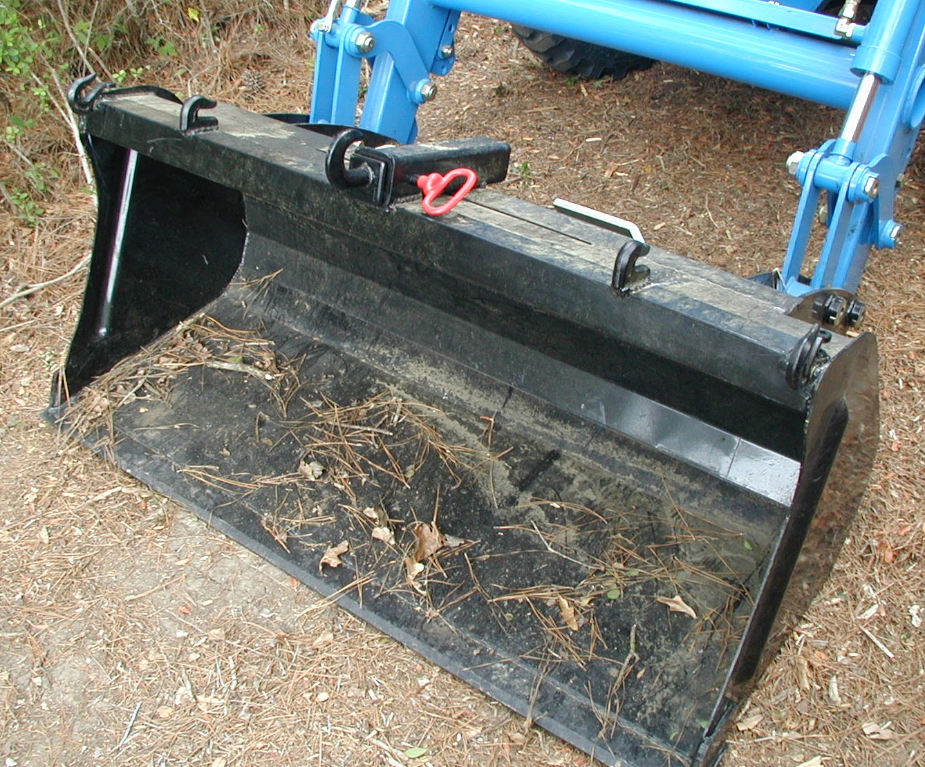

I realize I'm a little late to this thread, but here's a pic of my jazzed up OEM bucket:
The dealer added the 2 funky grab hooks on the outside. Then I read on TBN that any hooks you use for heavy work should be at or inside the loader arms to keep from tweaking the arms, so I had a friend weld on a 2" x 2" x .25" angle iron to the top of the bucket and add the weld-on grab hooks and the 2" receiver tube.
But the main reason I decided to post was to say you might want to consider buying dedicated attachments instead of the add-on stuff. In my particular case I found it cheaper (surprisingly) to just buy a set of QA SS forks instead of bucket forks and a QA SS bucket with teeth instead of a bucket toothbar. Then when you need forks or a toothed bucket, you simply change out a QA implement -- which I find really easy to do. The only problem I have is storage room. To be honest I haven't really used the toothed bucket, but the SS forks work great with better leverage than bucket forks and no worries about bending your OEM bucket. Just something to think about.
