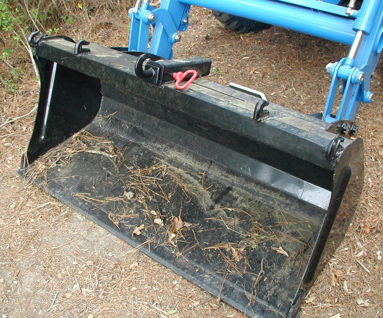

I realize I'm a little late to this thread, but here's a pic of my jazzed up OEM bucket:
The dealer added the 2 funky grab hooks on the outside. Then I read on TBN that any hooks you use for heavy work should be at or inside the loader arms to keep from tweaking the arms, so I had a friend weld on a 2" x 2" x .25" angle iron to the top of the bucket and add the weld-on grab hooks and the 2" receiver tube.
How do you use this setup for moving trailers? I dont see how it will work without having the trailer hitch height above the bucket....

I guess what I am trying to figure out, is if you have a trailer sitting with the hitch maybe 8" off the ground, can you get under it? Or do you need to leave the trailer jacked up higher than that?
My 6.5x10' utility trailer I tend not to use the jack on it, unless i have a load on it, since its easier to just lift off, than to mess with the jack.
   / Must have mods or attachments for new LS. #30
where mine is welded works great with a mild drop slug if i had it on top it would be a ***** to move the trailer around, and you have to watch you don't mount it back to far the cutting edge will hit the toung jack.....
