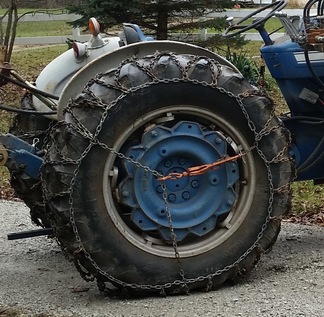

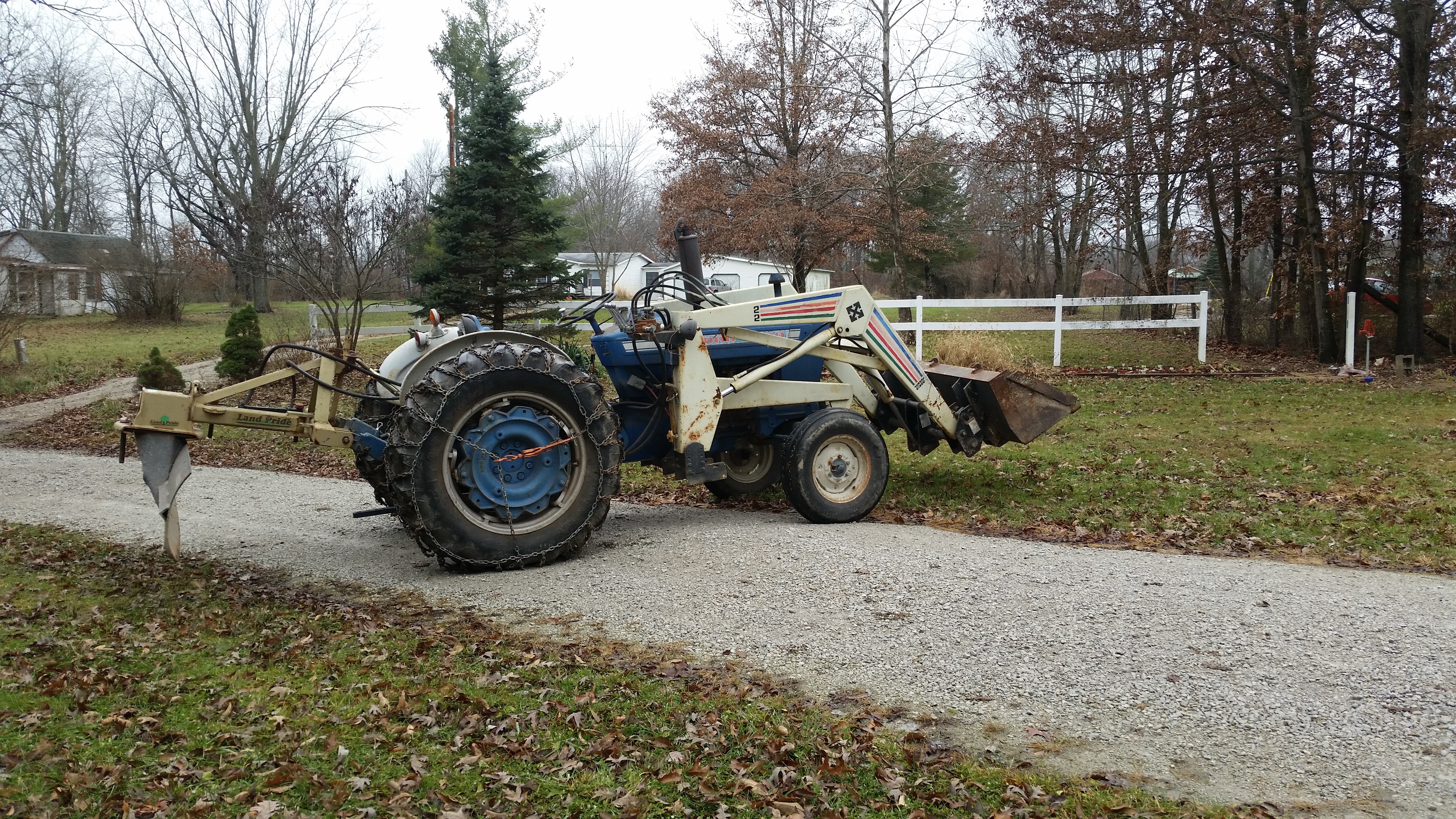

So far with 4wd I've never needed chain. Have them on a 2wd-too lazy to remove them. You may need wheel spacers to give you the needed clearance to run chains.
If you make your own chains a load binder on the outside makes a good chain tensioner. Use a quick link over the handle and hair pin to keep it latched.
