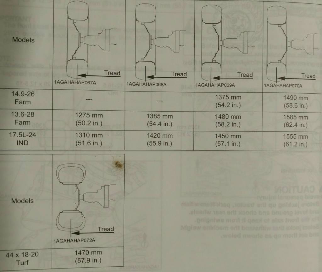

   / MX Series Pricing? #60
I also questioned the 88" also. (but it turns out not by much)
Per the manual, with R4, the widest the rears will go is 61.2" CENTERLINE to CENTERLINE. I am not home to measure actual tire width but I think it is something closer to 24" than 18" when properly inflated.
So add that all up and the widest R4 tire/rim OUTSIDE to OUTSIDE track width on a new MX is probably something just under 7ft or 84".
