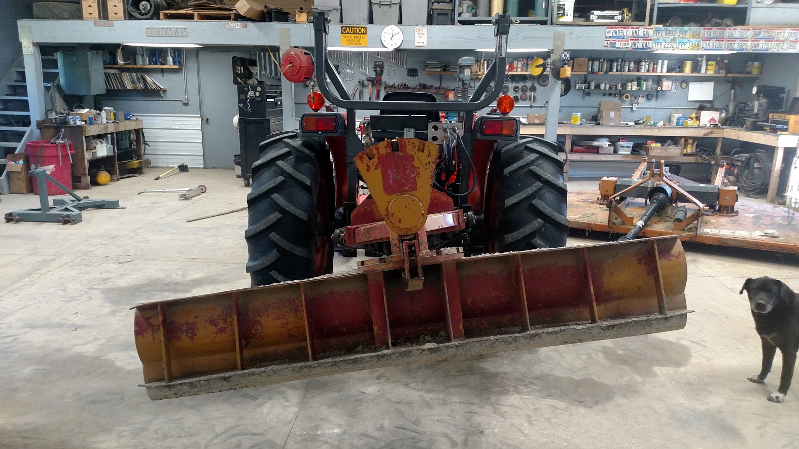

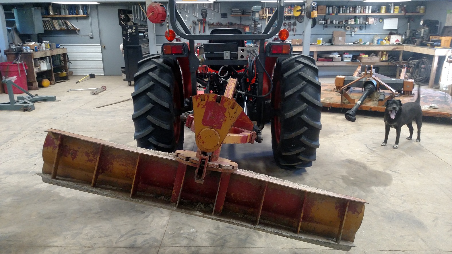

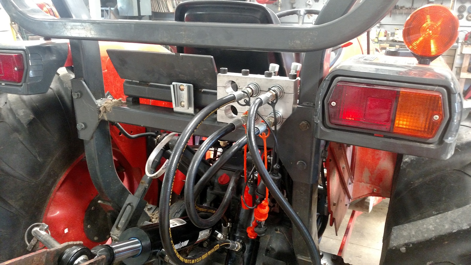

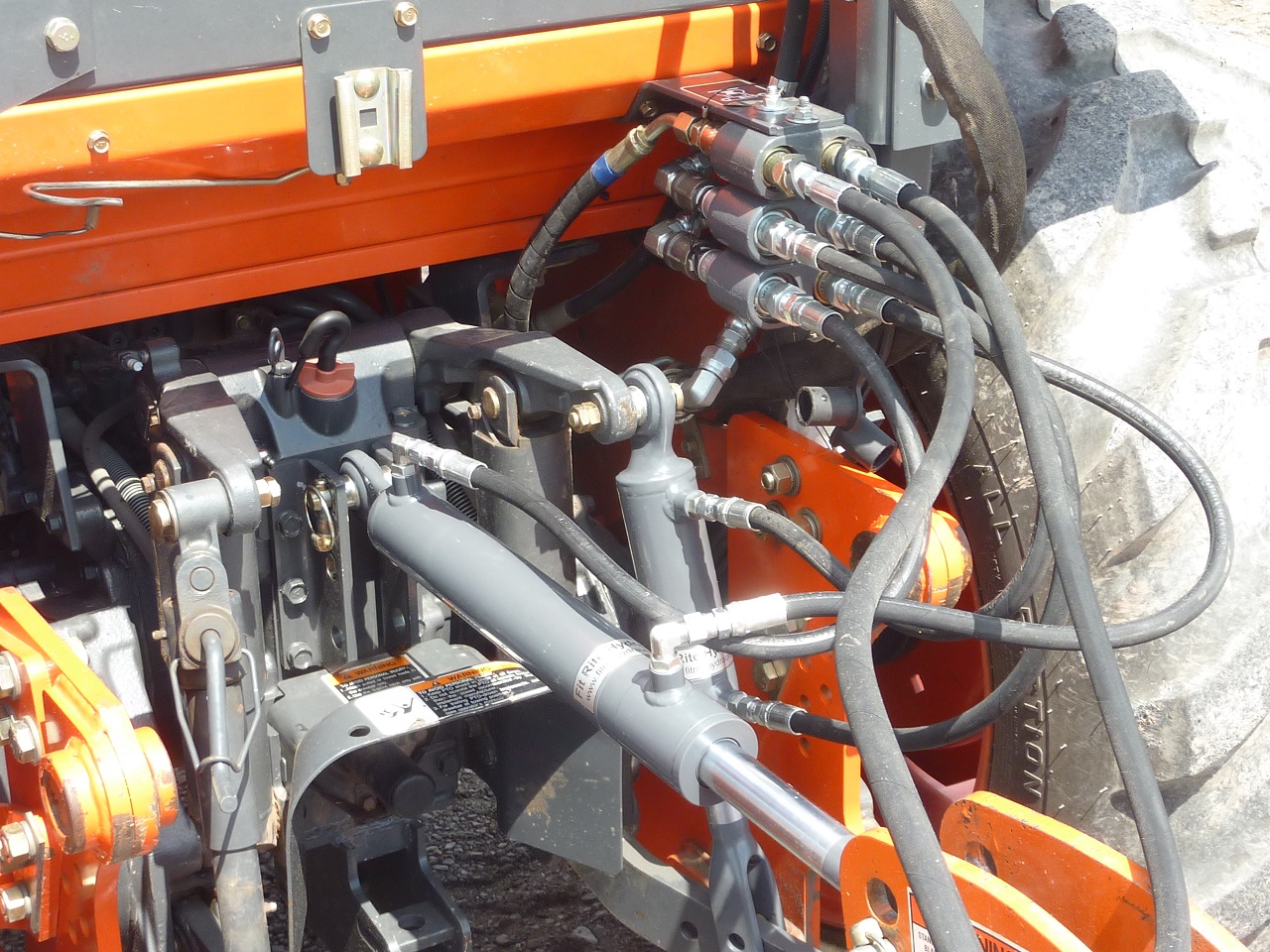

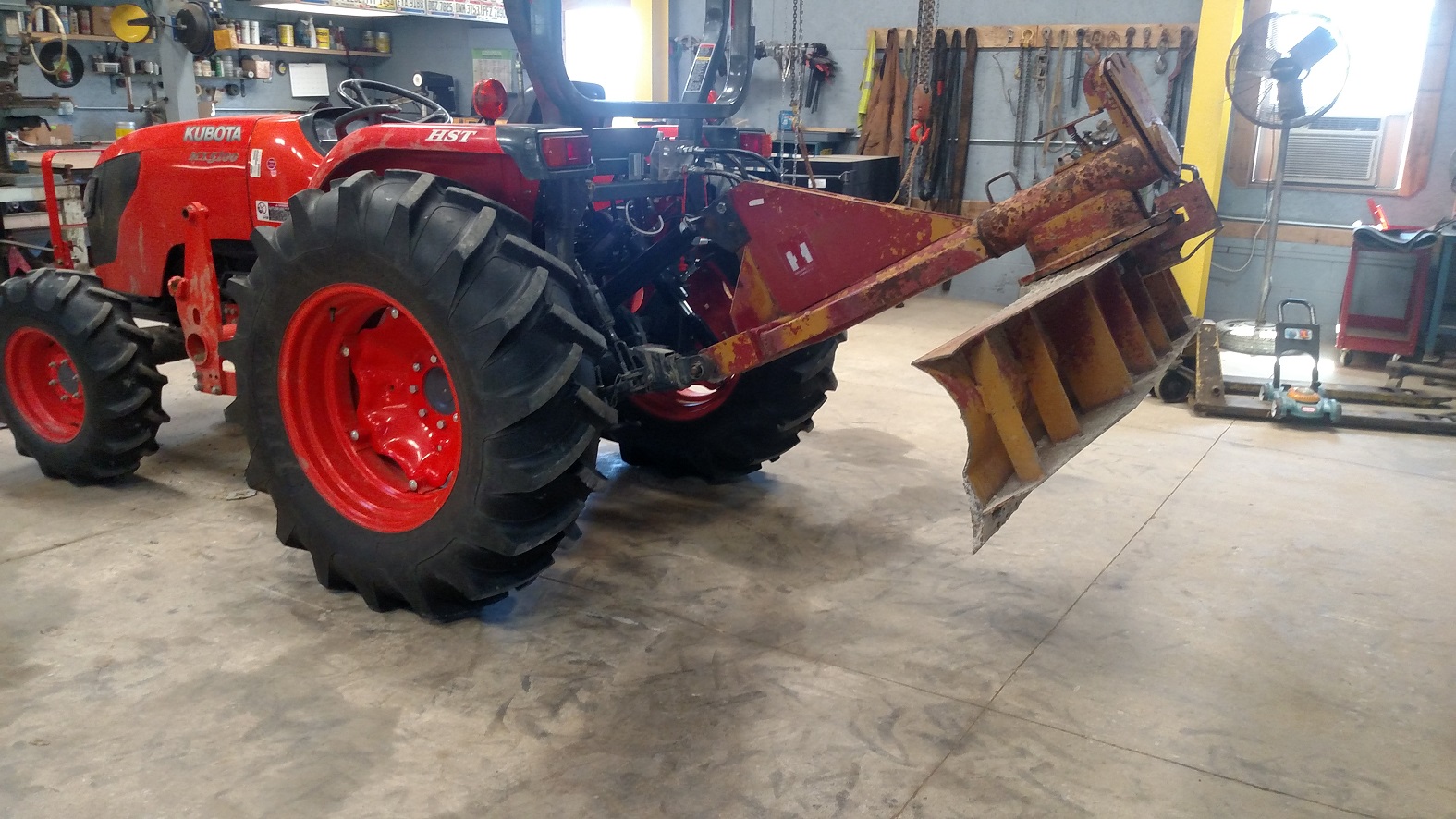

Here is the end result:
View attachment 475767View attachment 475770View attachment 475769View attachment 475768View attachment 475766
In the last pic, you will notice I made a new hook for hanging the TL when not in use. The OEM one wasnt big enough, and wasnt enough there for me to even make it big enough for the 3" cylinders.
Havent tried it out yet other than for pics and inspecting for leaks. Getting ready to do a little blade work right now over some tile/trenches I did a few months ago.
Feel free to post away now, or ask me anything.

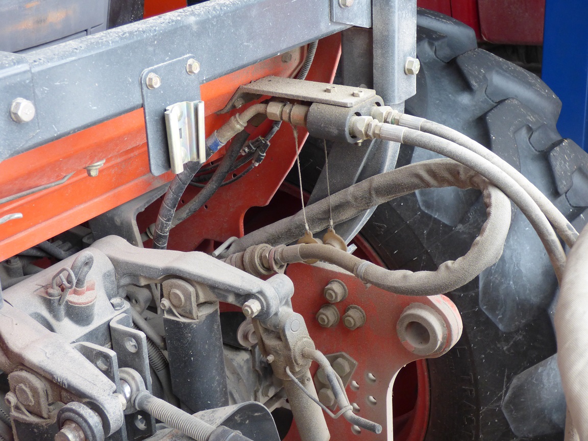

Quite a project and very nice work! Had I seen this earlier, I probably would have used some of your ideas for my project.

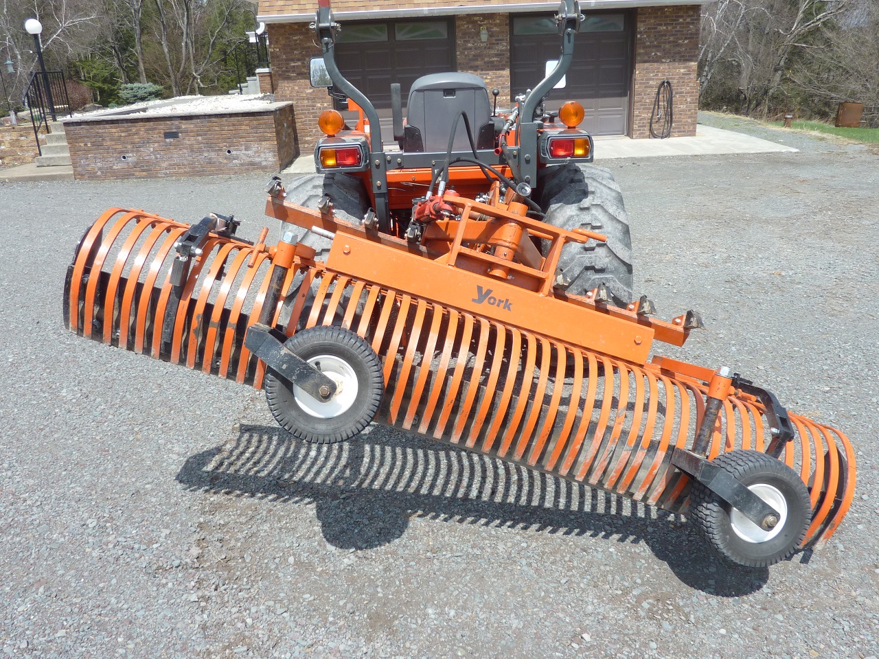

In my case, I had a single hyd. outlet on my L3430.
I needed 2 more outlets for my York Rake so I added 2 Kubota OEM QR ports ($400)
I used a Prince Wolverine 2 spool FEL valve ($170) along with misc. hoses and fittings ($ 90).
I made a simple bracket for the valve that attaches to 2 existing bolts on the ROPS. I tapped into the hydraulics for the BH90 backhoe instead of running a line to the FEL hydraulics. There are no permanent modifications to the tractor. I had Brian at Fit Rite Hydraulics make up a Top & Tilt Kit ($1100) and I was in business.
At almost twice the price, it was quite a bit more expensive than your project and only added 2 QR outlets. I'm guessing it took a lot less time though.
In any case, thanks for your excellent description and thorough documentation!
