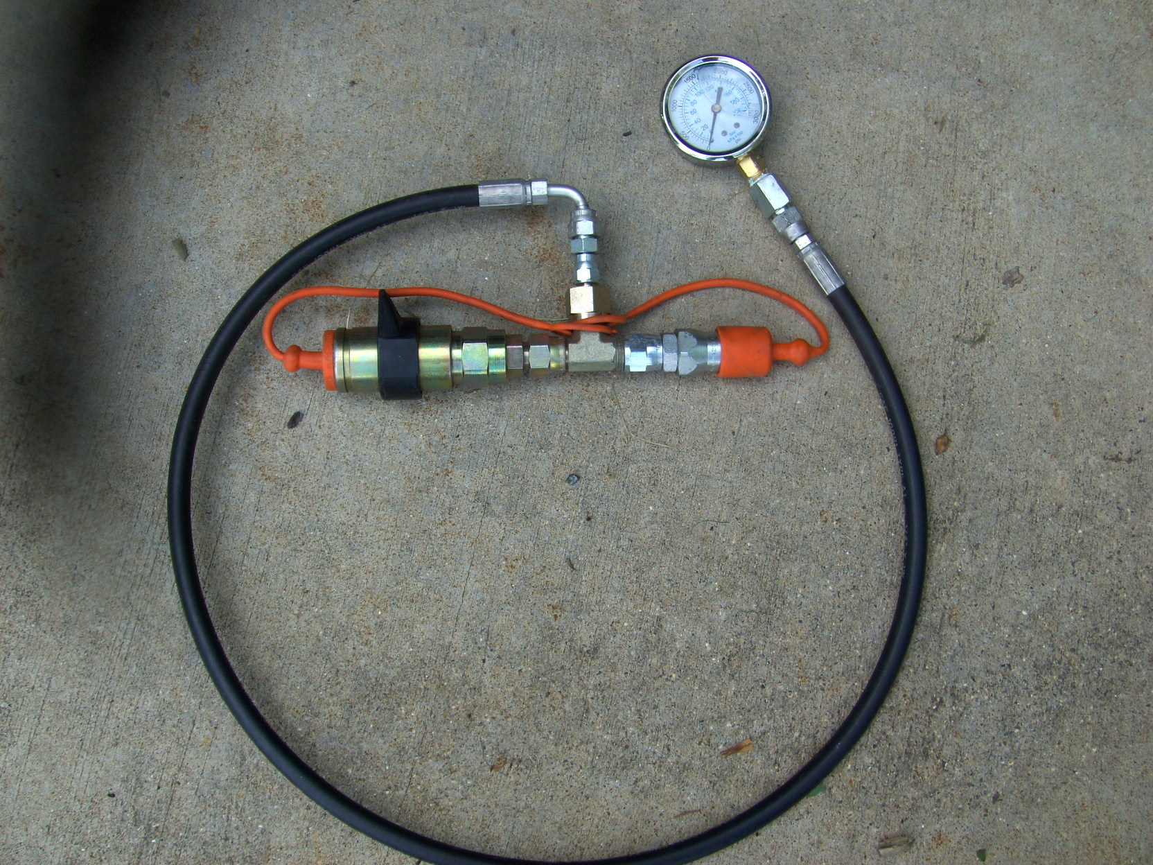

I'm gonna make some phonecalls in the morning and see if i can get it checked out. Best I can find the pump should be putting out around 2700 PSI.
   / MX5100 FEL question #12
You could "TEE" in a pressure gauge and check your pressure on lift that is too heavy for it to lift.

I recommend installing a 3000 hyd gage in a tee in the IN port of the FEL valve and use it to set the relief valves, troubleshoot, and monitor the hyd system.
Check your relief setting against your manual.
Does your relief valve come on now?

It may be relieving, but at what pressure.
If the FEL relief pressure is correct, then it should pick up the advertised load.
The cylinders will develop the force based on the load and the pressure available.
The load advertised is at the bucket pins. The further out the load is, the less you can pick up.
You may pick the rear end up, but it is based on the balance point of the load to the weight of the tractor.
If you add ballast to the rear, you increase your pick up potential without tipping.

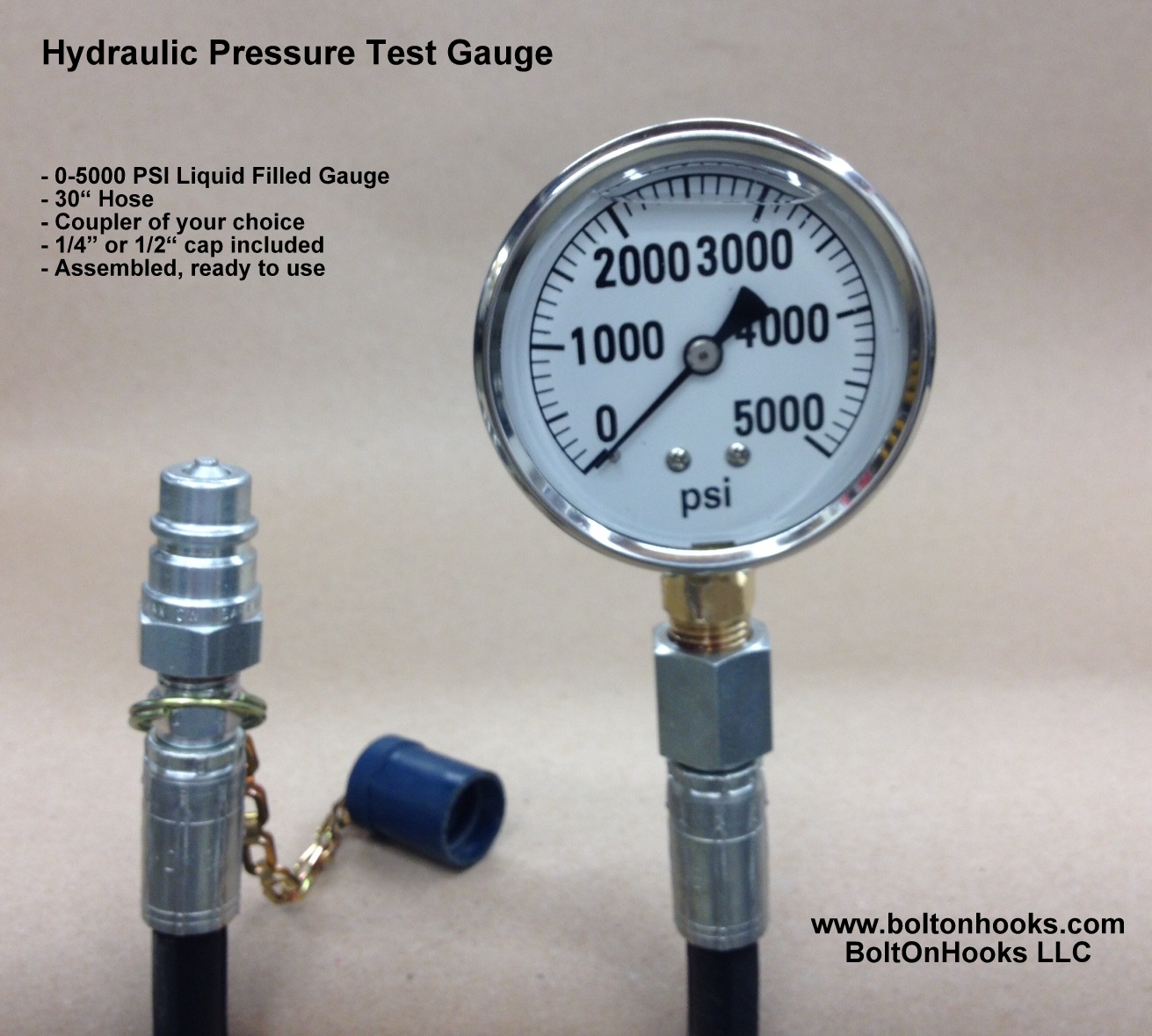

Get a gauge setup, and test your pressure-that way you'll know what's going on. Tee'ing in a gauge is not needed, you can simply plug one into a loader port to test the pressure:
Here is the simple one we sell, although I'm not sure we have the proper QD to fit your machine in stock. You may be able to source parts locally to make your own as well.
Here is video I made on testing the pressure on a JD, but the theory is the same for your machine:
https://www.youtube.com/watch?v=TGyH7TDrdHQ&feature=player_detailpage
