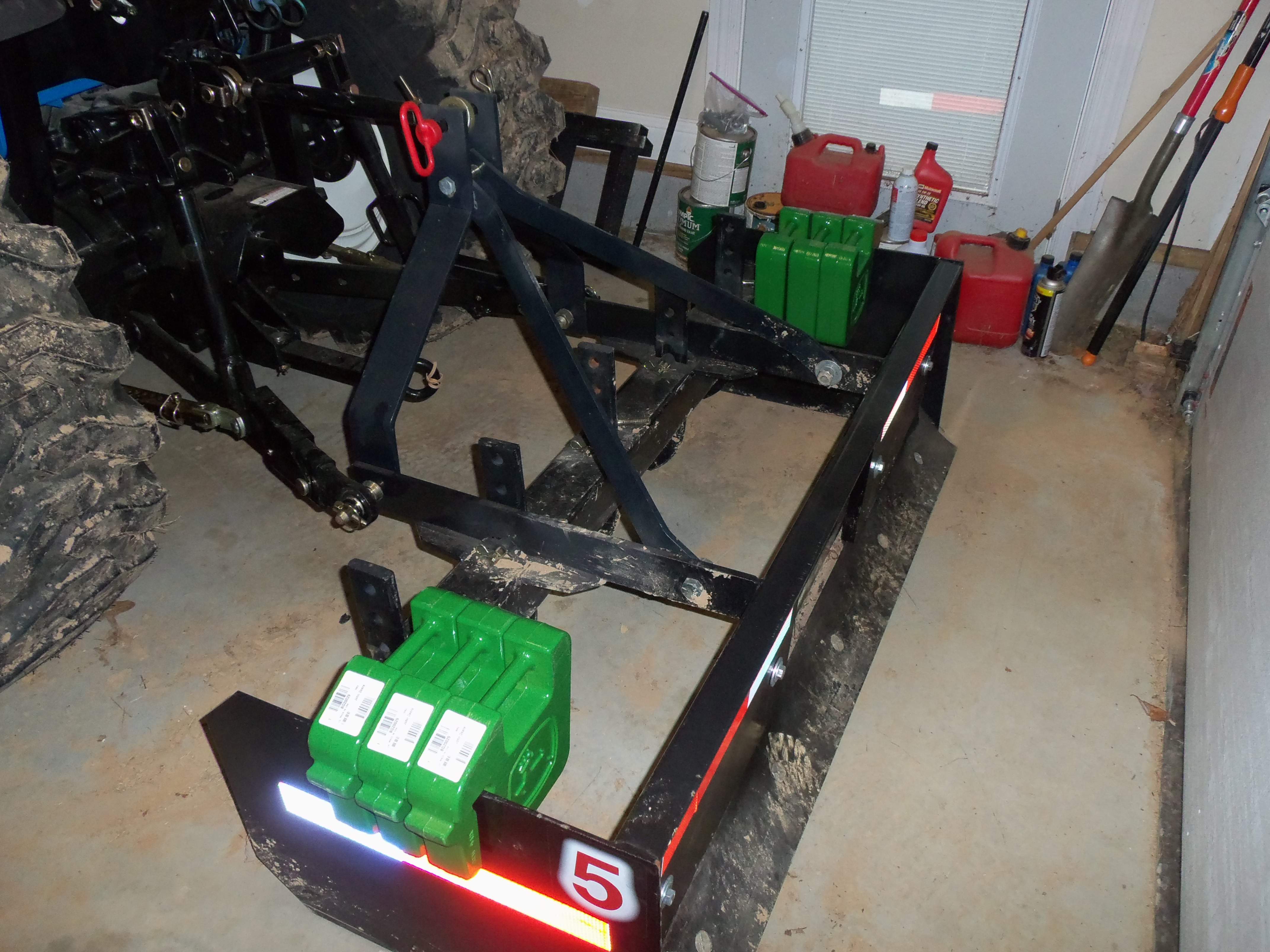

Back when I had my 5030 it got light on the backend ocassionally so I went to TSC and bought one of those right angle pallet lifters, welded on a sheet metal box and filled it with concrete. I had to weld on a pair of angle supports to. I bet it weighs nearly 1000 pounds. Don't use it anymore and now it's a toe stubber....lol
Someone wants it and they are nearby, they can come and get it for free..... It's for a Cat 1-2 3 point and I'll load it on a pickup or trailer. How you get it off is your problem.....

Back when I had my 5030 it got light on the backend occasionally so I went to TSC and bought one of those right angle pallet lifters, welded on a sheet metal box and filled it with concrete. I had to weld on a pair of angle supports to. I bet it weighs nearly 1000 pounds. Don't use it anymore and now it's a toe stubber....lol

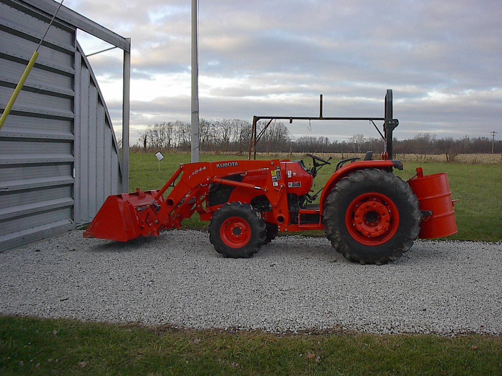

Sounds like a good idea. I have considered fixing something up like that or a concrete filled barrel as my bb sometimes gets in the way in tight woods.

James, our hills are nothing compared to yours, but even with the 1000 pound cutter, I have picked the rear end off the ground a bit backing out of a ditch or gulley with a full bucket. Like you, I really don't notice it, but I pretty much know when it is going to happen and it comes down pretty quick. I keep the bucket really low.
