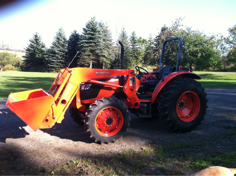

If the m series you're looking at has the LA1153 loader, that's the one I'd go with. The M6040 that I had with loaded tires, could not over tax that loader, so you'd be well served by it.Moving one ton pallets with the forks was a breeze.
