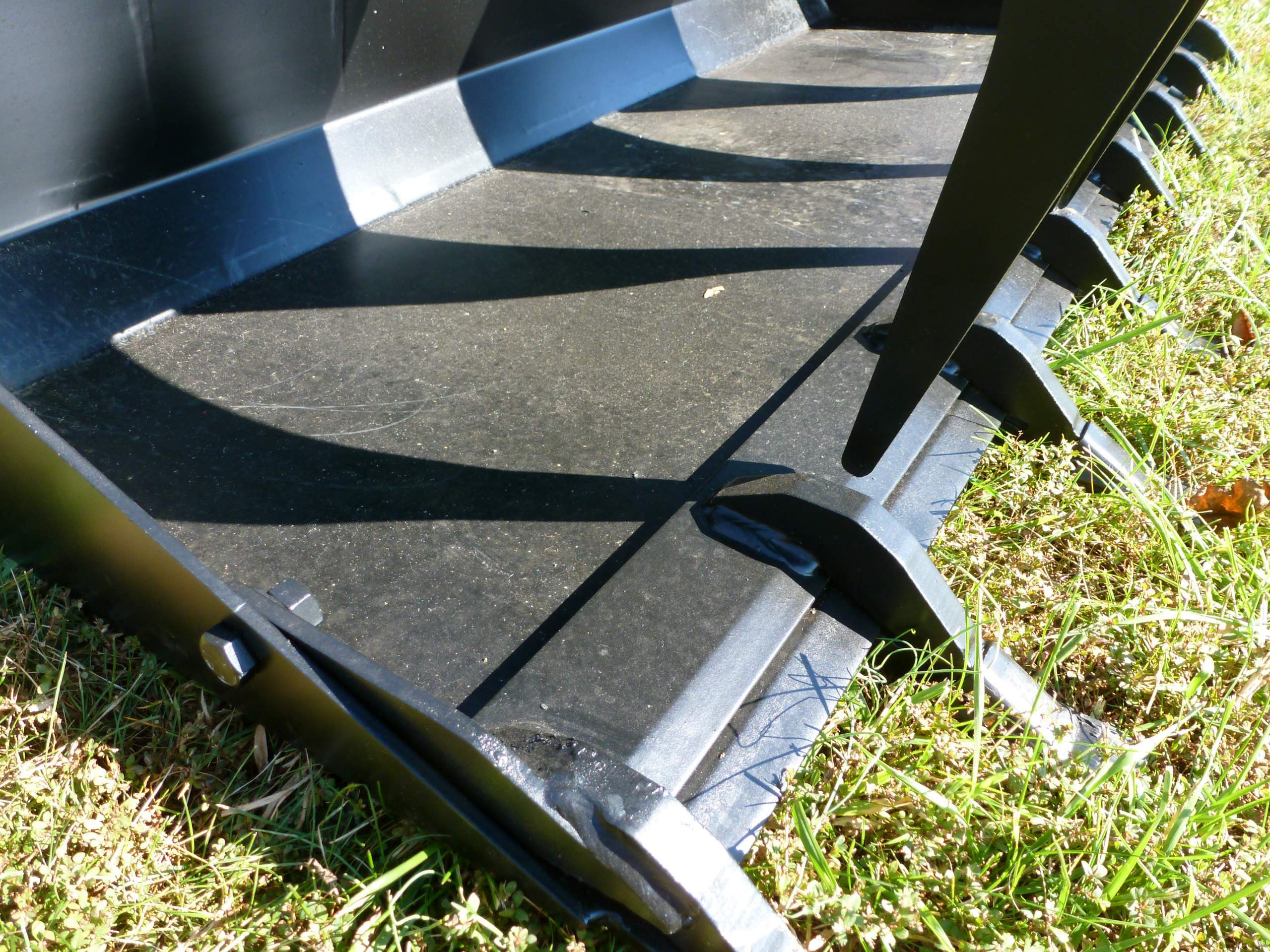

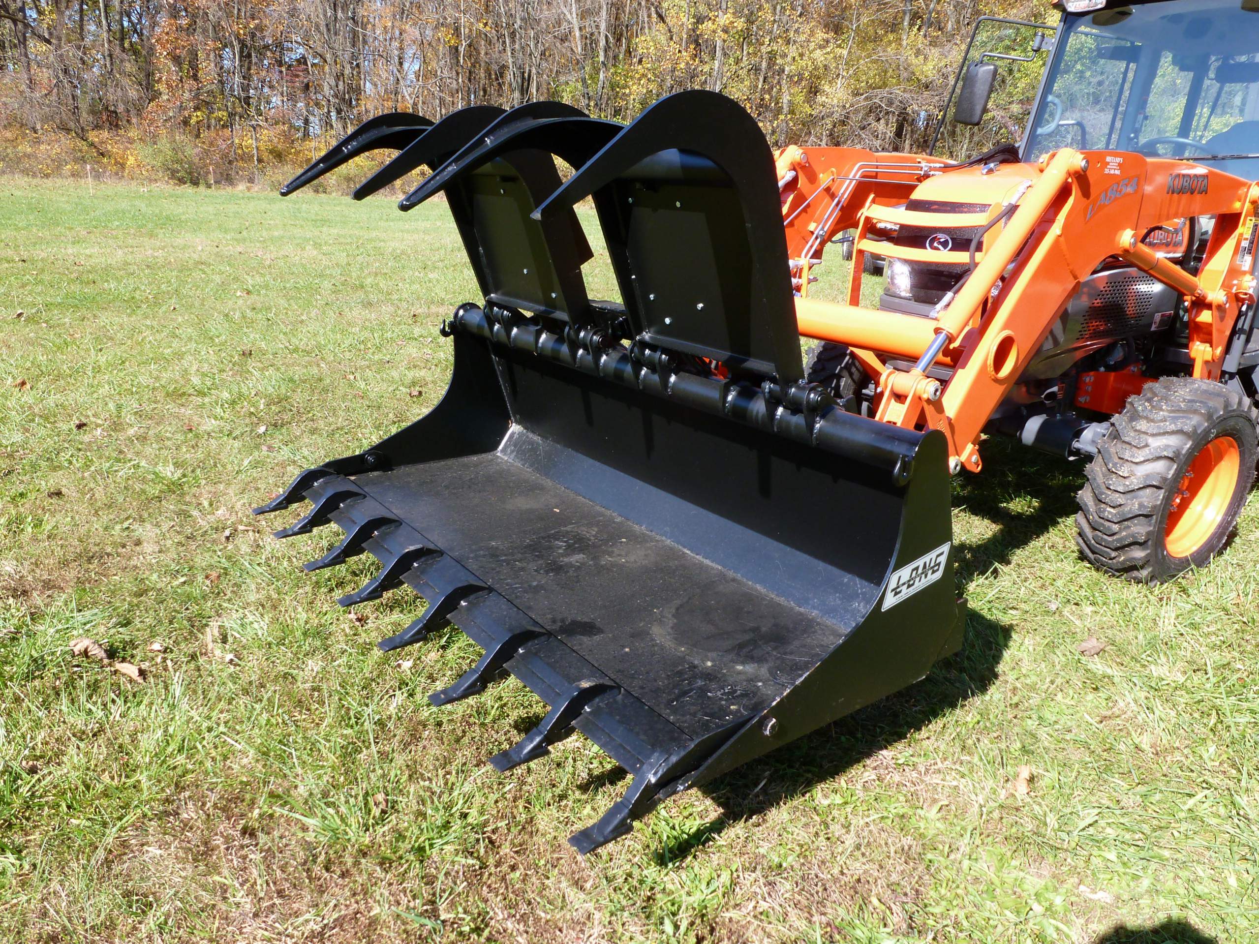

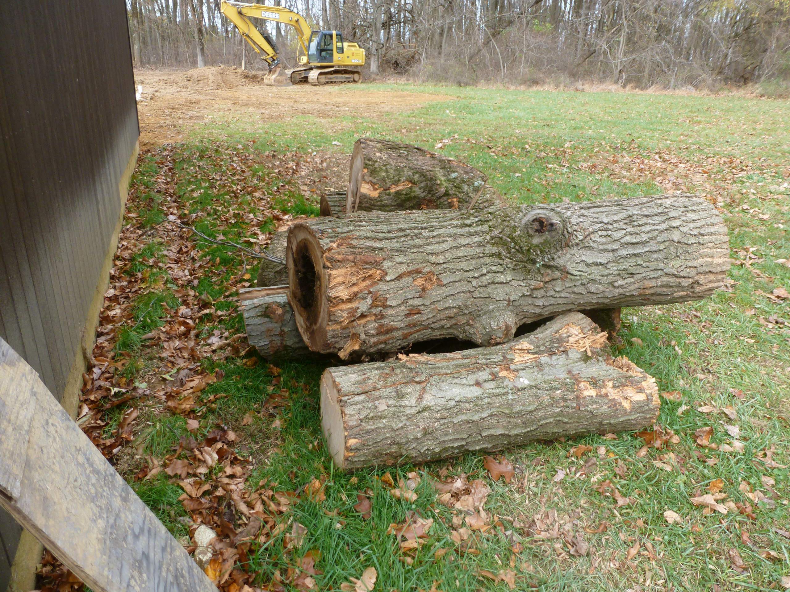

sometimes pictures are helpful. Here is the grapple I bought; I asked for a 66 and let myself get talked into a 72. Not a good idea for such a heavy duty grapple, which would be an awesome addition to a heavier tractor. I wanted one bucket that did it all, and I agree that the JR Long people build a seriously heavy duty grapple. This is just not the bucket/grapple combo to put on a 4200 pound tractor with a light rear end. No, no tires filled yet, but I may have to. Want to see how the wheel weights help first.
And from a lift capacity, I could barely pick up the log on top, which granted was seriously heavy oak, and could not curl with it at all. Having the loader checked out for curl right now. But I thought a tractor this size could pick up more...maybe that log weighed a ton, but I don't think so.

Thanks for the pictures, they certainly do help visualize the load that you are talking about. How much does that grapple bucket weigh? Looks pretty heavy, but I agree with you, that log doesn't look like it would weigh a ton to me. I would certainly expect to be able to lift logs close to that diameter that were considerably longer. I have heard that filling the rear tires on the Grand L's is a definite must if you want to maximize your lifting with the FEL. Not sure if the same is true for the M Series or not since they have more built-in weight. I don't like the idea of filling the tires and would prefer to go with wheel weights and ballast, seems more versatile to me when I have the option to remove the weight when it's not needed. However, everyone I talk to you and most everyone on TBN recommends that you fill the rear tires if you have a FEL.
