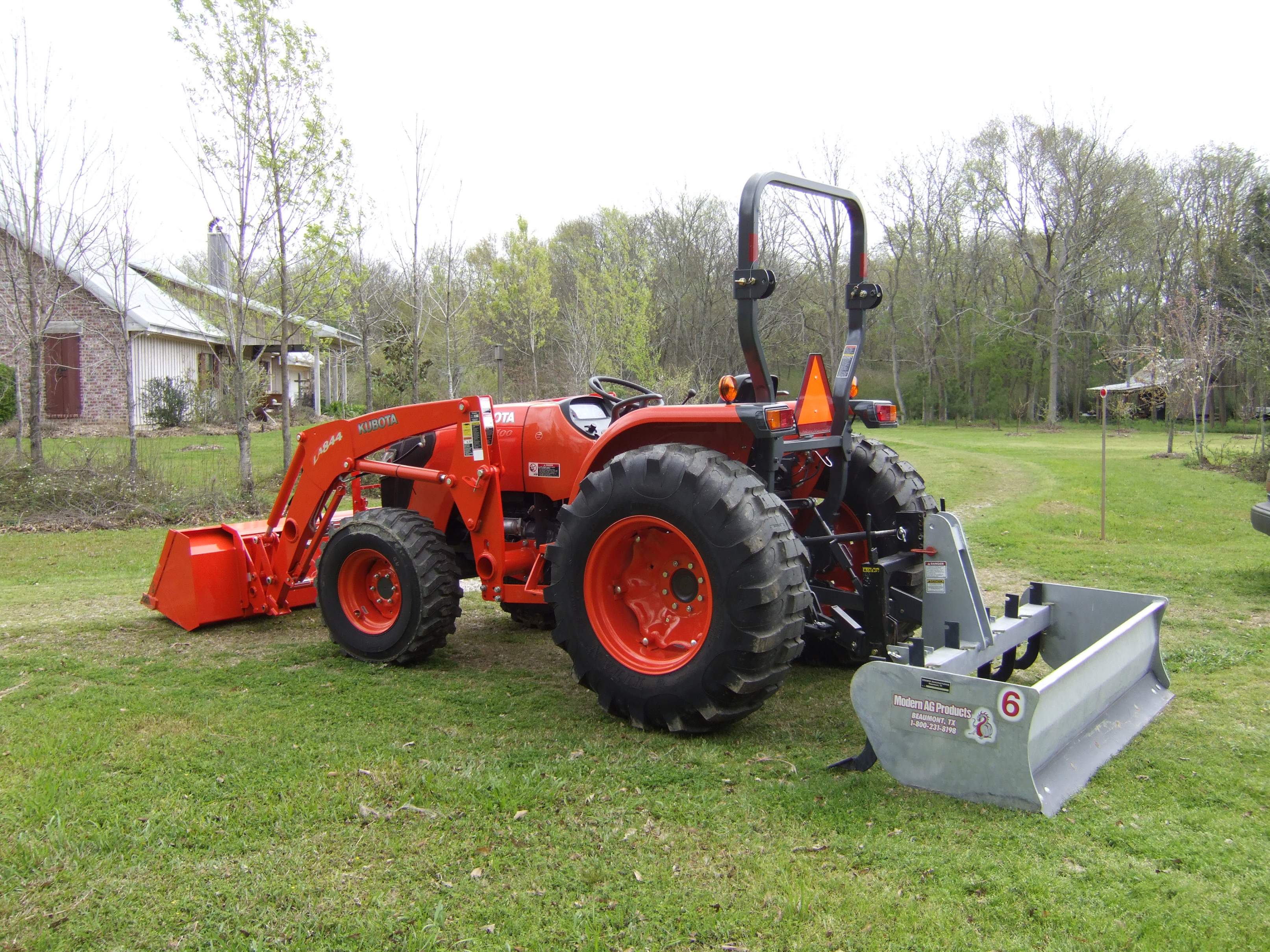

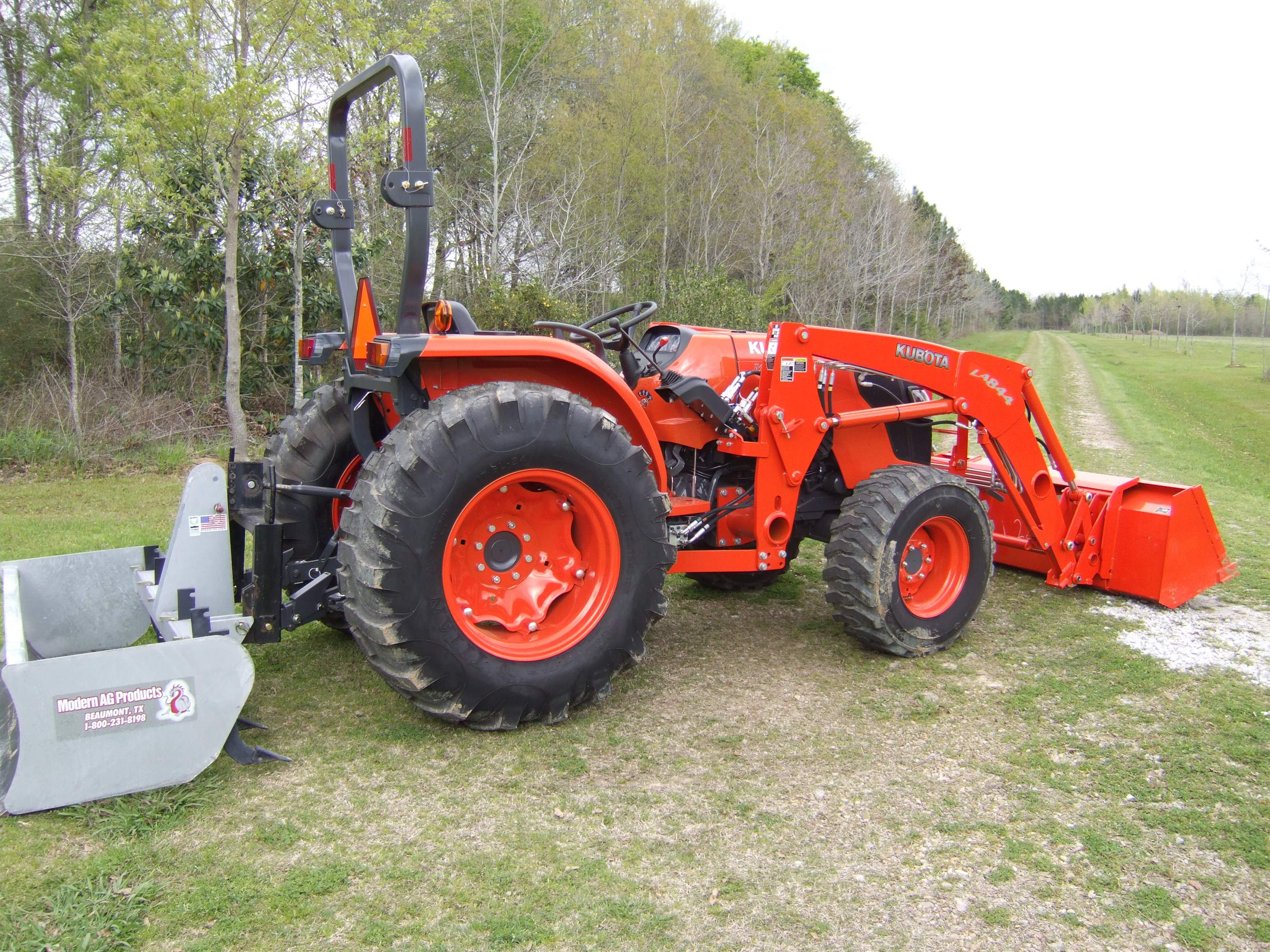

Couple of pics for you guys to view. New box blade attached. Rotary cutter should be here in 3 to 4 weeks. Cant get over how easy it is to post a picture on this site.

Very nice rig, what does the box blade weigh?

BB weighs 700 lbs. Too wet here yet to try it out much.
