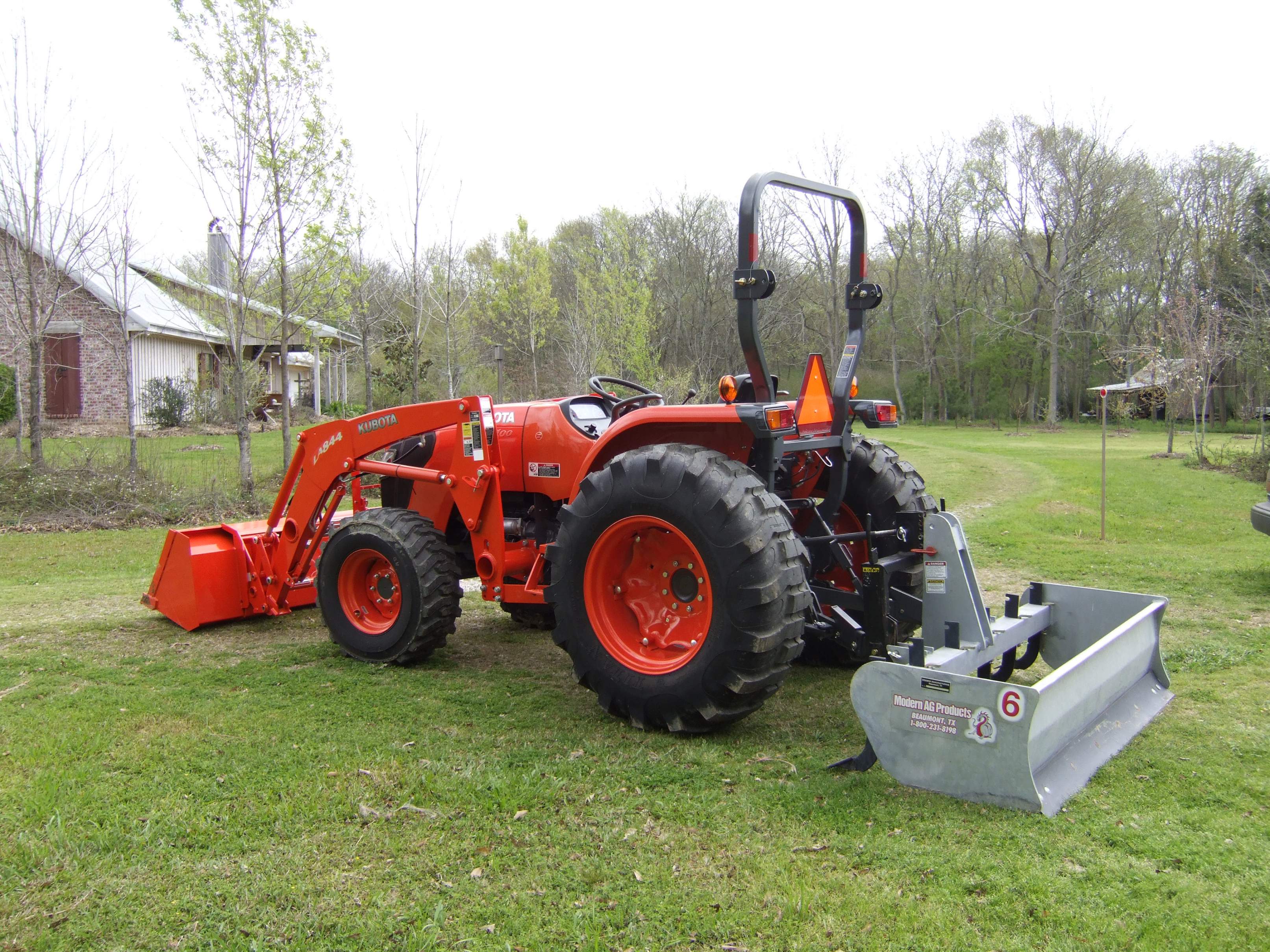

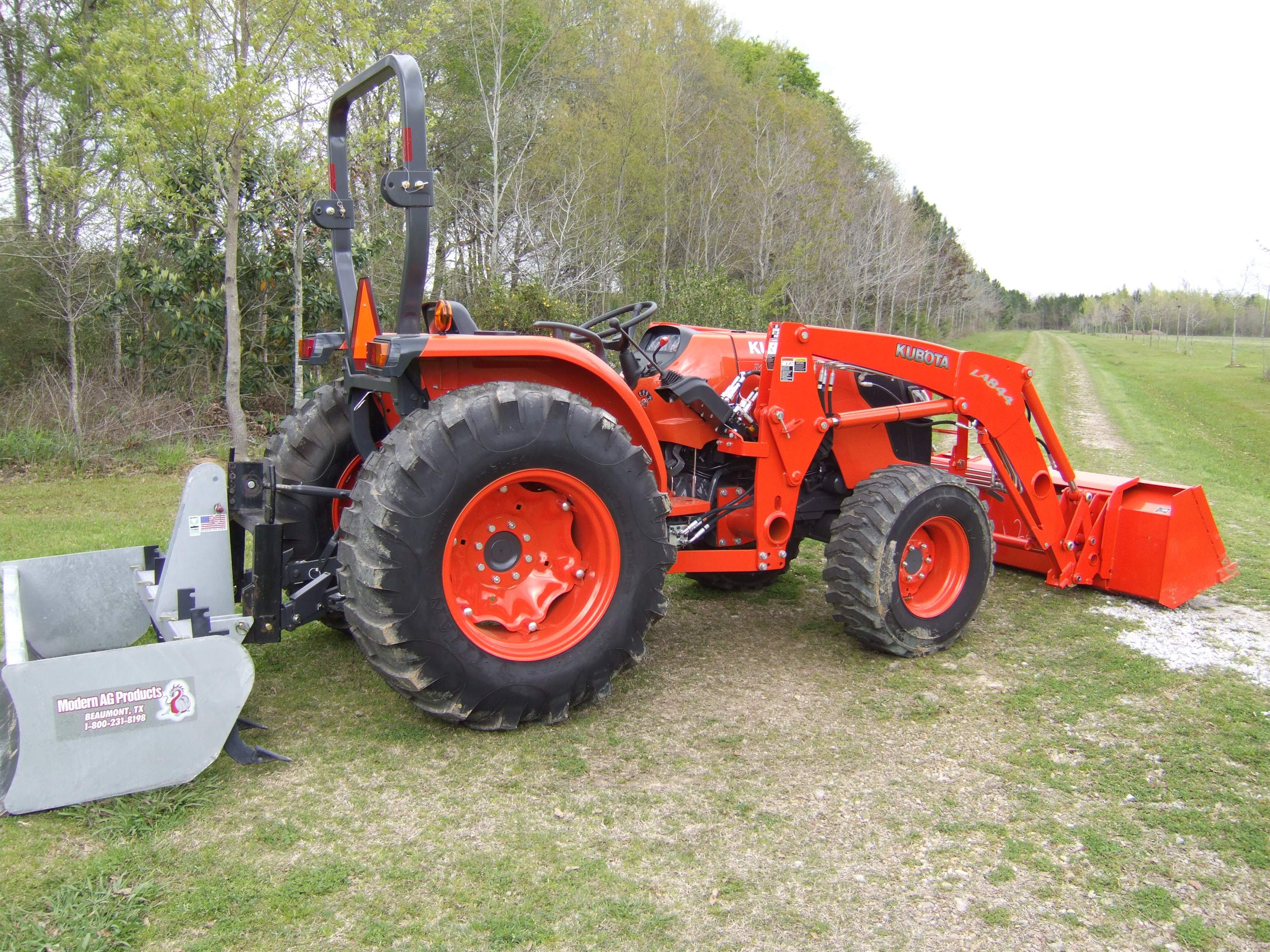

Couple of pics for you guys to view. New box blade attached. Rotary cutter should be here in 3 to 4 weeks. Cant get over how easy it is to post a picture on this site.

Very nice rig, what does the box blade weigh?
   / MX5100 Which rotary cutter?
#24
BB weighs 700 lbs. Too wet here yet to try it out much.
   / MX5100 Which rotary cutter? #26
It sure looks nice. We are wet here and I haven't put mine on in several months; raining again today.:(
