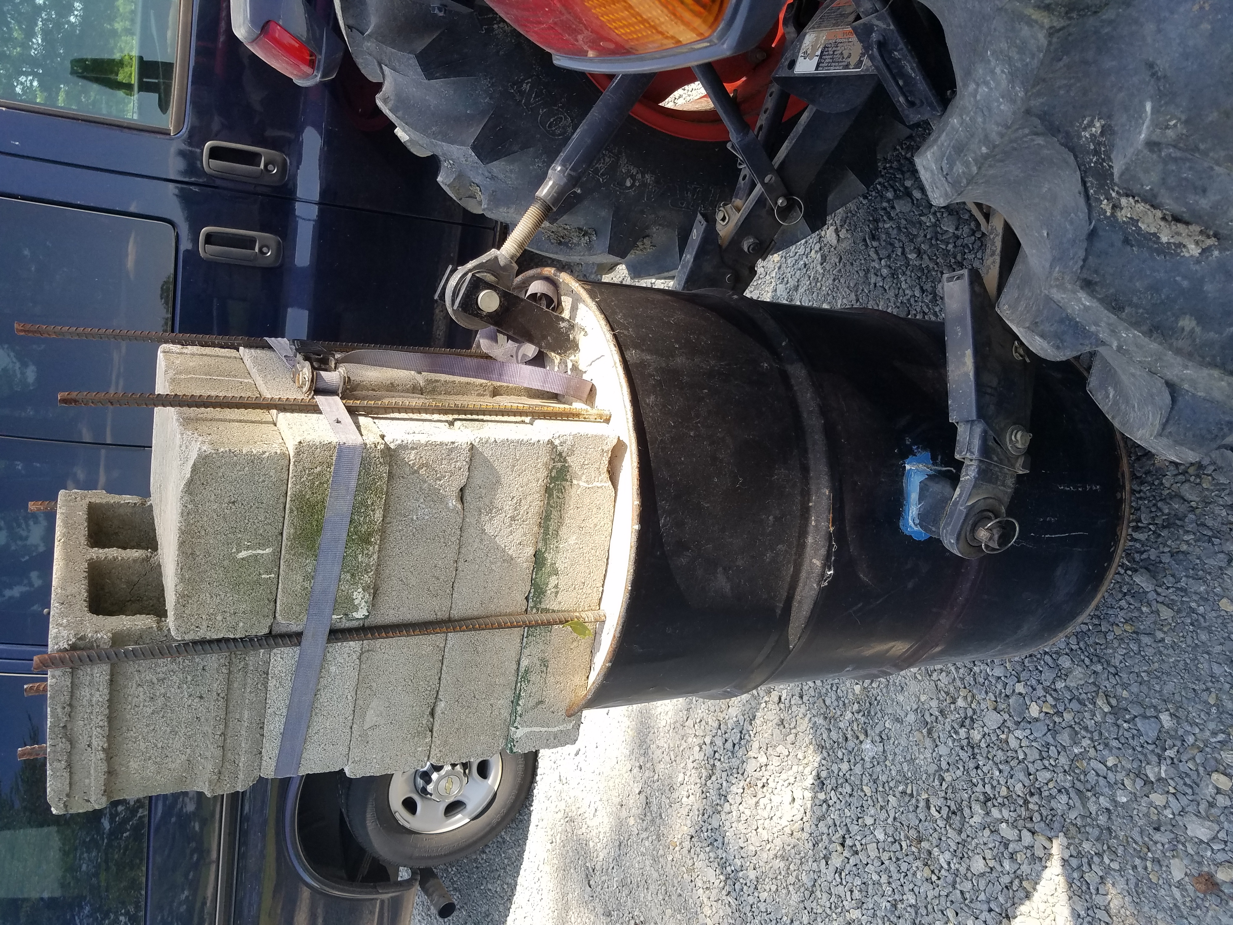

2018 Kubota Mx5200 HST with 87 hours. Over the past few days I put some serious use on the loader for the first time. I moved about 30 tons of clean dirt that had been sitting in a pile for about 3 years. I also moved about 20 tons of crush and run gravel that had been sitting for over a year, compacted by horses (yes, they loved climbing it).
The piranha tooth bar made it easy to cut into the piles. My concern is that whenever I got a good bite into either pile the loader would stop lifting or curling. I've read many posts that the MX series will easily lift the rear end, even with plenty of rear ballast. That never happened, not even once.
The only ballast I have is a 3 point drum filled with concrete and blocks. I estimate it to weigh about 1400 lbs. The rear tires are NOT filled, nor do I have any wheel weights.
Normal or do I have issues?

Plenty of counterweight but I would be very careful of tipping with such a tall setup especially with the bucket raised with a load.

I replied to you over on the Kubota forum, but I will here as well. How do you know you are within the lift capability of the tractor? Are you expecting that if you have too much weight in the bucket that the rear will automatically lift? You claim you have 1400lbs of ballast, and what do you think the rear portion of your MX weighs, nothing? Your "in the bucket" lift capacity is probably around 1500lbs. You've got way more weight than that on the rear of the tractor, so I don't think you are going to lift it. Take off some ballast if you want the rear to come up.

With my water tote weighing about 2000lbs, and my forks on, my MX could just barely lift it a couple of inches off the ground, and the rear did start to come up slightly, even with loaded tires and a brush hog on the back. But this makes sense to me considering any tractor will lift more right at ground level since there is more leverage at that point. From the bed of my truck, it simply wouldn't do it.
He could check his pressures, but it's probably a normal condition he's experiencing. The MX is a great tractor, with enough lift for my purposes, but there will always be that time when you wished you could pick up a little more.
