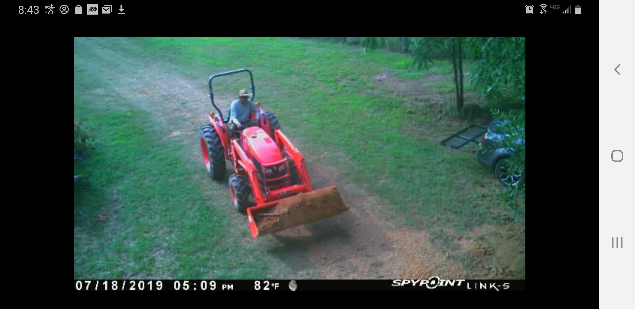

I have always said that a tractor with a loader will have one of two problems. It will either lift the rears off the ground, or it will not.
I see what you did there.
