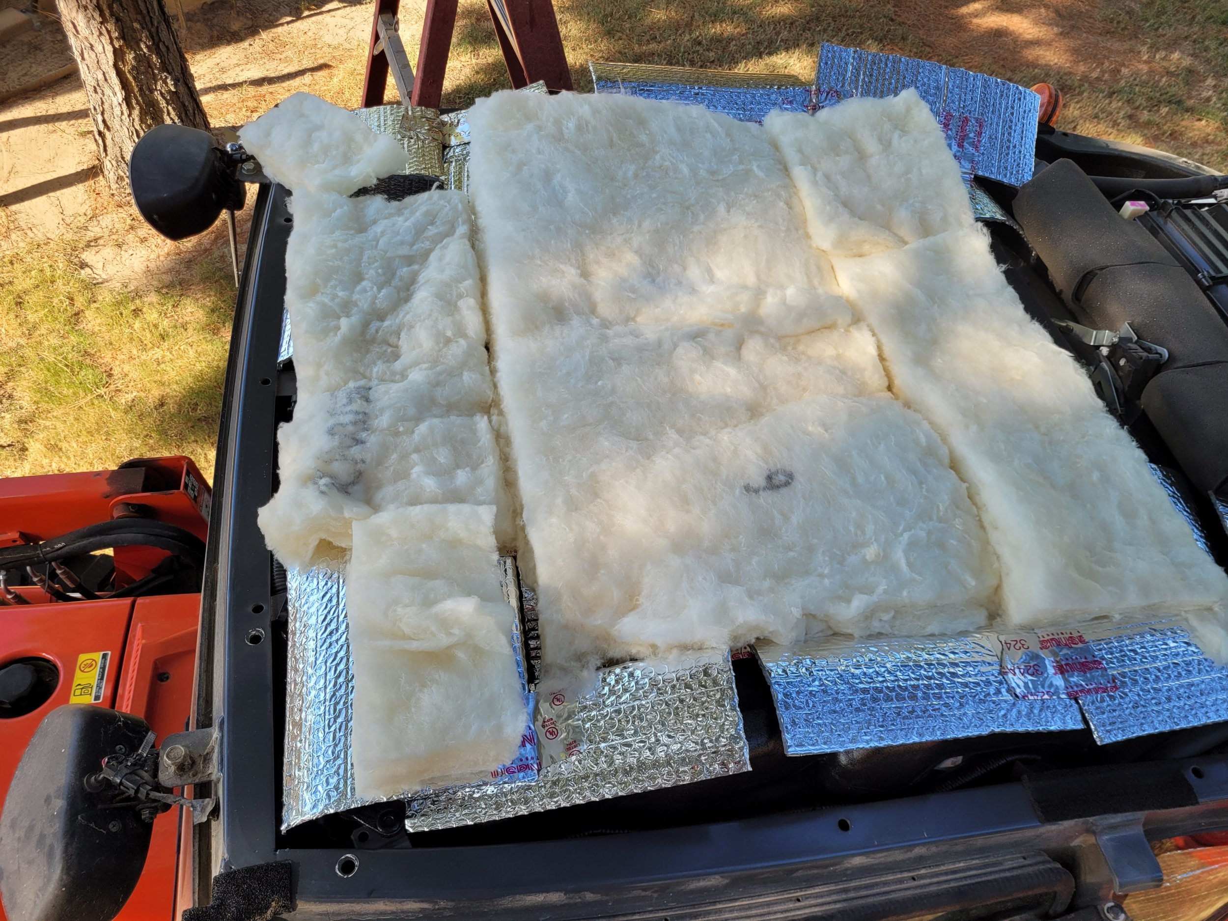

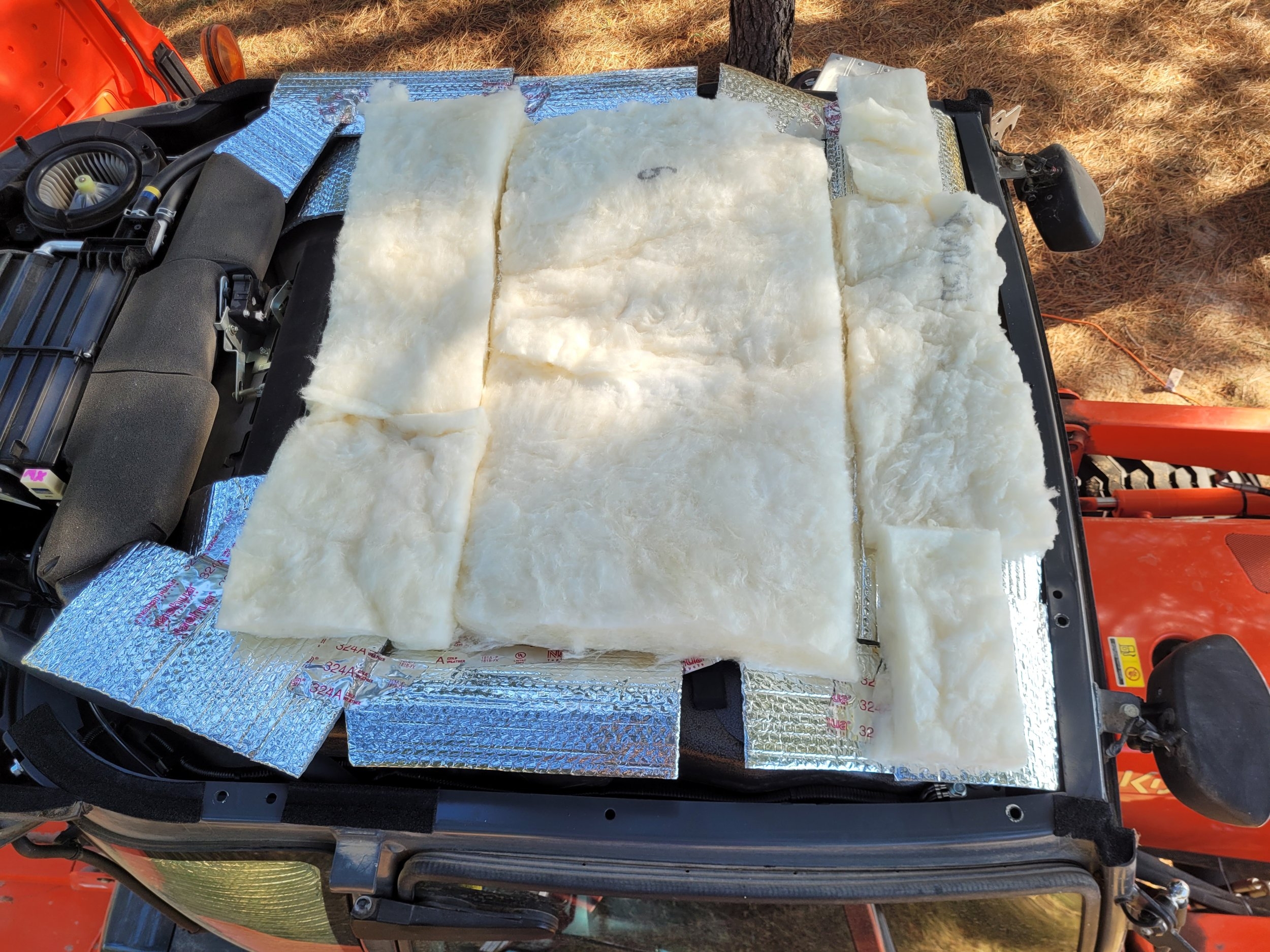

I did three things to my MX6000 cab that made a world of difference in keeping the cab cooler in the Texas heat. First I tinted all the windows. Then I added sound/heat deadening material all under the seat all the way to the floor. Last I pulled the top, cleaned everything up and added insulation (see pics). I mowed a field for two hours last week at 97* and was comfortable the entire time.

I did three things to my MX6000 cab that made a world of difference in keeping the cab cooler in the Texas heat. First I tinted all the windows. Then I added sound/heat deadening material all under the seat all the way to the floor. Last I pulled the top, cleaned everything up and added insulation (see pics). I mowed a field for two hours last week at 97* and was comfortable the entire time. View attachment 809246View attachment 809248
That won't work with the earlier cab Kubota's because that wool insulation effectively blocks the air flow. All I use is foil-bubble- foil reflectix, glued to the underside of the roof panel. I might add that I did add a 12 volt supplemental (automotive) cooling fan bracketed right in front of the AC condenser unit that cycles with the AC compressor. Like I said in a previous comment at 90+ ambient, it's so cold in the cab, I shiver.
