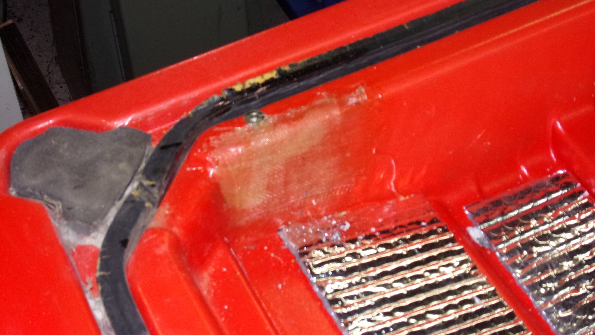

One thing to keep in mind and that is, you'll probably have to replace the perimeter gasket because when the roof is in place, it compresses it and it won't expand again. I replaced mine the first time, I believe the gasket then (with the corner pieces) was around 100 bucks and it's a dealer (Kubota part) item.
The other issue you may have is the OEM Riv-Nuts in the roof may be loose. I replaced them as well with new ones plus I 'glassed' them in for added strength.

Use fiberglass mat and liquid instead. HF sells a nice Riv-Nut setter (Doyle) with an assortment of them included and you can use it to tighten the existing ones if they spin. Kubota should have used metal backers (washers) under them but didn't except on the 2 on the front.

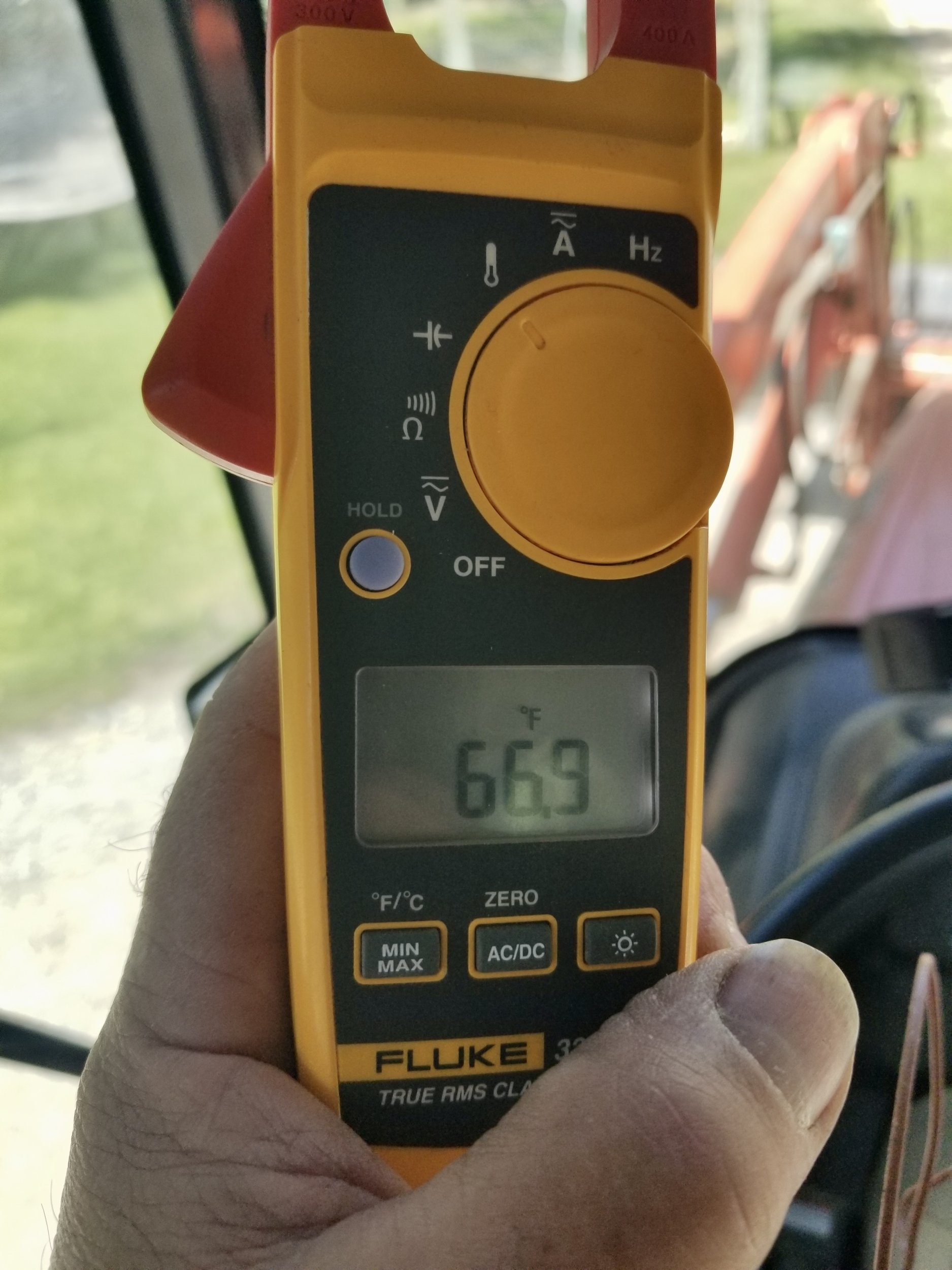

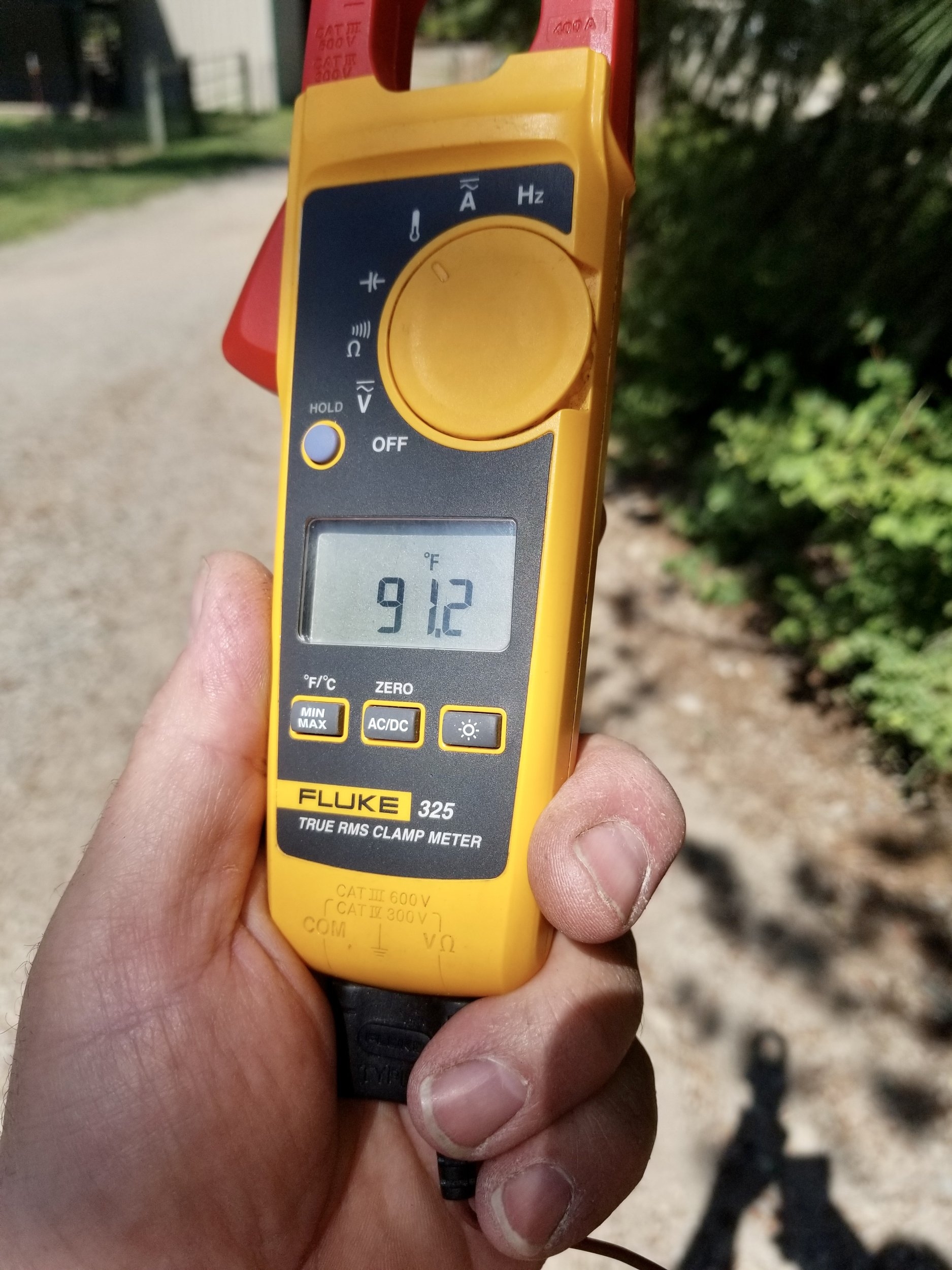

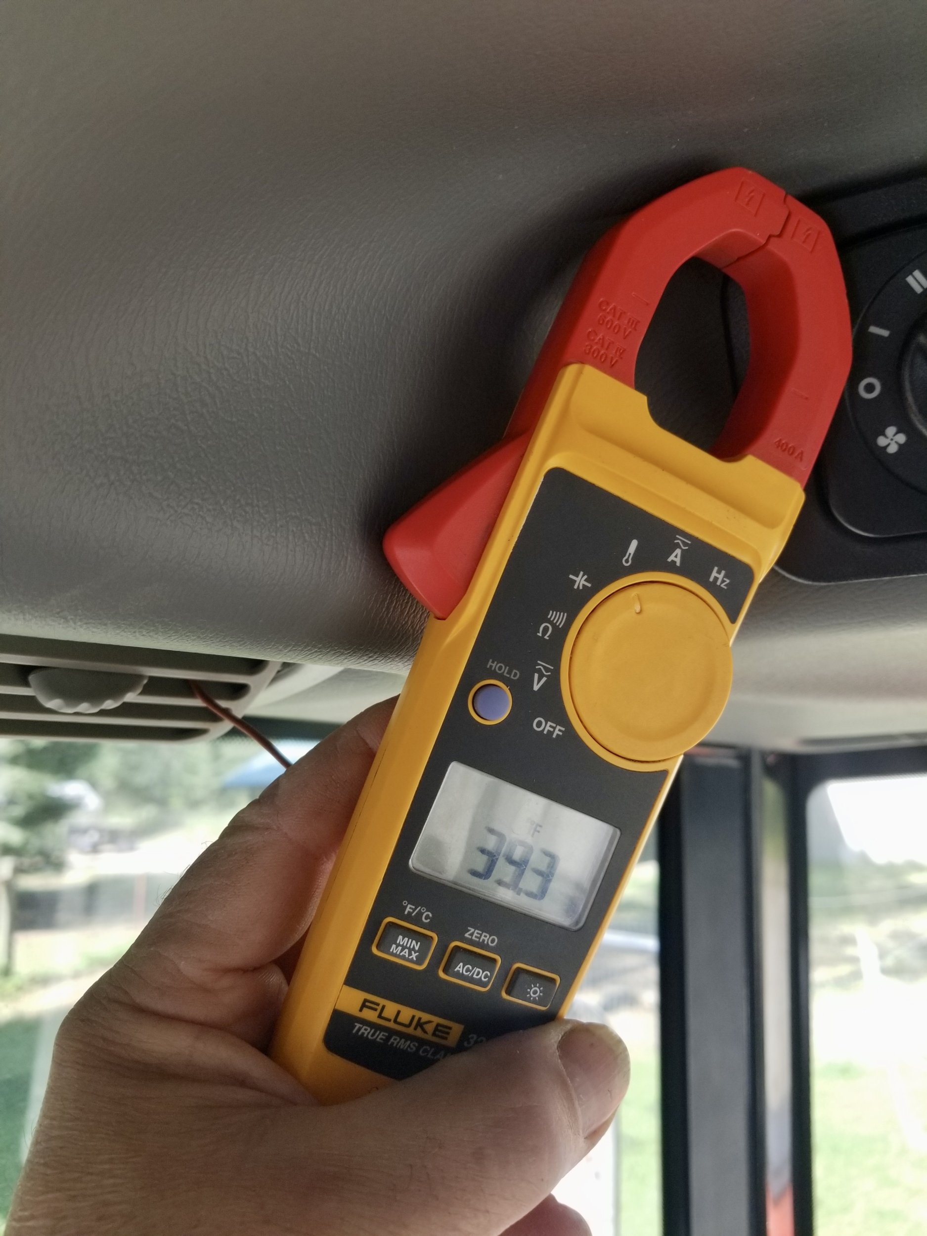

/ MX6000 Air Conditioning #37
Stick a thermometer in the air stream as close to the fan coil as possible. If it is 55 to 60 degrees it's doing all it can. Remember that heat goes to cold so mother nature trying to heat that air up as fast as possible. You probably have more heat coming in than your rig can handle.
Idont agree. Just to test, i placed my temp probe outdoors, in the middle of the cab, and i side air duct. First is outside temp.
next is mid cabin temp. Tractor is in sun and its hot today. Airs been running for about an hour, but continually opening and closing door to enter and exit to move firewood
now placing temp probe inside ducts
now, i dont know how kubota ac units relate to kioti, but mines a 2010 unit, never been recharged, 1400 hours.

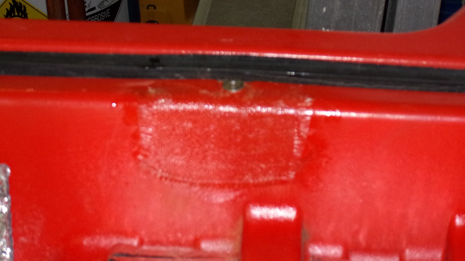

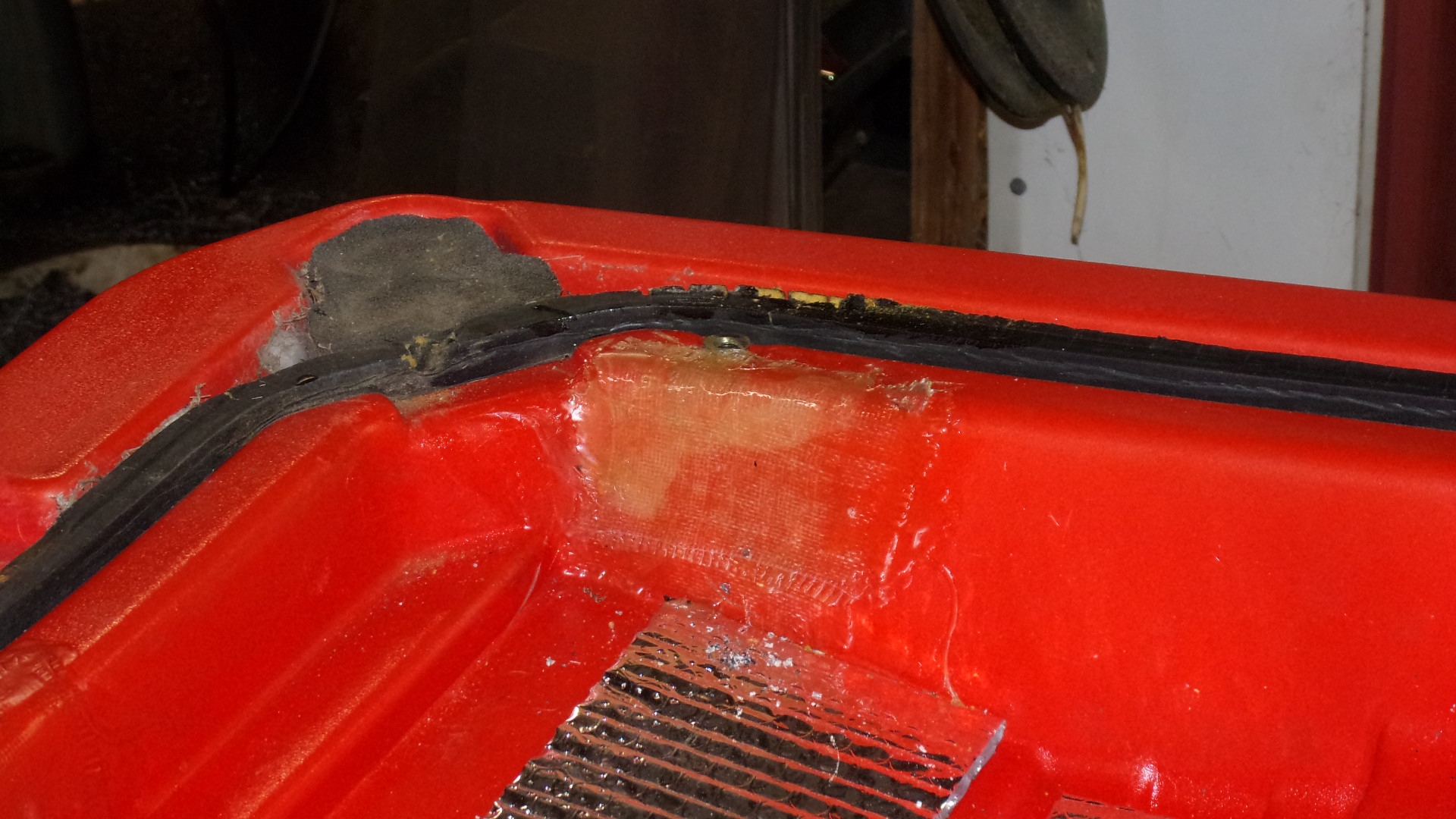

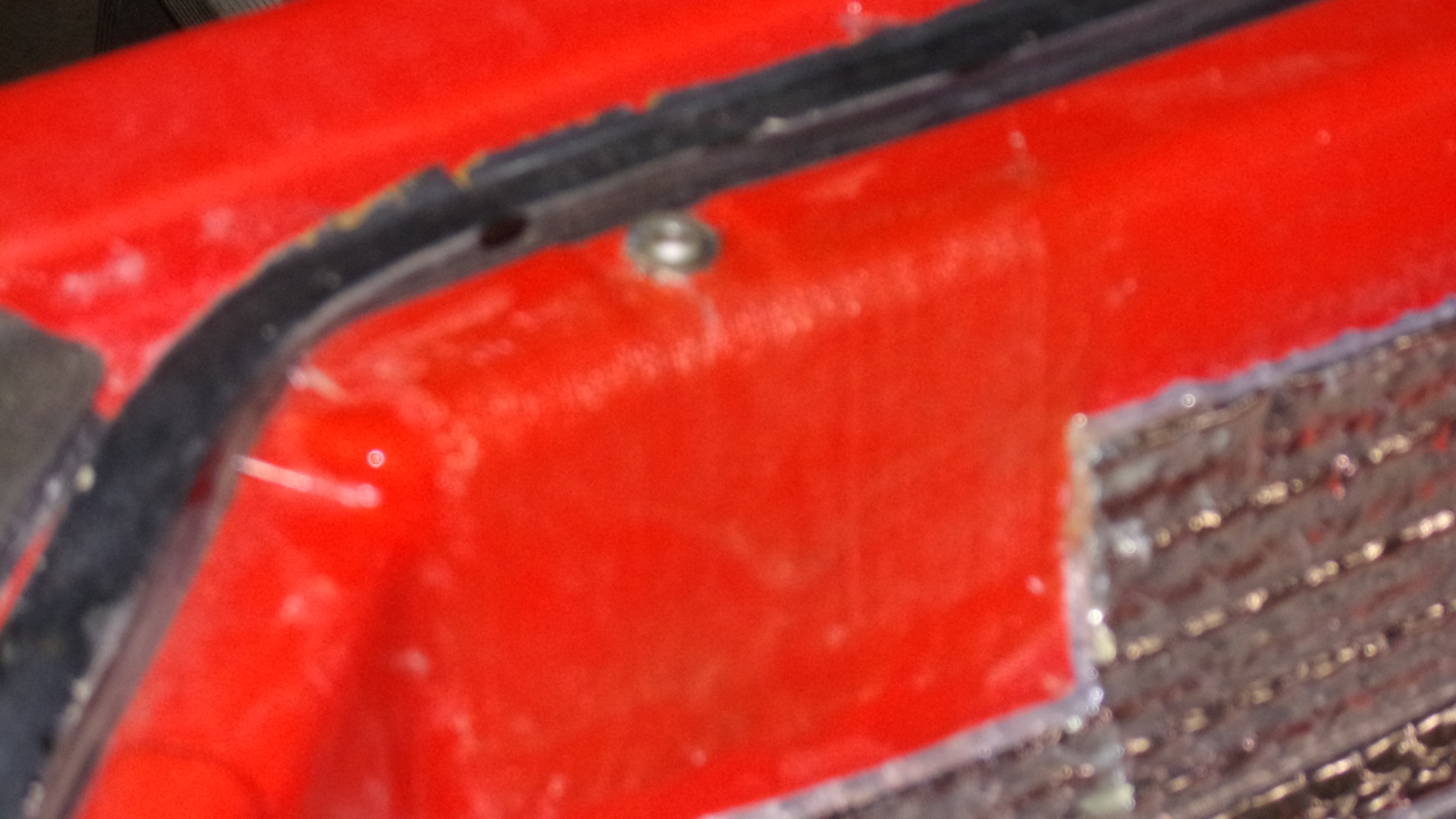

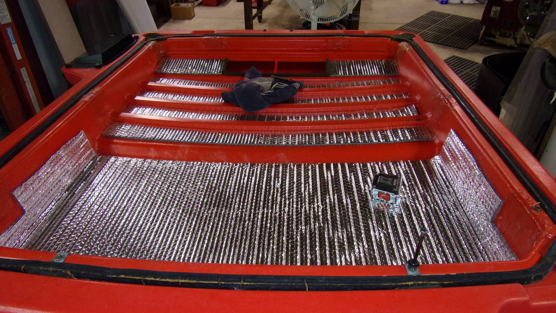

Next time you have your roof off will you take a pic for us?
/ MX6000 Air Conditioning #39
Think I have at least one... Note the condition of the gasket and why I replaced it.... Also note how I used fiberglass to really secure the Riv Nuts and eliminate the cracking.
You can also see the 2 front Riv Nuts have aluminum backers whereas the rest don't.
