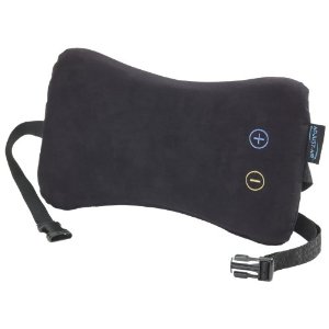

Quick update. Mowed with it for the first time today. First off, my lawn is quite bumpy in spots and I found out after hitting the first few that my seat switch was still too touchy causing the engine to briefly quit. Back to the garage and with a few friendly raps with a hammer on the flange holding the seat switch to ever so slightly bend it closer to the seat and I was good to go again.
As for the ride, I do still get jostled going over the humps and bumps, but the added damping makes the ride much more tolerable. Softer springs might be better, or just cause me to keep bouncing like warn shock absorbers. :confused2: All in all I'm happy with the mod. Now I just need to figure out how to add some lumbar support. Maybe something like this perhaps?
