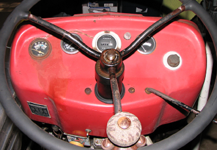

BobG, the serial number is 9A 29484. According to tractordata.com it's a 1967, correct? Is there a serial number on the engine somewhere to confirm if it's a Z134 or Z145? We are pretty sure it's not a deluxe, but rather a special/standard. There are 4 gauges, no tach and one of the gauges doesn't look original. I've posted a picture. Thanks Bob we appreciate the info and input we need to put this classic back into working order. :)

Your serial number does indeed cross to a 1967 model and the gauges seem to indicate that it is a Special which only had oil pressure and temperature gauges. Someone must have added the additional gauges afterwards. It's odd though because nothing I've found indicates that a 1967 Massey 135 Special ever existed, but that doesn't mean it didn't. It's also possible that someone may have added the serial number tag from another tractor, but you may never know for sure.
It appears that you have a Massey 135 Special which did have a Continental Z-134 engine but the engine identification numbers should tell you for certain what engine you have. Additional confirmation (Special or Deluxe) will come from the type of clutch you have. A single stage clutch will disengage the transmission and the PTO at the same time when the pedal is pressed, and a dual stage clutch will disengage the transmission when you press the pedal half way down and it will disengage the PTO when you press the pedal all the way down.

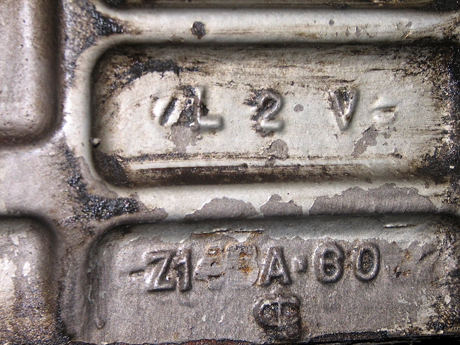

MasseyWV, this is interesting indeed, tractors do "talk." I just checked the plate near the distributor cap, it indicates this - Z134 756073, but the casting in the block, and I have posted a picture, does indicate a Z145, but with an added twist, someone had taken the time to file off the 4 and the 5, but you can just tell it was there, not sure if my picture will show that, but very interesting.
The pictures of the guages are posted here just a few posts back to give you an idea, not the best pic and we suspect some gauges are not original. The gauges are from left to right as if you are sitting on the tractor are battery, water temp, hour meter, and oil pressure. I'll double check on the clutch. Sounds like we have a "combo package" of a tractor. Being new, we knew some things to look for, but obviously not everything when we bought this little gal. Live and learn.
Thanks for your input on using oversized pistons/sleeves etc. We lean heavily towards using stock sizes too but wanted to look at all options.
That is great on the paint scheem info! Looking forward to that possiblity.
Oh Massey, I just realized I have drifted from the restoration thread.......so sorry, not my intentions, just really appreciate your knowledge.
That is interesting indeed. Since the engine identification tag is present and indicates that it's a Z-134 engine, that's what I'd be inclined to believe, especially since there are other indications that it's a Massey 135 Special.
My understanding is that the Z-134 and Z-145 engines are virtually identical except for the cylinders, pistons, camshaft, and a few other parts. That said, it's entirely possible that the factory may have used a Z-145 block casting and machined it to accomodate the smaller Z-134 sleeves and pistons, then ground off the 4 and 5 so there wouldn't be any confusion with engine identification. Granted, it's just a theory but it makes sense considering the circumstances.
   / My 1966 Massey 135 Tractor (Pics) #427
