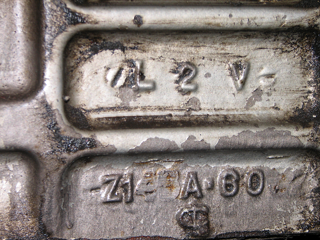

To positively identify your engine, look for the aluminum engine identification tag which is riveted to the block and is located just above and to the right of the distributor. It's possible that the numbers may be worn away or the tag has been painted over so another way to identify your engine is to locate the engine identification numbers cast into the side of the block. They should be located on the lower half of the engine, just below the distributor. For example, my engine says "Z145A 600".
Keep in mind that both the Z-134 and Z-145 engines use the same cylinder head so you can't positively identify the engine by using the numbers cast into the head. For example, my cylinder head says "Z134 A801" but it's a Z-145 engine.
I just checked the plate near the distributor cap, it indicates this - Z134 756073, but the casting in the block, and I have posted a picture, does indicate a Z145, but with an added twist, someone had taken the time to file off the 4 and the 5, but you can just tell it was there, not sure if my picture will show that, but very interesting.
Curiousity got the better of me so I did some additional checking to see what I could find and it appears that your tractor is not the only one to have had the "Z145A 600" numbers changed to read "Z1 A 60 ". That said, I now believe it must have been done at the factory because it's highly unlikely that different owners would take the time to grind away the exact same numbers. The following is a link to a forum thread where another Massey tractor owner mentioned that their Z-134 engine was marked with "Z1A60".
Today's Tractors :: View topic - ID my tractor
The numbers cast into the block of the original Continental Z-134 engines usually read something to the effect of "Z134A 500" but the Z-134 engine was eventually replaced by the Z-145 engine. That said, since the Z-134 and Z-145 blocks are virtually identical except for the size of the bores that were machined into them to accomodate the cylinder sleeves, I believe that the factory must have used Z-145 blocks as a foundation to make Z-134 engines during the later production years where the Z-134 engine was used. The casting numbers were probably changed to avoid any confusion with engine identification.

Oh this just gets more interesting! Oh I can't wait till hubby gets the block off to see if we have single or dual clutch in there. Another twist MasseyWV, hubby reminded me the other night and I totally forgot that the former owner had worked on the clutch system and told us it was a two stage clutch and that he had a hard time getting everything lined up due to having two clutch plates. So a 1967 with a Z134 engine, and a two stage clutch, hum and so the mystery goes. The tractor as a whole looks so original to us, even all of the paint, no repaint or bondo on this 135. But our 150 is a different story. Will keep you posted on what we find out when he pulls the block off. Thanks
