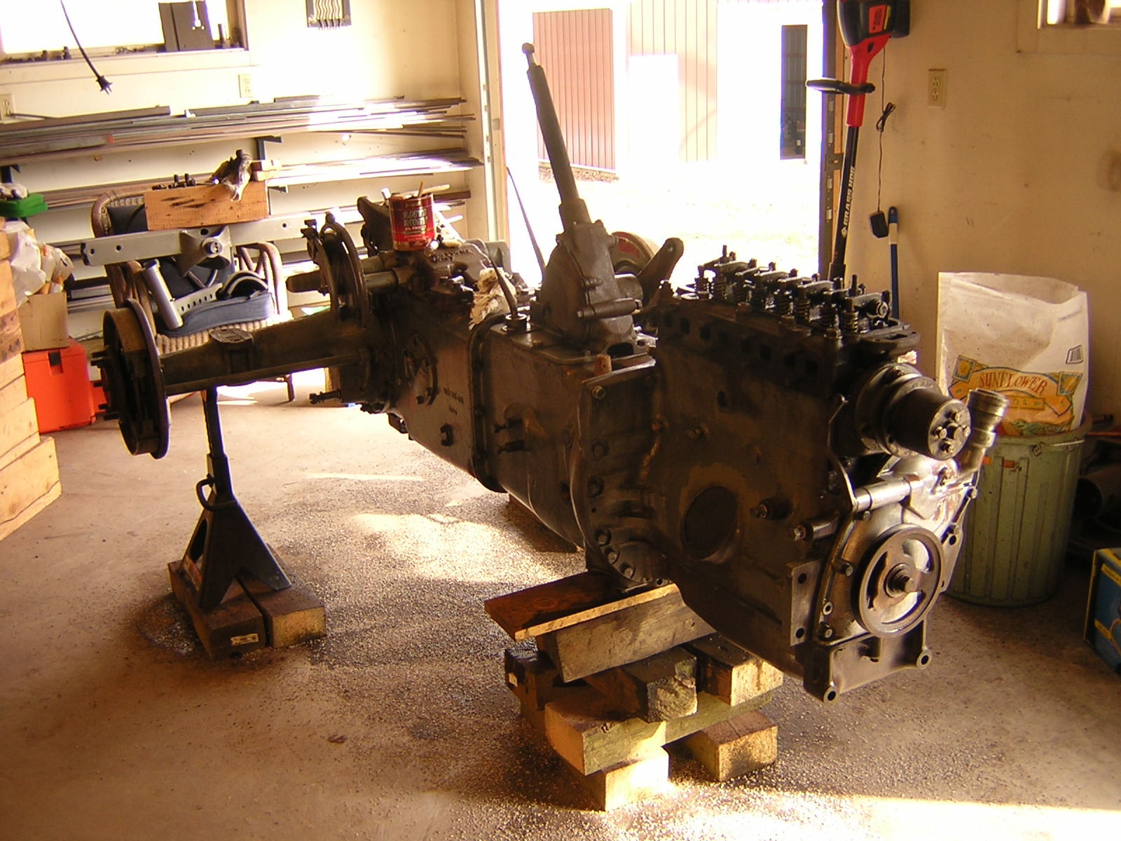

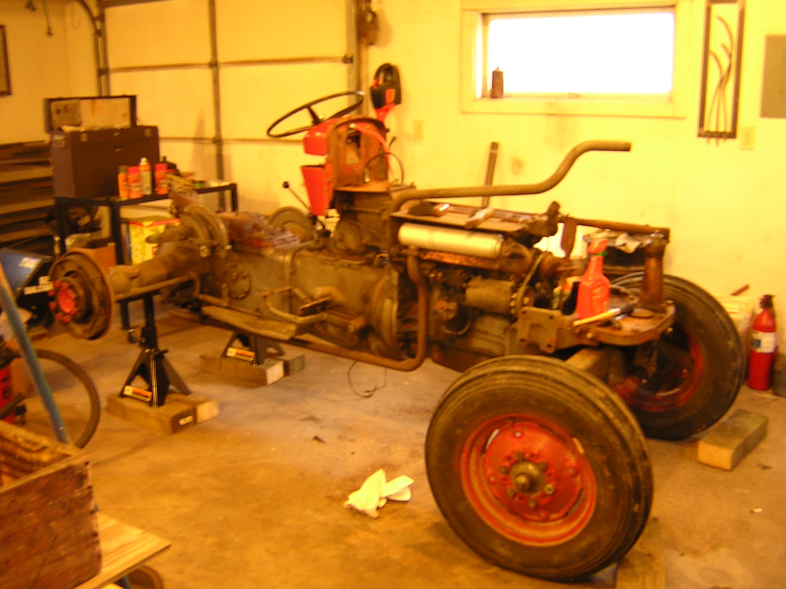

   / My 1966 Massey 135 Tractor (Pics) #57
