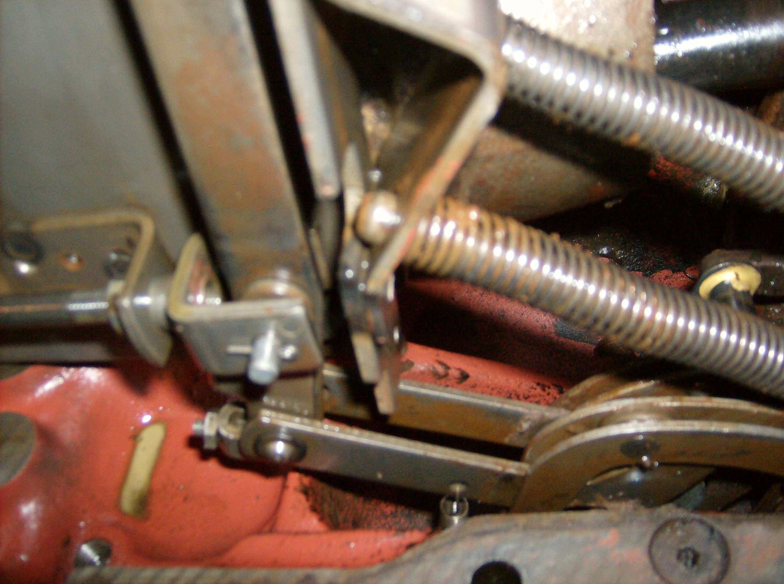

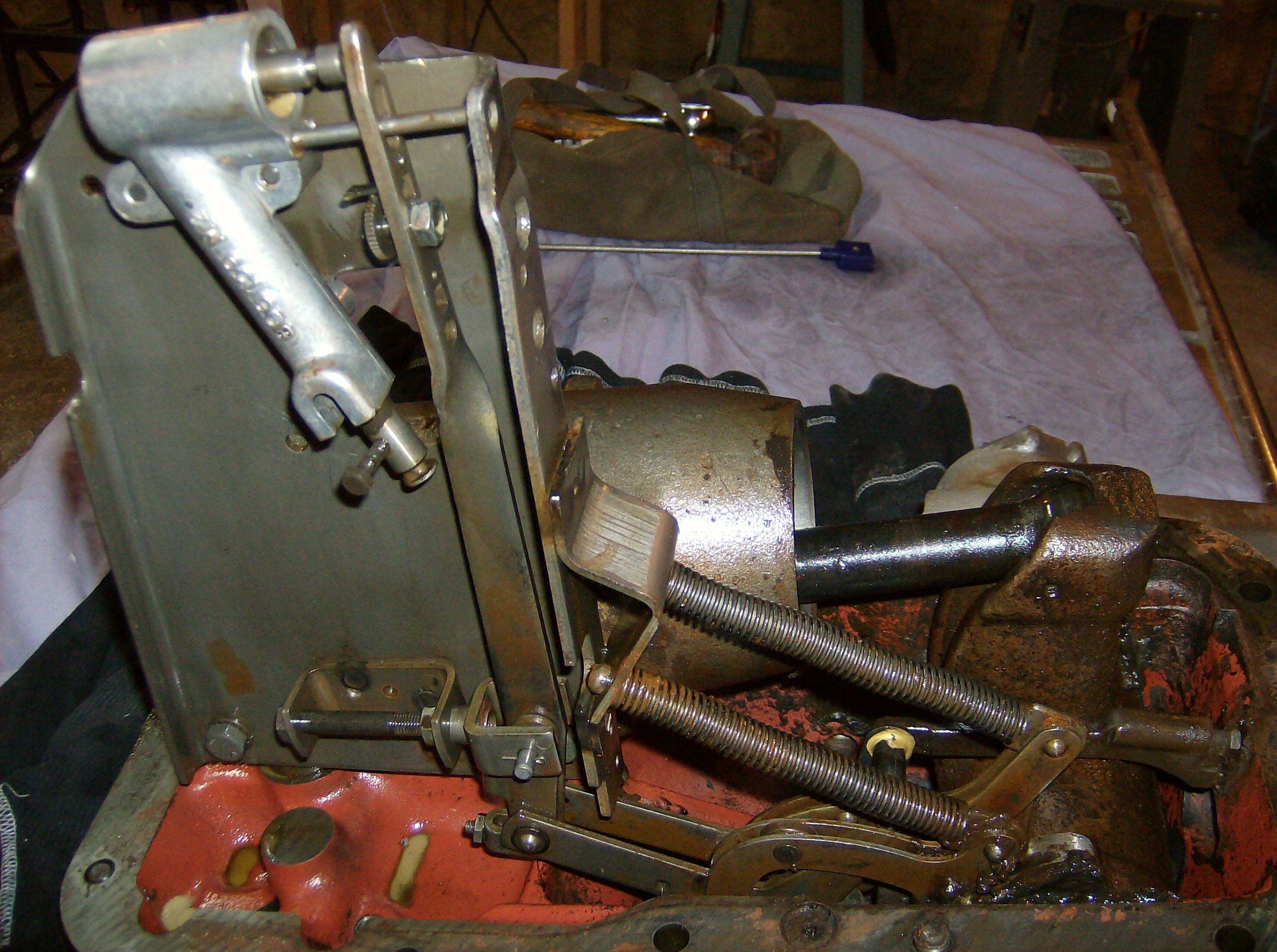

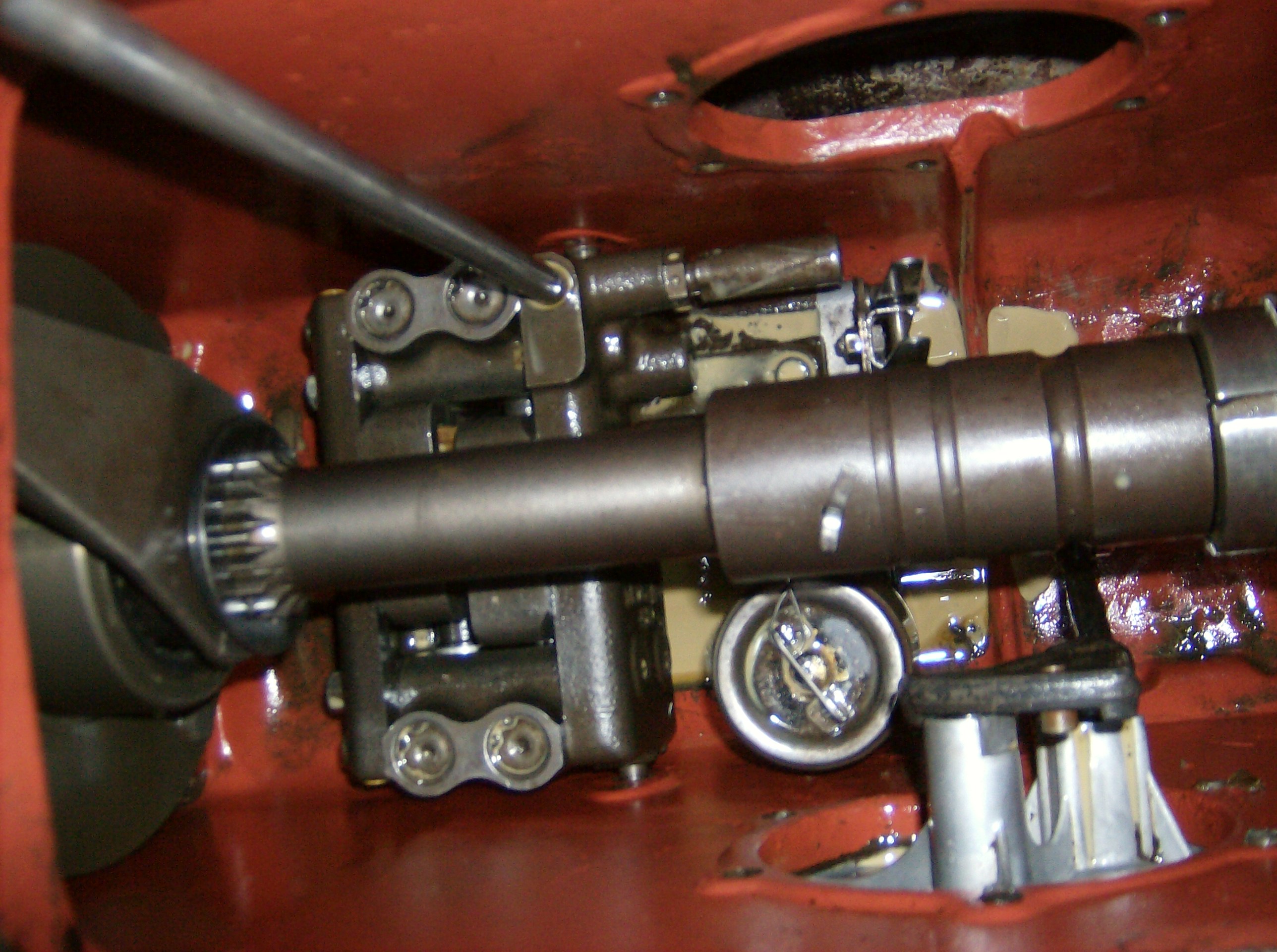

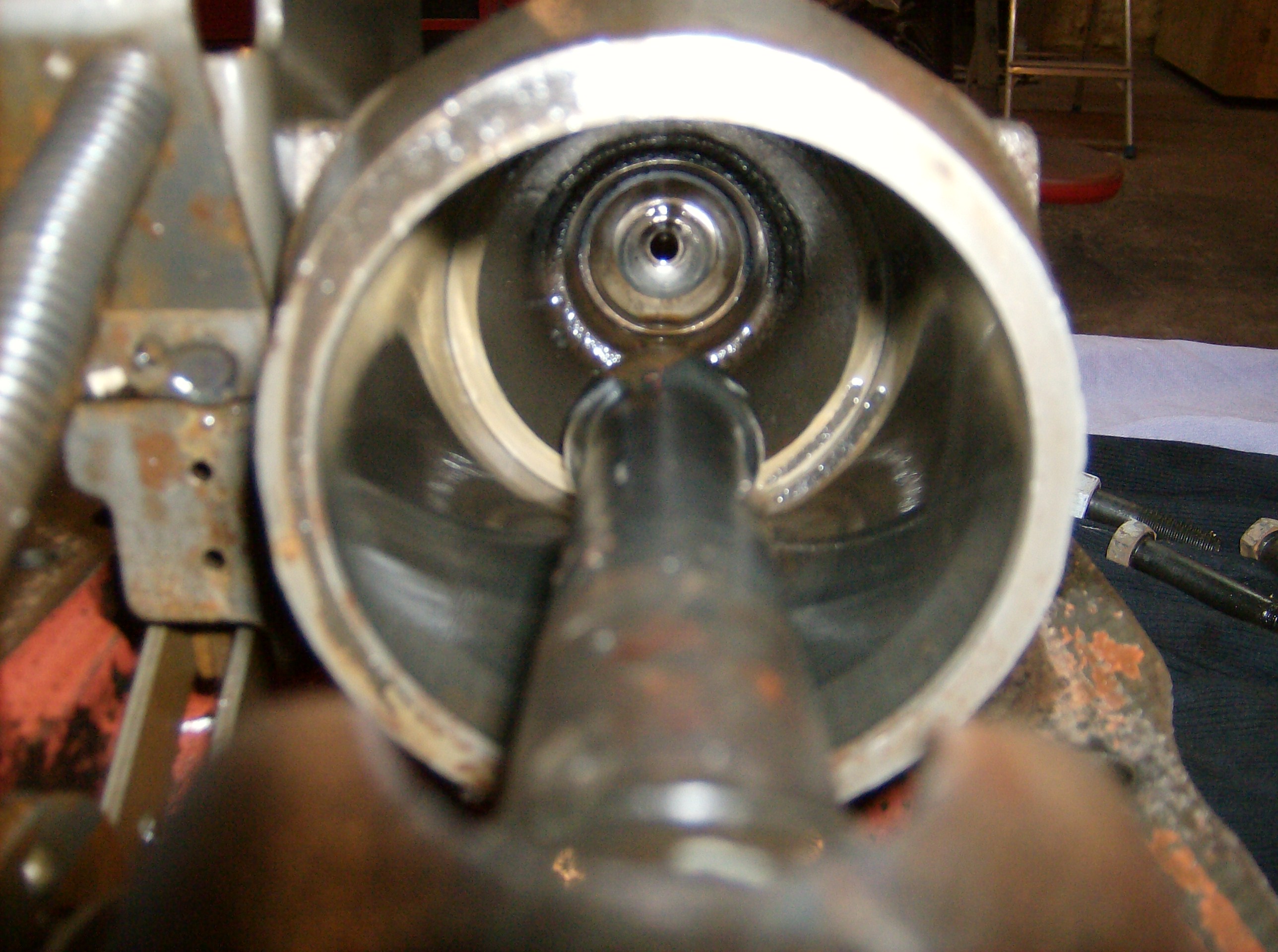

As you stated your oil is nice and clean but do you plan to remove the aft cover to expose the pump / filter and check the linkages and lift cylinder or do you plan to wait until the next phase of the rebuild. I decided to do mine after realizing the oil had been contaminated from a split shift lever boot, only to find that the pump standpipe o-rings had failed and over lubing the three point arms had contaminated the oil with grease. The filter was a mess.
After rigging the levers, replacing the o-rings and flushing the oil I was amazed at the difference, made lifting 10-12 foot 20" white pine and spruce logs onto the mill a piece of cake where it was all the old girl could do prior to my doing the work.

As you stated your oil is nice and clean but do you plan to remove the aft cover to expose the pump / filter and check the linkages and lift cylinder or do you plan to wait until the next phase of the rebuild?
Since the fluid is clean and the hydraulics seem to work fine, I was planning to wait until the next phase of the rebuild. The hydraulics do bleed off in about 15 minutes if the engine is off, but I've read that it's common so it doesn't cause me much concern.
   / My 1966 Massey 135 Tractor (Pics) #76
I've read the same, bleeding off is normal and if you've not had any issues with lifting power you shouldn't have any issues.
