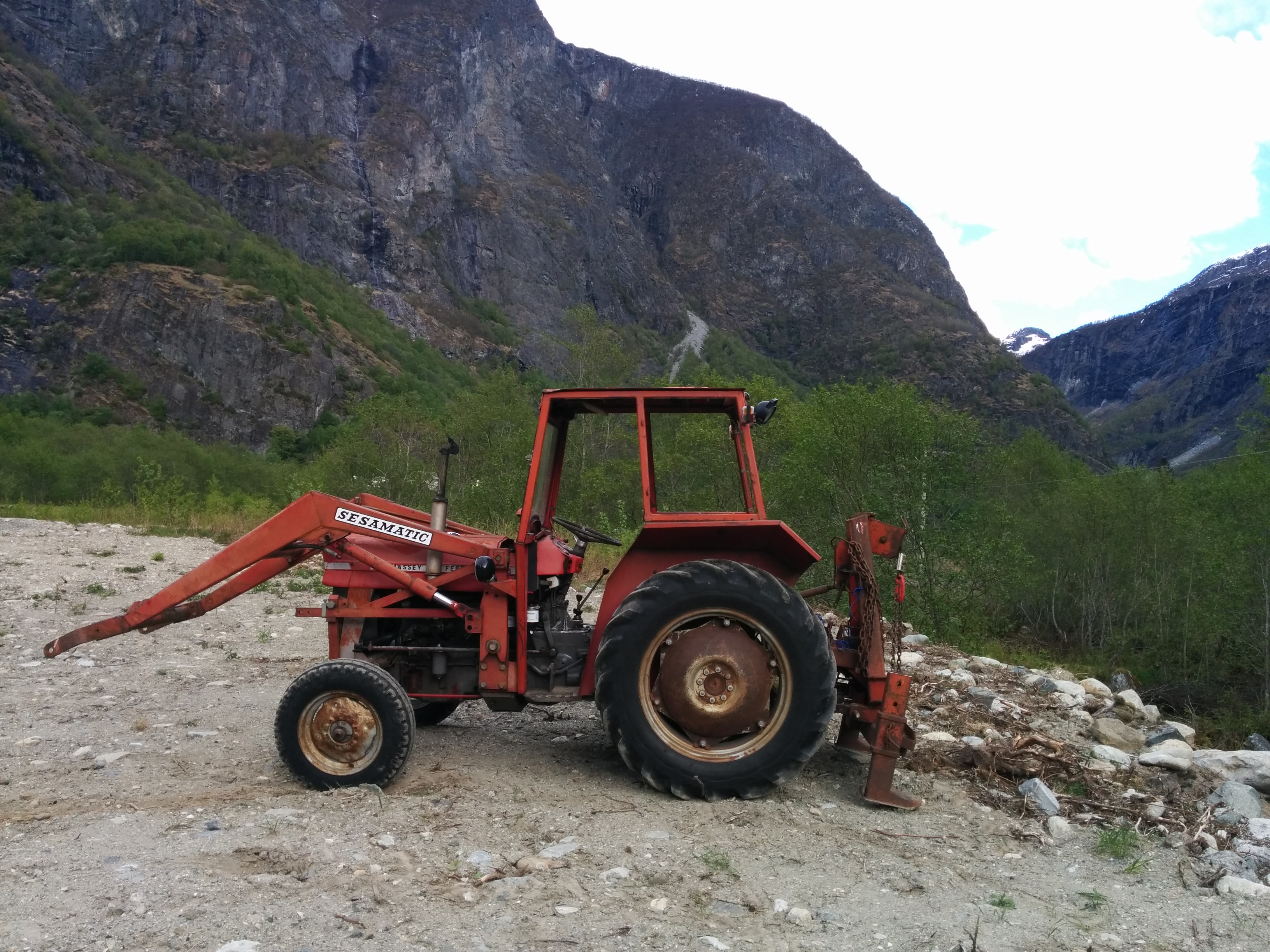

That seal is really quite easy to renew. Check the bearing preload while its apart - you might need to remove one thin shim to compensate for a little wear in the wheel bearing. Also, apply a thin film of sealant between each shim, and don't tighten those perimeter bolts super-tight - they don't seem to come loose, but, especially on early 35s (and previous models) with only six bolts, the occasional one fatigues and breaks. :rolleyes: If they all break ... the axle and wheel leaves the rest of the tractor. :eek:
   / My 1972 Massey Ferguson 135 diesel
#22
I have to google the subject a little bit before I start taking it apart :)
But thanks for the tips :thumbsup:

Did some wood transportation today! Filled the trailer to the rim, but it was no math for the 135!
The diff.lock worked perfect too :cloud9:

I was smiling the other day when I hauled the trailer, full of wood, up a steep tractor road :) I engaged the diff lock and it pulled away easy as nothing :thumbsup:
Good tip about the coolant, I'll check it tomorrow :thumbsup:

The easiest way to do this is to take some drops of coolant, bring it to the nearest car workshop and ask mechanic to check the density with refractometer. Usually I'm doing it this way once a year in autumn. The lowest coolant temperature according to the density at you region (since you are not in the North of Norway) should be -21C.
