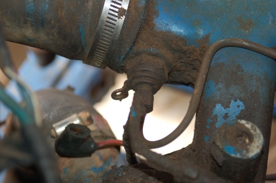

View attachment 312301View attachment 312302
One photo depicts the plug under the Glow Plug (?) in the intake manifold and the other photo shows that the wire goes to the ignition switch (Red wire on the left side of the switch.
the picture on the right certainly looks like the thermo start electro-thermic unit to me.., Put a volt meter on that wire and make sure it goes to 12 volts when the key is turned to the left one detent from the central off position. If you get power, then go a head and hook it up and you should be back in business... She should start now...

I took off the hose between the intake manifold and the air filter pipe to expose the thermo start electro-thermic unit. I turned the key to the left and it started smoking then quickly produced a flame. This happened 2 or 3 times. Working on cars for the last 34 years I figured engine plus flame usually don't mix.
I removed the thermo start electro-thermic unit and sprayed it with Gum-out then blow it out with compressed air, re-installed it and started over. This time it heated up without the flame. Must of been real dirty.

I disagree about the thermostart it works by heating up, unseating a ball and literally catching the diesel on fire- that heat is pulled into the first cylinder on the intake stroke and the heat (fire helps start the combustion process.
I just had to replace the one on my Rhino tractor because it wasn't getting hot enough to produce flame and therefore had to use the block heater to get the engine warm enough to start....
I can actually hear both tractors intakes ,catch -fire and then crank the engine and that's when the cylinders start to fire and the engines start.. you have to remember diesel does not burn like gasoline, and you only need to do this unti the engine starts... if it weren't for thermo starts my tractors would be sitting a lot more of the time... anyway you will really like that 2000 once you get used to it's (personality):thumbsup:

Yesterday after I posted my friend came by who’s more familiar with diesel engines then I am. He spent about 30 minutes playing with the ignition switch going back and forth between left and right holding it in the glow plug position then trying to start it when it finally started.
We used it all day turning it on and off when we needed and everything was fine. This morning I was dredging the disappointment of it not starting again and just went for it.
I went out turn the key to the left without cranking it counted to 20 then went right and she started on the first try.
We drove it around turn it off and started it again with no problem.
