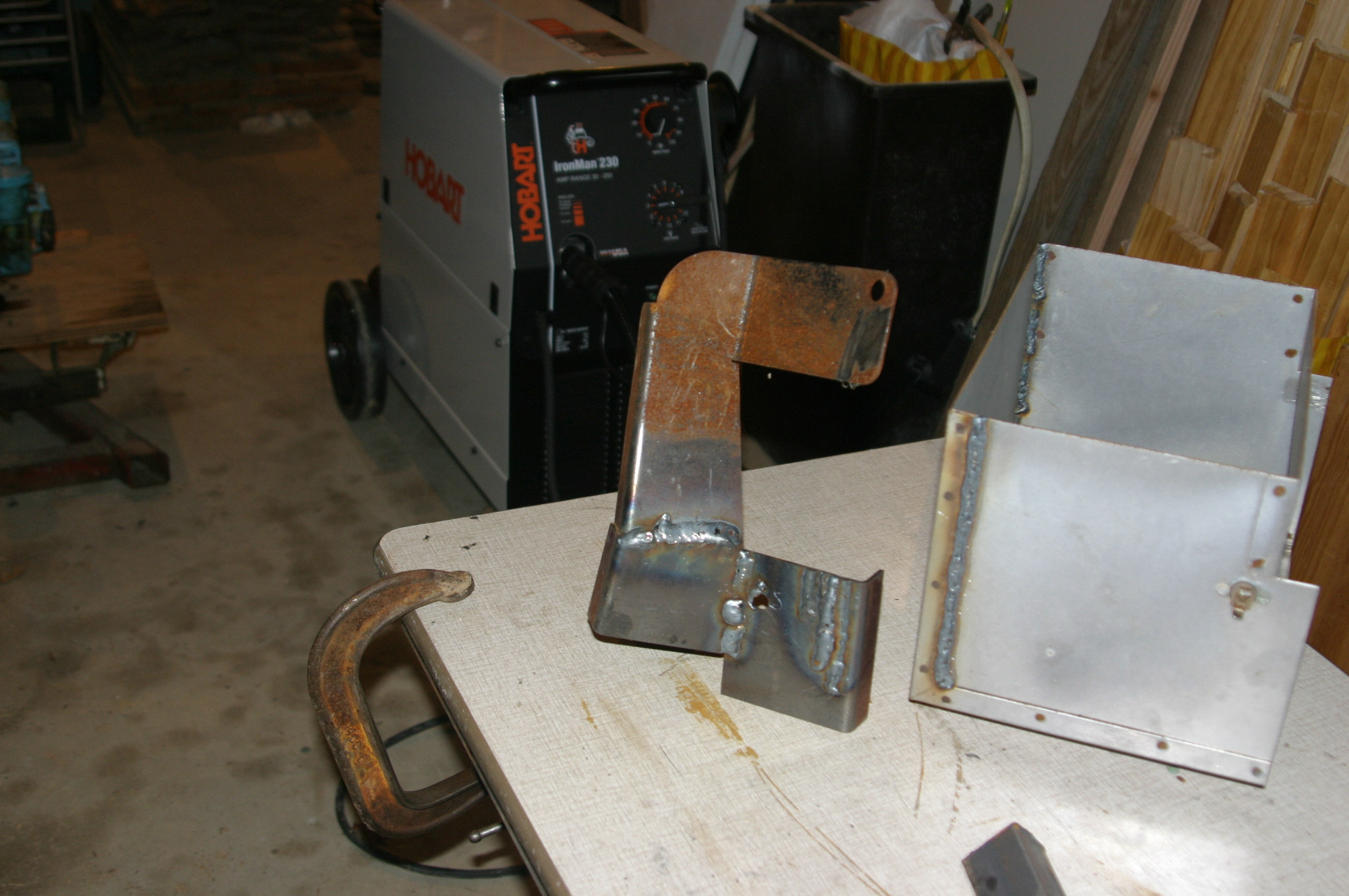

Yes turn both up! If you're right handed, place the gun back even with your right shoulder, bend your head down in front of the gun. Do you have the contact tip sticking out from the nozzle a little bit? Note the chart I posted.
Here's a Mig weld I made for a test I posted here, see how hot my weld is compared to your's?
Yeah, no doubt you can see the heat, much smoother! The tip does stick out a little, there's no adjusting that, is there?

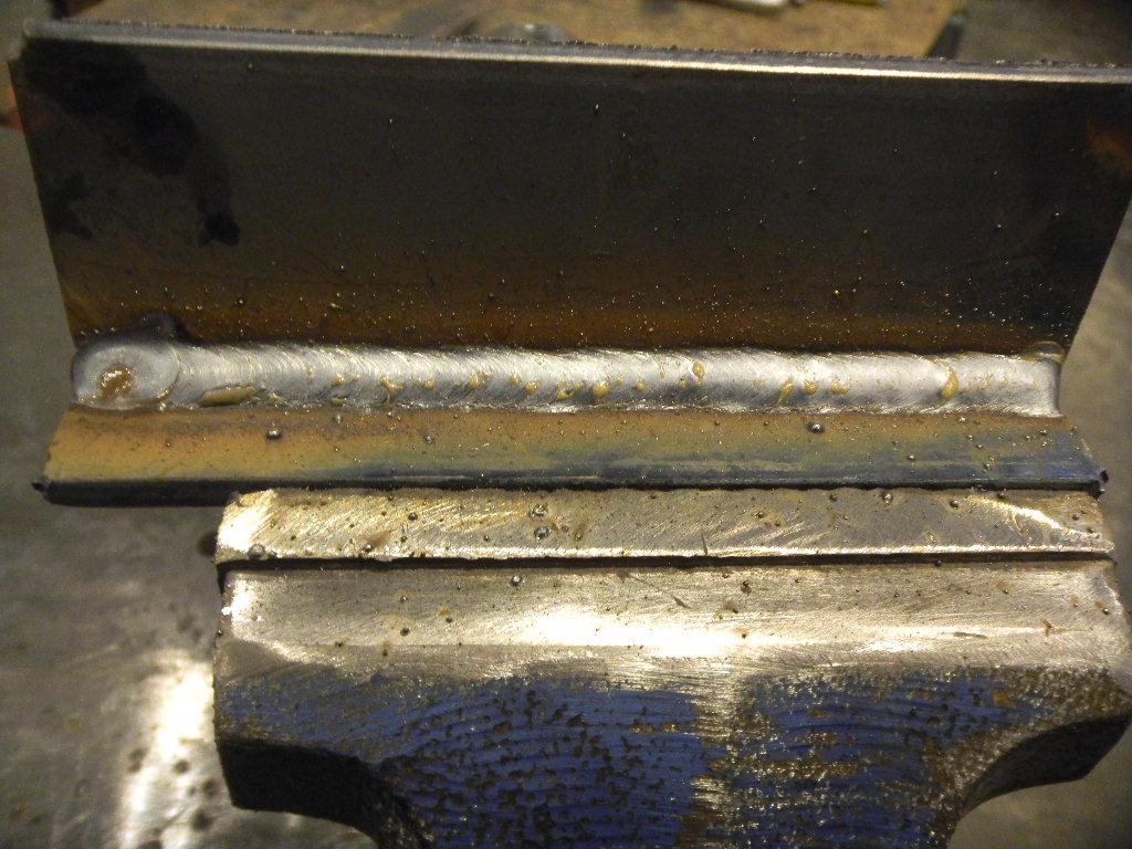

This is the extent of my MIG experience to date:

Looking good so far. Try some "pushing" and see if you think it will help you to keep it "on-road":laughing:
