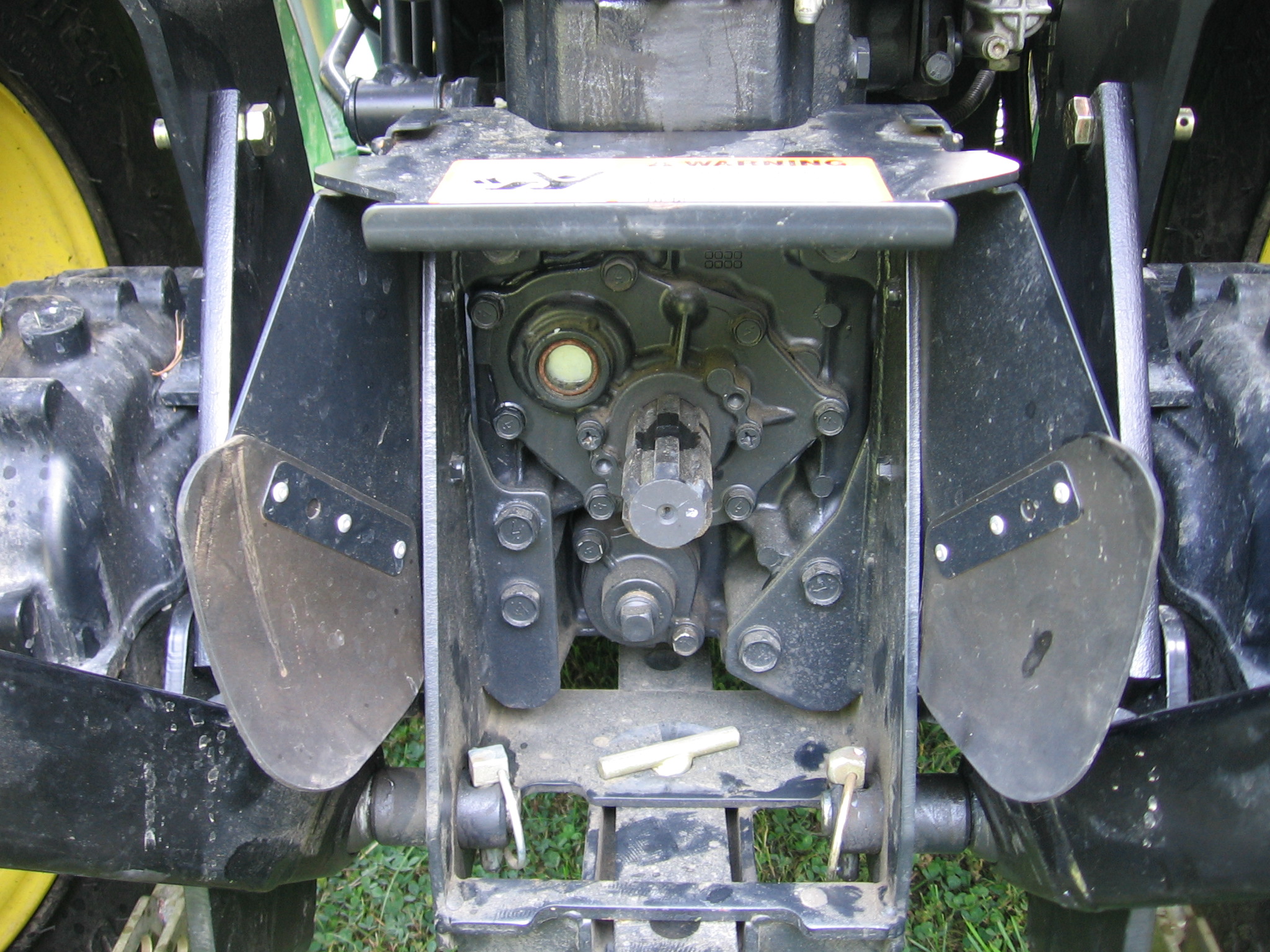

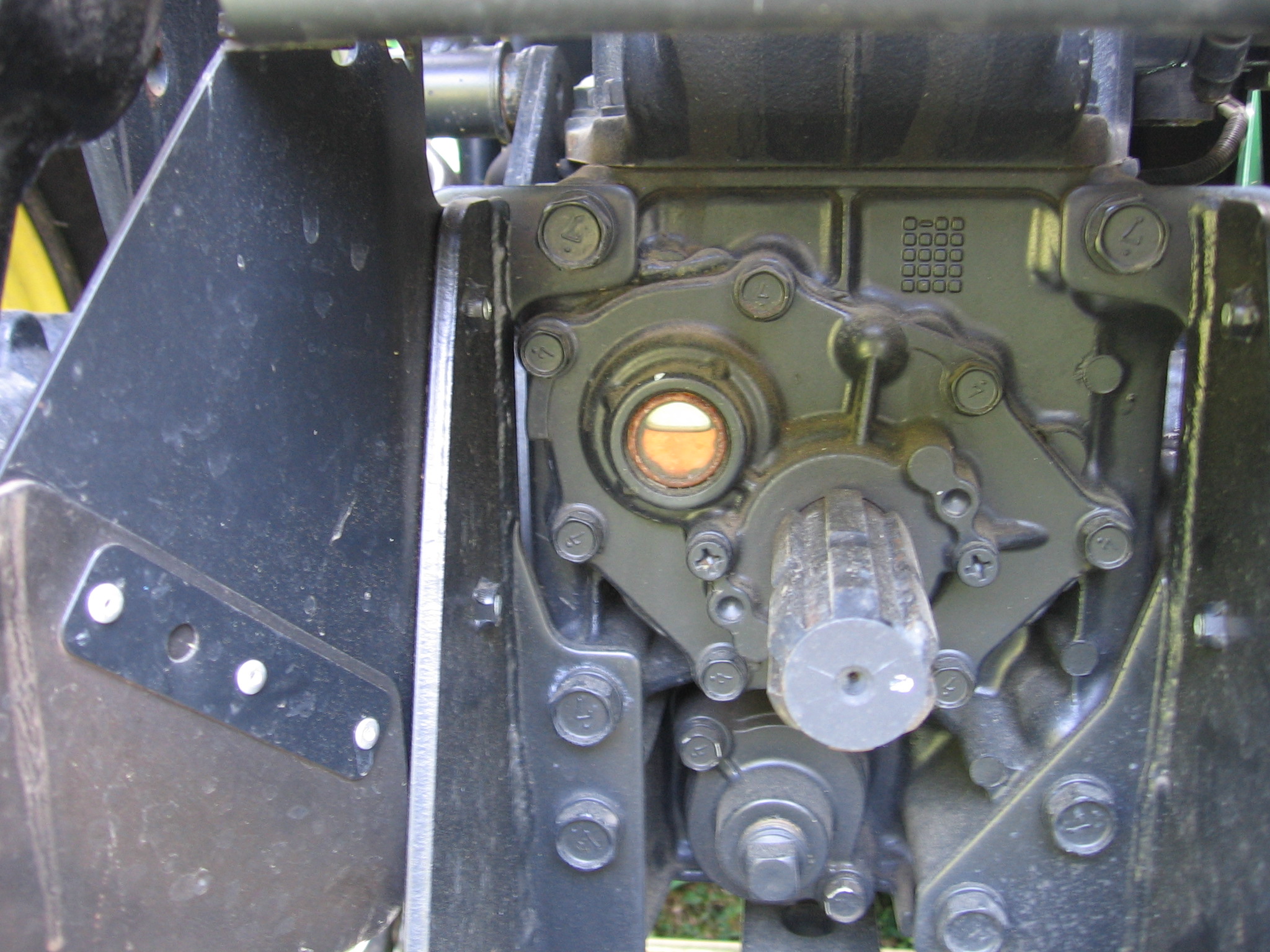

Hey Tom,
Glad to see you are GTG now.:thumbsup:
the sight glass shows full when it is sitting but not once it is running
To correctly check, tractor has to be shut down, and all the hydraulics have to be relaxed. Fel on ground all cylinders retracted,3PT lowered. Then see what is in the glass or on the dipstick.:)
This is with my 3PT raised and then lowered.......big difference.
Greg

Hey Tom,
Greg
Mine shows full when sitting with the 3pt up but when he ran itup the driveway it was showing empty is.that normal then?? It seems that if it was empty it was low....???

So is it normal while running that the sight glass is empty?? Just seems lime there should be something in it while running.....
   / My 2520 broke today... #34
Tom,
Empty glass while running is normal.:thumbsup:
It seems weird,but when it's running the tractor is "using the fluid",so it's not going to show
a full sightglass.
Greg
