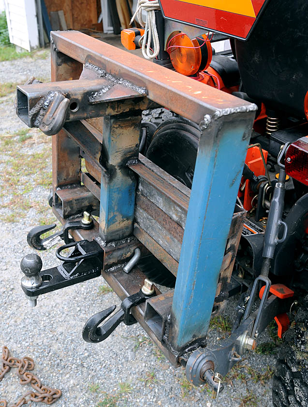

Now just weld some hooks on and get a hook for reciver and you can pull trees or post out of ground.

meanmerc,
You might try bolting the receiver to the underside of the drawbar, then you can use a plate on top w/the same bolts to weld the upright bar to. That's the way I'm thinking I should have done it, since the ball is a bit higher than I anticipated.
Then you can unbolt the receiver anytime to move it to your bucket if you like.
Jim
I got the same idea, I already bolted the receiver to the drawbar now just have to weld up the up bar but I've been hesitating now cause I might use that receiver and bolt it up to the bucket (FEL) instead!!!:confused:

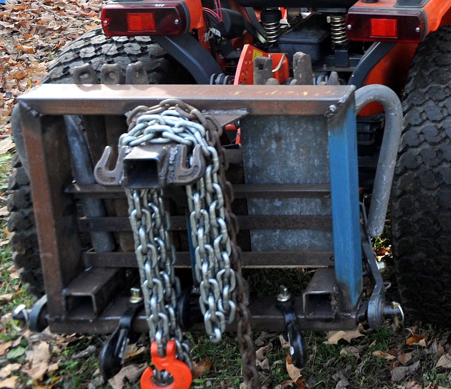

This is what I built last Summer. Hauls trailers, pulls logs and it serves as a weight box as well. I can add 600lbs of ballast on the 3ph that is including the weight of the contraption.
