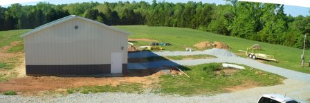

So here is where this stands today. I still have final grading to do, I'll do that after the solar project is done since a lot of that is seat time in the cab loving my TnT and iMatch.
The 1st picture is a stitched shot of what it looks like today. The hay fields are coming in just great.

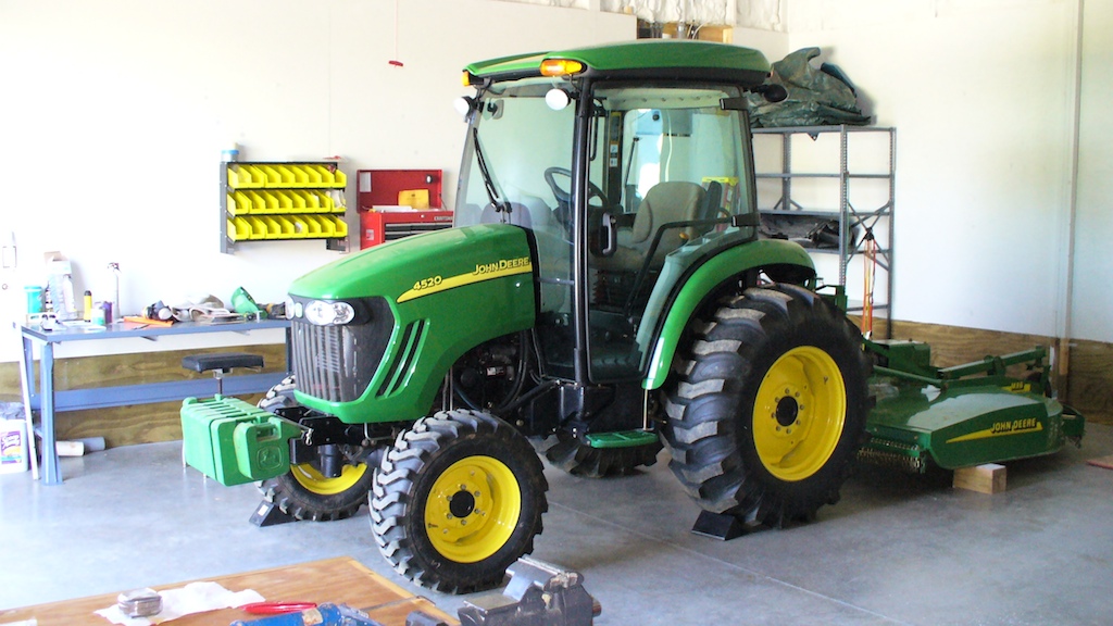

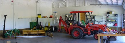

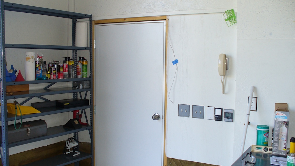

The next three shots are the interior with some junk errr? stuff moved in. I assure you it will never look this clean or uncluttered again. And those empty shelf spaces will fill up with time. And the last shot is the new riding lawn mower. I had door openers installed so I can open the doors from inside the cab. Put in all the wiring for it, AC and low voltage during that phase. Nothing makes me work harder than something that lets me be lazy.
I also beefed up the PT plywood behind where the MX6 rotary cutter is. Added 2x4 supports, boxed it in, and used a piece of 3/4 PT plywood. That way, when I back the mower wheel into the wall some day it won't take out the back of the building (I hope).

It looks like you are building driveways with your rock. I think that in time, those grass areas between the rock will just become a pain to maintain without any benifit. You might consider rocking it all in solid to increase your parking area and have less grass to maintain.

Eddie: Tnx. The change over between grass and gravel is always a problem. I've tried the plastic edging, but things settle too much to make it mowable. If the grass area between the driveway is a pain I'll boxblade it up. I was hoping it might work as a big welcome mat where I could wipe the mud of my feet. Time will tell. Around the house I used landscape timbers between the pea gravel boarder around the house and the grass. Works OK, just a bit costly and more work to put in. When the final grading and landscaping pix are posted, I look forward to your comments on all this.

There is a sensor on the people door for security. There is a speaker that is part of the whole house automation, so I can hear what's going on. I have wires for a video surveillance camera inside the building and outside. You saw the phone by the people door in the pix. I also have a temperature sensor for the building. Here's a shot of how the building temperature vs. outside temperature did for the last 24 hours. This sensor is also used for fire detection. I also have a 12 volt power feed for the cameras and other automation electronics down the road. There is a CAT5 for the wifi hot spot for the garage. There are 3 spare CAT5's. Finally, the wires for the automation for the solar project are there.
