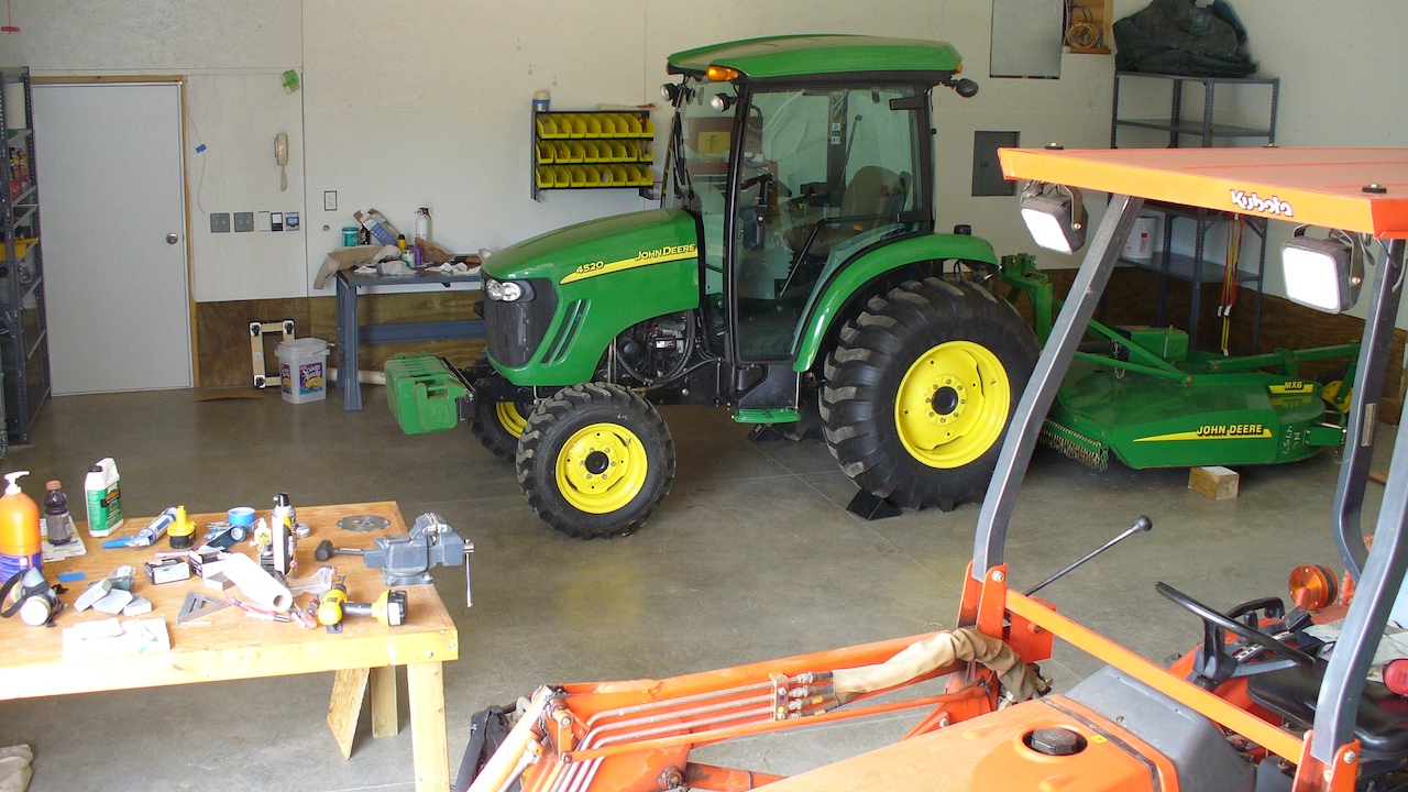

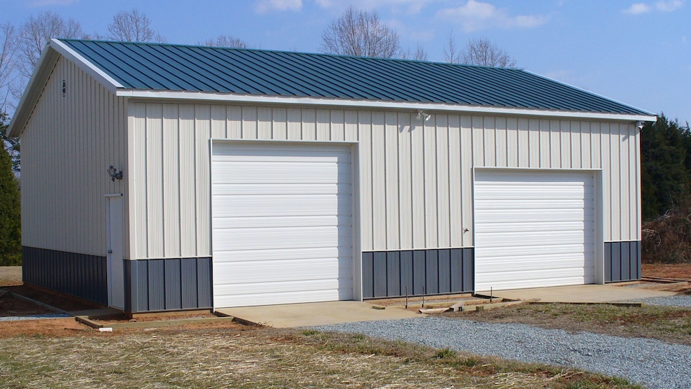

Your building turned out great! I am looking to build the same size. Would like to ask a couple questions.
Do you find the 30' depth to be enough since the garage doors are on the side?
(Guess I am trying to decide between placing one larger door on the end or two on the side. Pickup, CUT, lawn equip, trailer etc.)
Do you have any pictures of the building from the side (showing garage openings)?
Thanks Paul
   / My 30' x 40' tractor garage
#38
I had a shot of one side of the inside in the thread, here's a shot of the other side where the riding lawnmower is parked. You can see how the JD 4520 with MX6 6' rotary cutter fits in the 30' space. I have the 4520, the Kubota B21 and my JD 3189 GT in there and there is lots of room. You list of equipment seems tight for 30 x 40. As for the "Is 30' enough" well no such thing as too big except cost, so YMMV. 30' and the side doors worked great for me. The 12' door lets me use that one door for the B21 CUT and the 318 GT.
I'm getting a quote on another building, and one thing I found out is that the incremental cost to go to a 9' door instead of an 8.5' door is under $100. So on the next building, I'll have 12' wide by 9' tall doors.
Before I decided on this configuration I made a plan to see if everything would fit. Side doors work for me. Snow is not an issue for those of us in the South. I'd start cutting out paper bits that are to scale for your equipment and see how it all fits together. I have some of my implements on dollies to help squish things in. Good luck and have fun :thumbsup:

   / My 30' x 40' tractor garage #39
Pete,
Thanks for the info and the additional pictures. I think the 30' depth will work for me as well. I like the side pic showing the doors. I can see how it would be a real advantage having the 12' door, but I am thinking I would like the added height of a 10' door. If I had the tractor loaded on the trailer I believe I could pull the loaded trailer inside with the added height.
I am trying to understand the advantages of using a pole structure versus traditional stick framing since you were pouring the floor? I don't know the exact cost but seems to me it would be about the same? Just curious.Thanks again.
   / My 30' x 40' tractor garage #40
Poles in the ground are always going to be cheaper. Less lumber, less concrete and a lot less time. Even with a concrete pad, it's not structural, and there isn't a footing , so there is still a lot less concrete and rebar used.
You can also go taller, easier and cheeper with poles then you can with stick framing.
