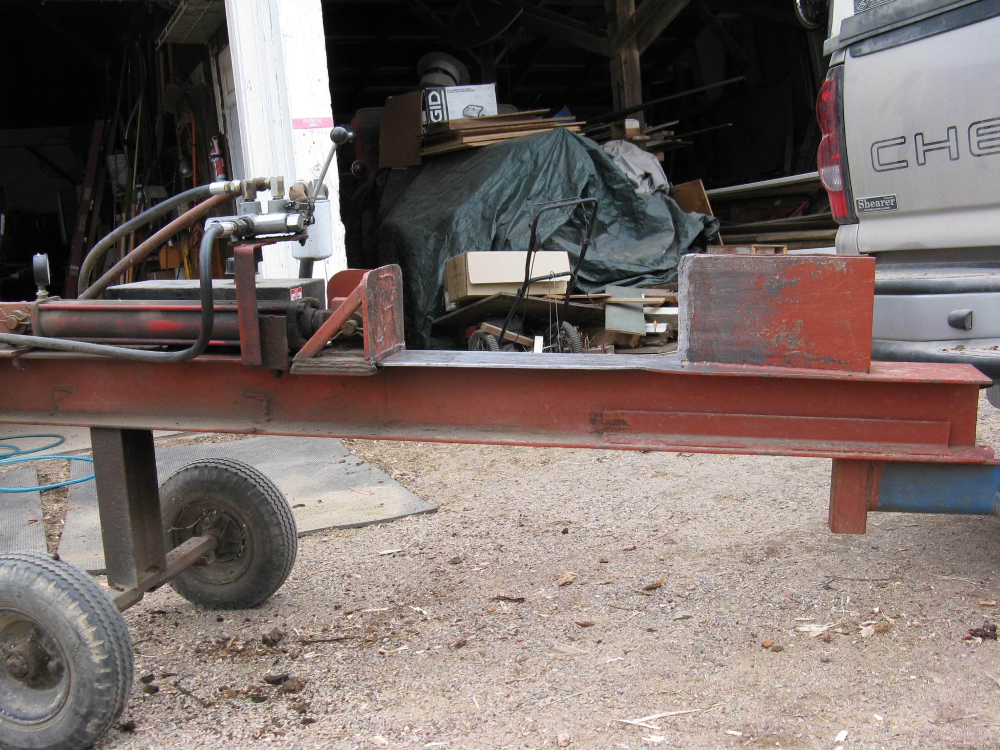

This wood splitter is built with a H beam. It is a light weight 6'' x 6'' H beam and you can see the flange has been distorted by the push plate. The wedge end will flex when splitting hard to split wood.
When I built my wood splitter I used material I had. The bottom of the beam is 4'' round with 1/2'' wall (it came off a Fox corn chopper). The web and top flange was built with 12'' c channel cut in half and welded to 5/16'' x 6'' flat bar. The top flange is a little over 6'' wide and the profile is like an I beam. My wedge is 10'' high and I have a 4.5'' cylinder. It has worked very well.
If you add a tall wedge (with a 4 or 6 way split) expect more stress on the beam.

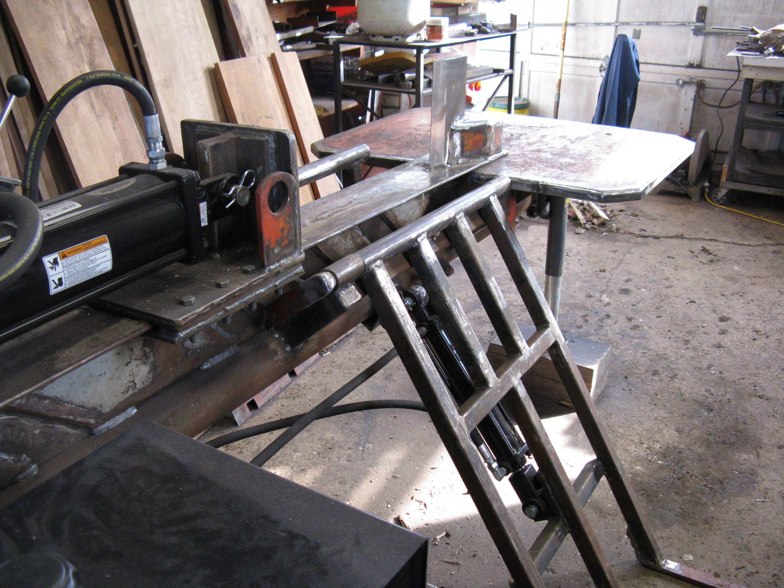

I hope you like the 45 degree side tables. I like some flat area to rassel the bolt around to get it aligned the way I want. Of course I just have a single wedge. A six way would probably mean you don't need to.
I have a 5" cylinder using about 32" of stroke, and a 13 gpm pump. Cycle time is a boring 22 seconds. Yours sounds much better!
Keep us updated: this is real interesting.
