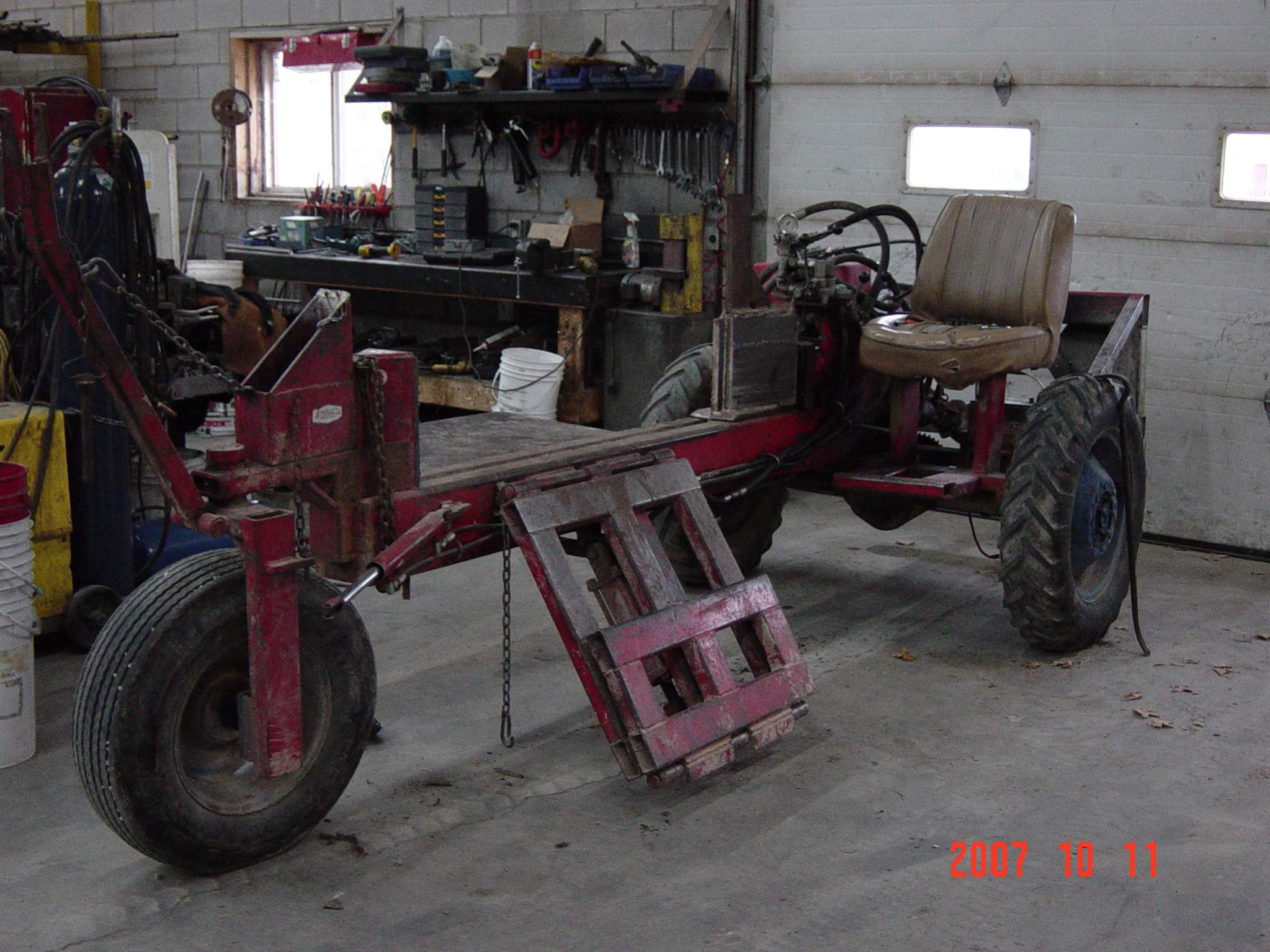

The cylinder attachment point is something I've second guessed. Here's what I have so far.
I used a piece of 9.5" wide 1/4" plate that I welded on 4 sides. I also cut 2" holes in the center of the plate that I welded around.
Over that I use 6" wide 1/2" flat stock, the entire perimeter is welded to the 1/4" plate.
Then I put some 1/2" flat stock on the top to attach the two sides.
And finally a piece of 6x1/2" flat stock vertically between the two side plates and up against the 1/4" tube for the jockey wheels

A little more progress on the out feed table, log lift and side table.
The out feed table is removable to save a little space in the barn.
I made the side tables at a 45 angle and removable. Hopefully by making them at angle I can raise a log with the lift and have it roll into place without having to touch it.
I also will be able to swap the side that the log lift is on.
Nice touches.
I welded on my log cradle/rest/stop ... and my lift will be non-swappable, side to side.
I was thinking though, since your log cradle/rest/stop is removable, it would be nice if it were adjustable (in/out) to accommodate the occasional huge round.
Just a thought.
