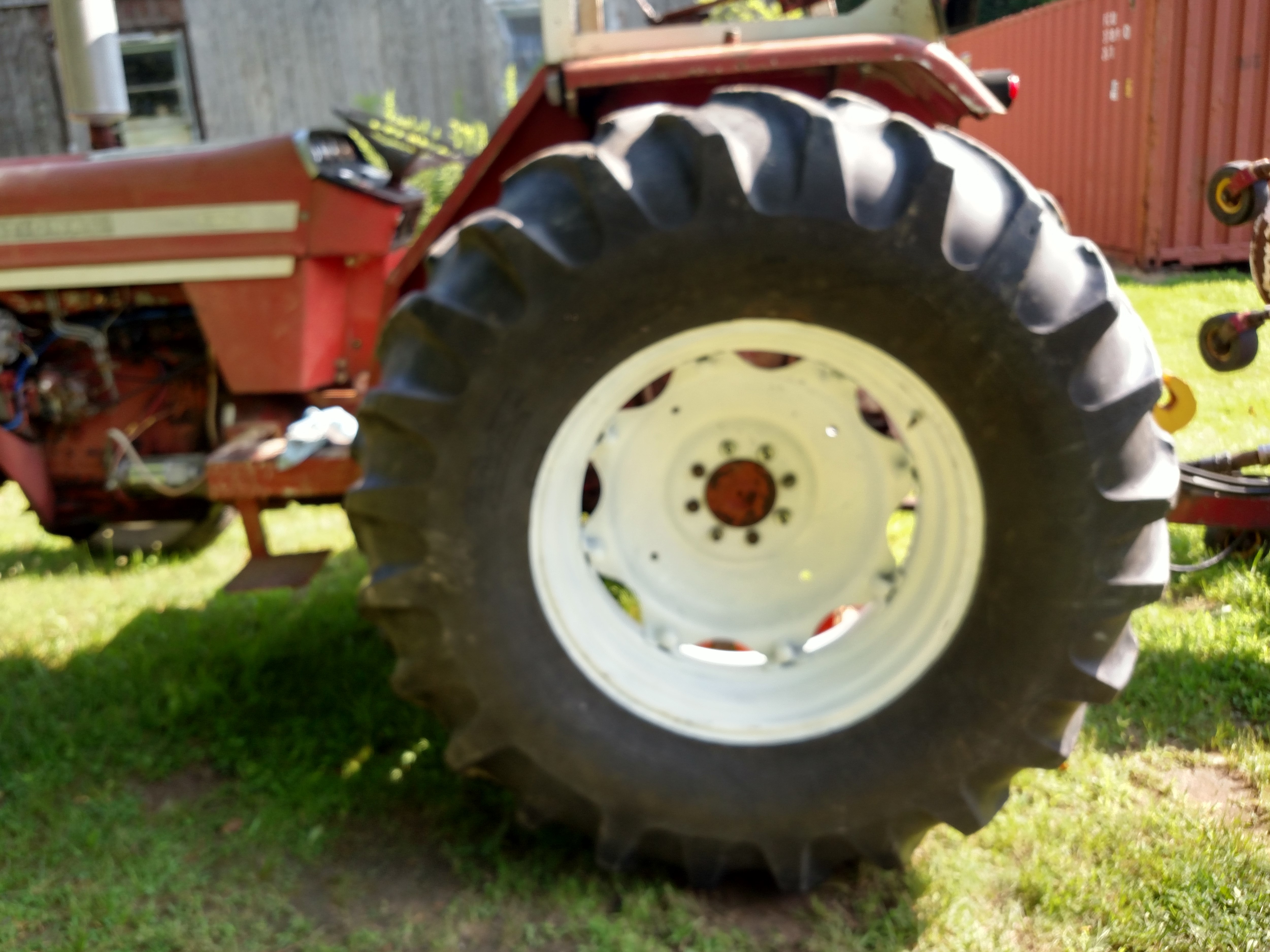

Forgive me for my continued ignorance as I am learning more everyday about my tractor.
Was thinking about doing liquid ballast but considering that when I have a flat, etc, I will need to pay for more and for that matter, when the tires need to be replaced, there will be a cost of pumping out and pumping in again.
Looked at my rear tire rims...,no holes for the bolts to hold the wheel weights on?
Who here has put on weights and did the rims come with bolt holes?
I have a 4520r
Thanks!

No holes for weights here either. I just had mine filled with Rim Guard and was done with it. I haven't had any flats yet, knock on wood (taps head). If you notice a puncture, try to drive it forward so the puncture is straight up, then call a tire service. R-4's are pretty resistant to punctures, at least in our climates (no 6" thorns like TX and CA). And I think you'd have to drive it on paved roads a LOT to worry about tires wearing down.

0A350364-27DC-4C9C-907E-DD91080E3757.jpeg808067AB-CD8E-46D3-842A-189C4B534207.jpeg8AD484A2-01F5-4105-944A-7F7F67988960.jpegSo just heard back from dealer. There is no holes because bolts/studs are already in it.
If you look at picture closely, you will see two of the studs have nuts on them.:thumbsup:
