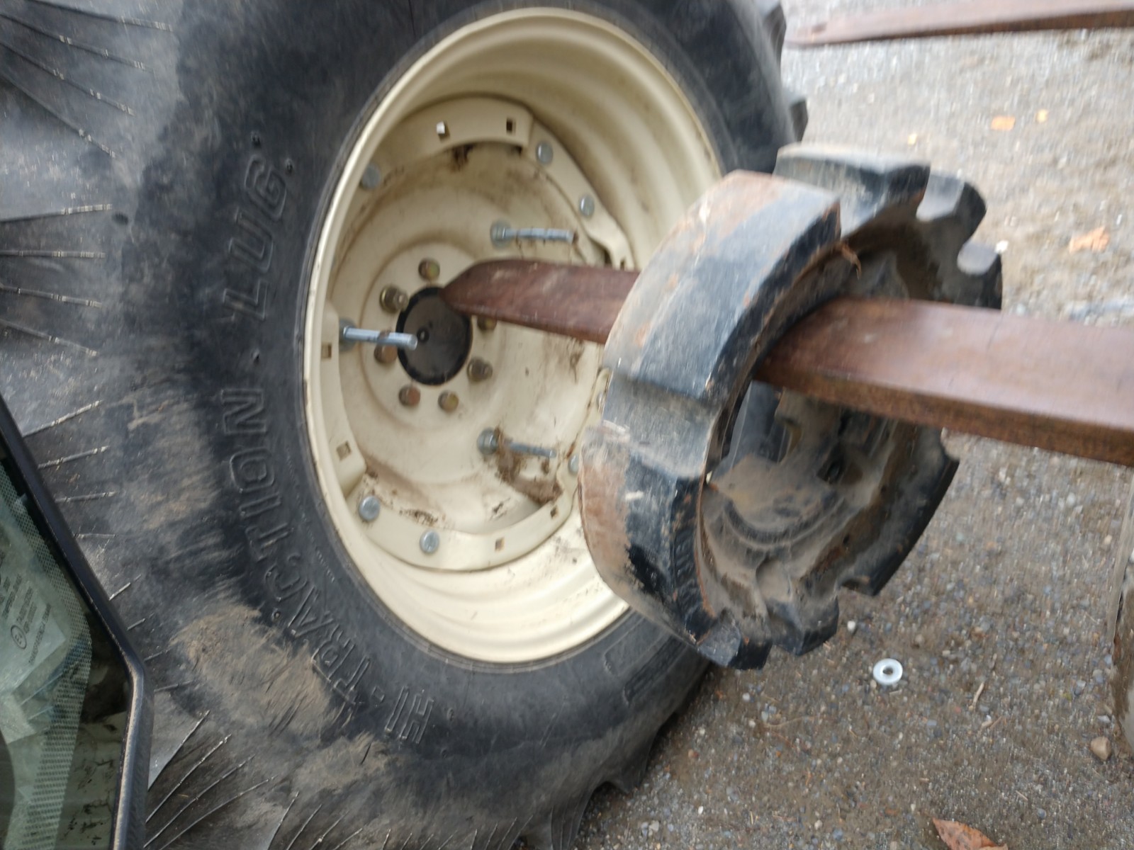

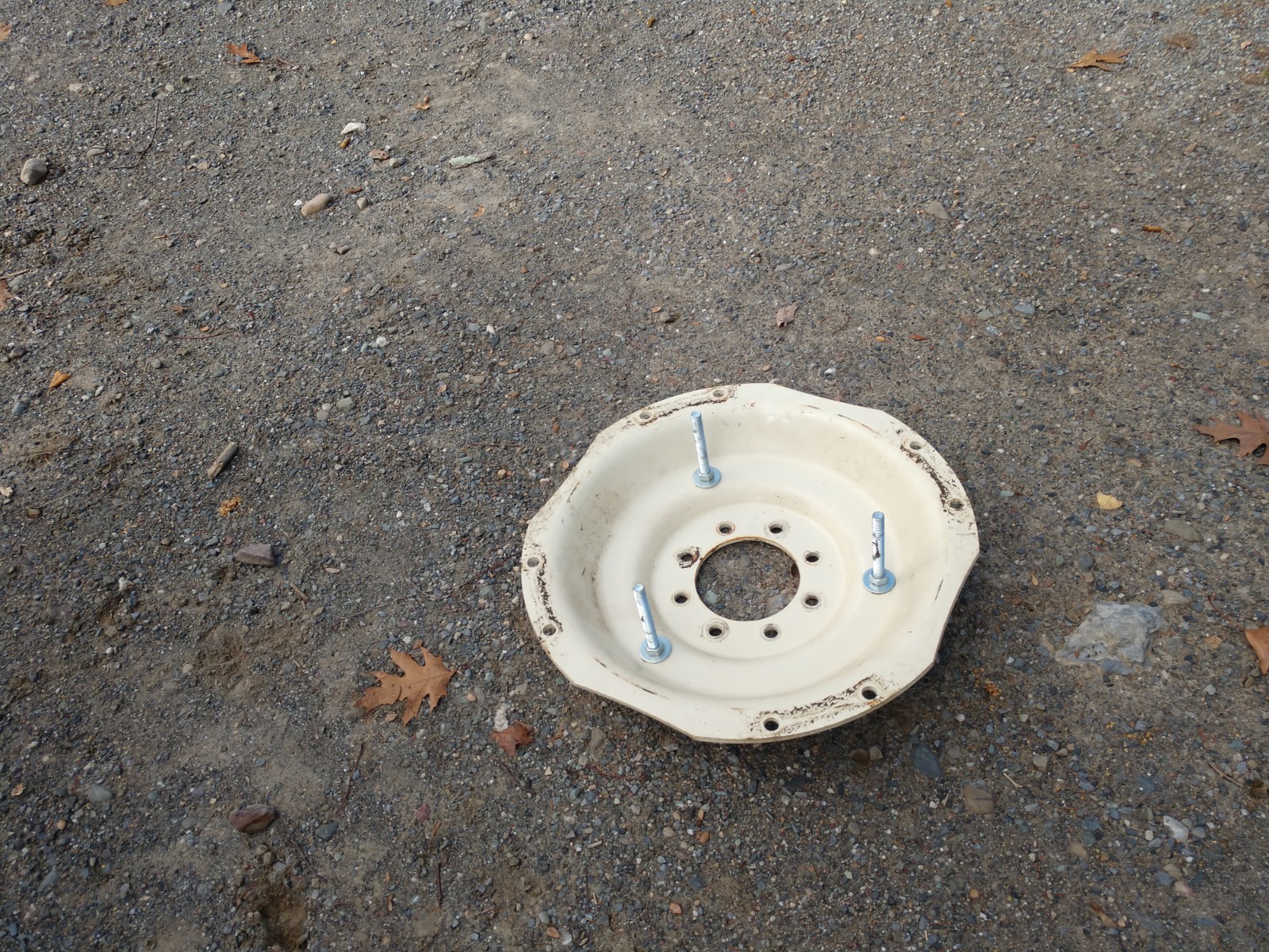

Hopefully you can see the referenced holes in these wheels.
In the first picture you can see the center bolted to the flange with 6 lug bolts and two studs and nuts.
Then there are 3 fully threaded bolts in the next diameter out, then the furthest out are were the center bolts to the outer rim.
The second picture is of the center section and you can see the eight holes for the lugs, the three bolts for the weights, and the 8 holes that bolt to the outer rim.
