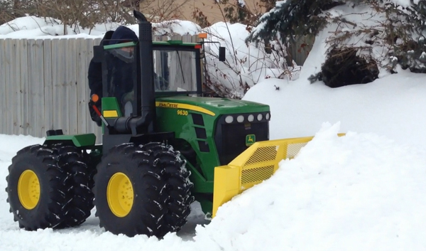

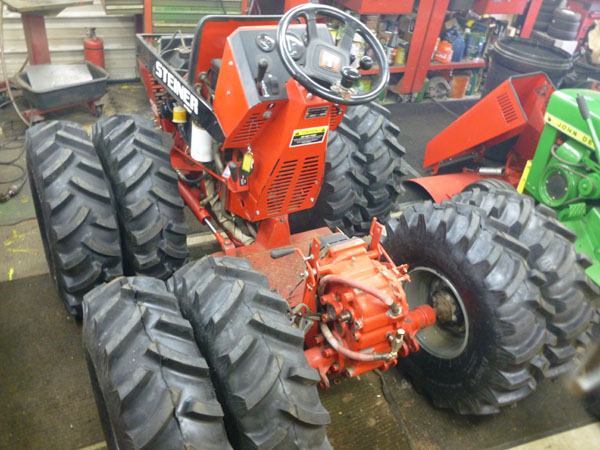

Great job! I would like to get more clearance on my Steiner, what size tires and rims are those? Do you use it in low range to make up for the larger tires?

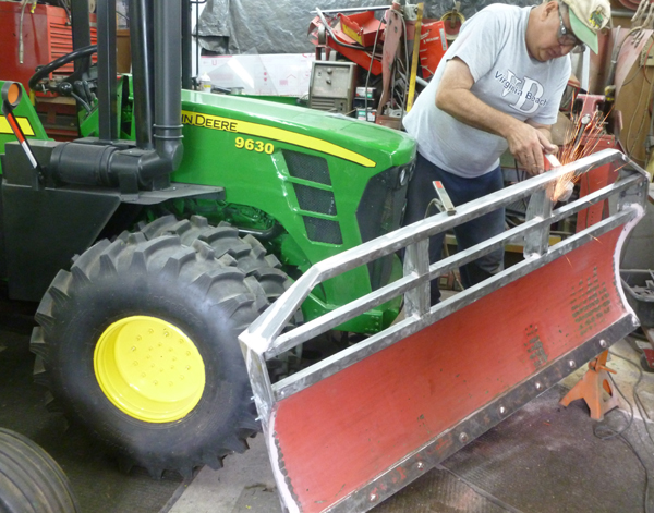

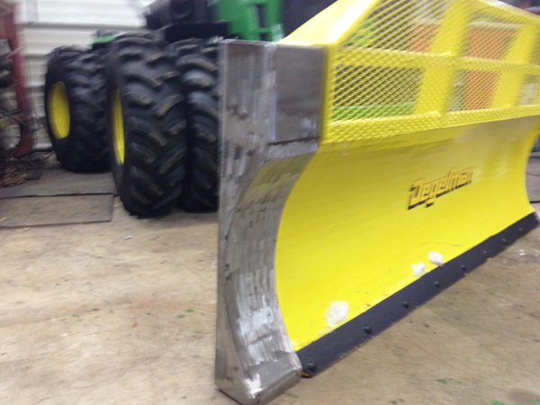

View attachment 356976This week I did extend the front blade on the mini 4x4 tractor by 10 inches so it would clear the outside duels when plowing snow . The extensions just bolt on so they can be removed.
Any chance of getting more views on those extensions?
I'd like to see how they bolt up to the plow.
Great idea.

Thanks , The tires are 30" tall and yes I am now using it in low range and it is a perfect speed for snowplowing. For attaching the wings I welded flat steel to each end of the blade with 6 predrilled holes . Then the added wings have the same 6 holes and I just used 5/16 " bolts to bolt them on.

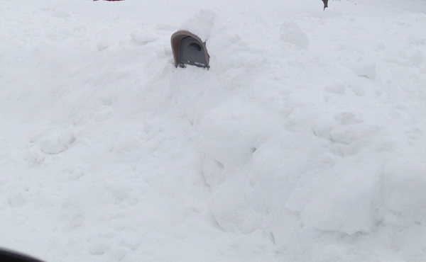

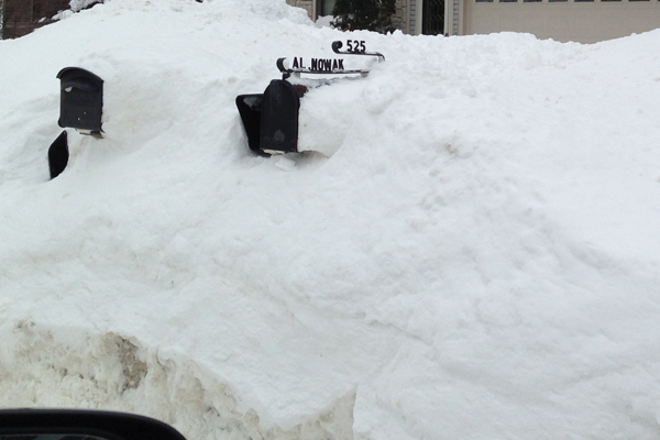

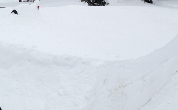

aaabox1.jpgNo I don't get depressed in the spring when the snow melts, I am usually tired of plowing snow. I am excited to get going on the next project in the workshop without having to buy kerosene for the heater.
Here are some pics of our neighbors mailboxes we took today . That is only 135 inches of snow , wait til we get another 70 inches by spring. I am very excited to see a old fashioned winter.aaabox2.jpgaaabox3.jpgaaabox4.jpgaaabox5.jpgaaabox6.jpg
