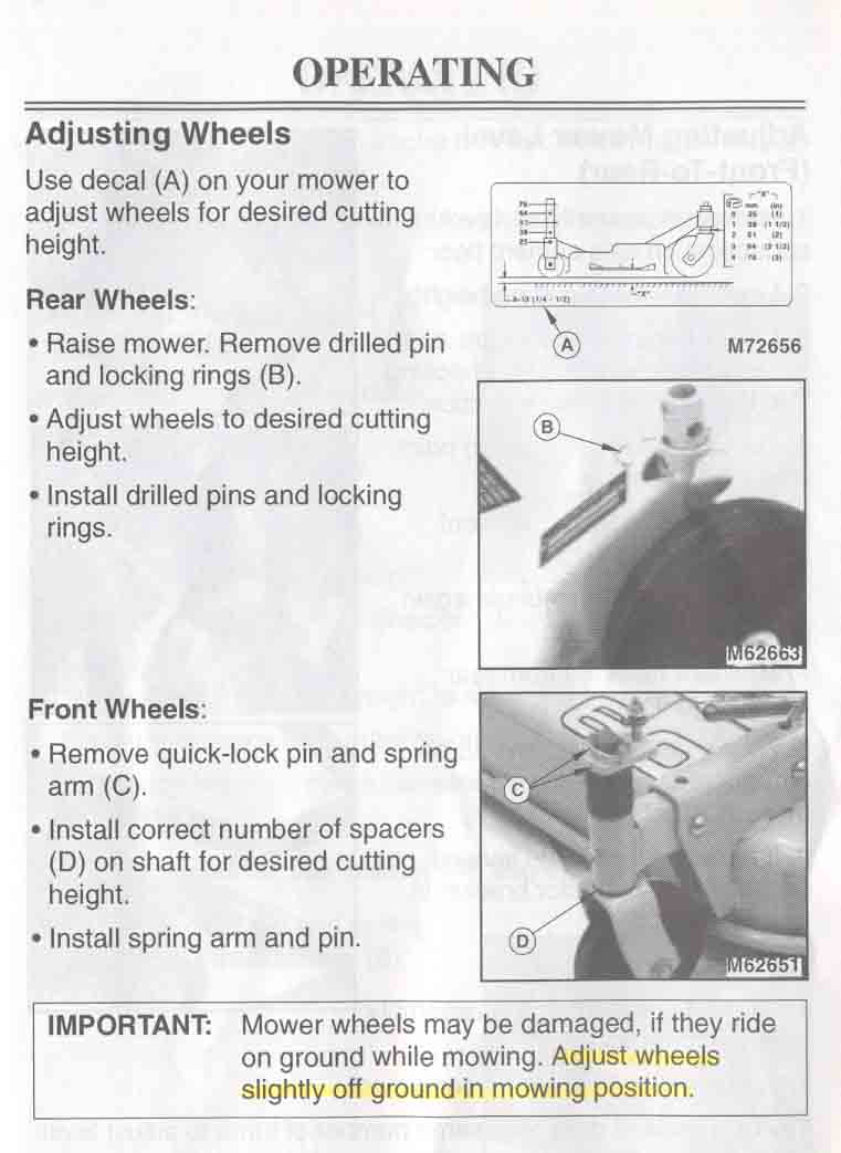

Here is a page from the mower manual re: wheels. The decal on my deck is long gone. I just raise the wheels all the way up, adjust the mower to the cutting height I desire, then lower the wheels to just off the ground. Once is it set, you shouldn't have to mess with it much. One or both of the deck's rear attachment points will have a threaded rod as part of the connection. That is used to level the deck side-to-side.

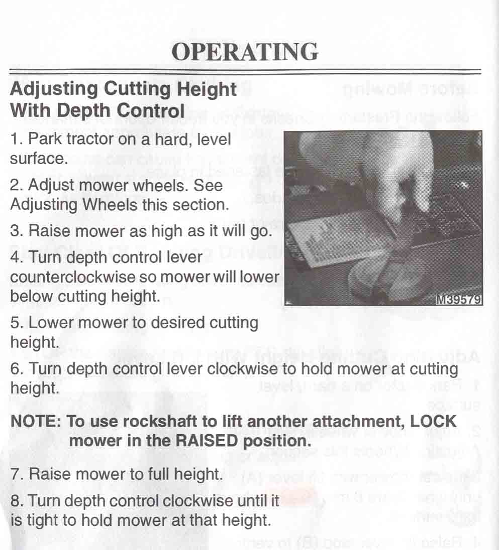

Here's another page re: deck height adjustment.
DaveNay, I supply these pages in case you don't have a mower deck manual. You might find them useful.
