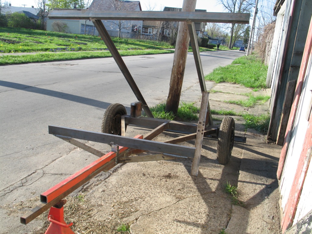

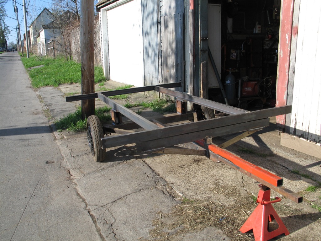

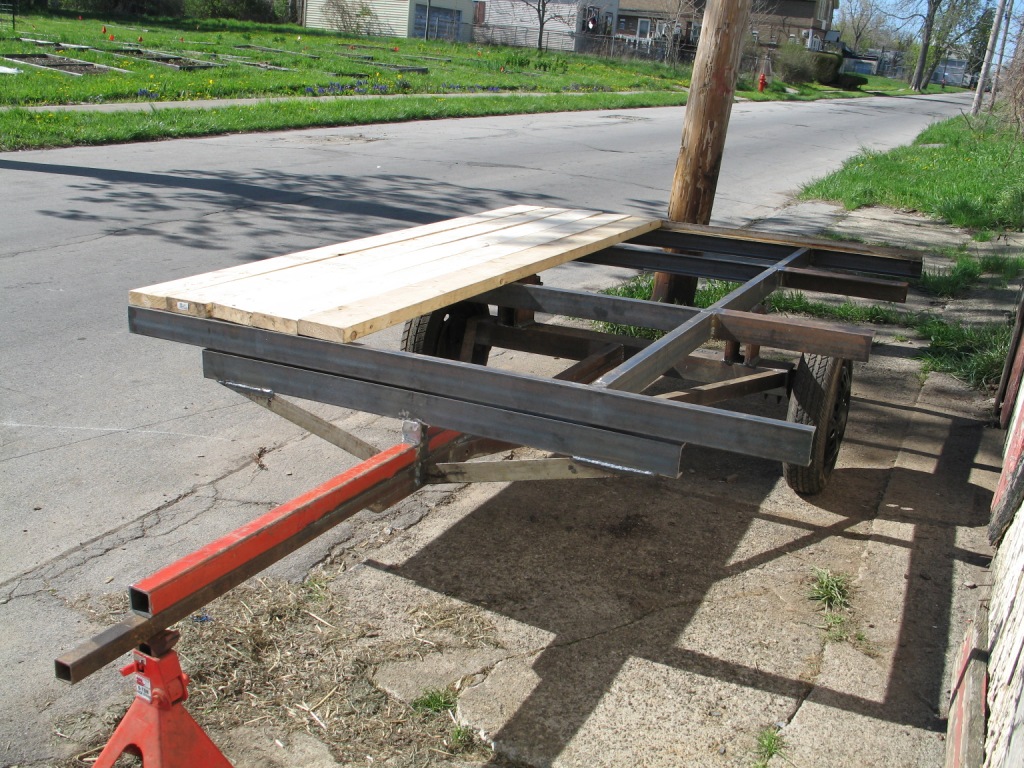

I look forward to seeing it loaded. The toung concerns me and I think your balance needs to be a bit forward. Typical on a road trailer is 60/40. at that I can pick up the toung of my woods trailer when it is loaded with wood and move it around (if I dont pile it heavy in the front) I figure I can lift 100lbs easy enough. Not sure what tractor u have but 200 lb of toung weight is just getting warmed up.
To each his own while I may not agree with the design tour craftsmanship looks good.
Thanks for that ratio, :thumbsup: I was trying to remember what it was and couldn't remember where I had seen it.
Does the design of the tongue look questionable or the size. I am gonna weld that orange 2" box tubing on where I have it setting and if I find more I'll continue it back to the axle.
My tractor is kinda small for this trailer (Link to pic) but if I get a bigger tractor the trailer won't break.

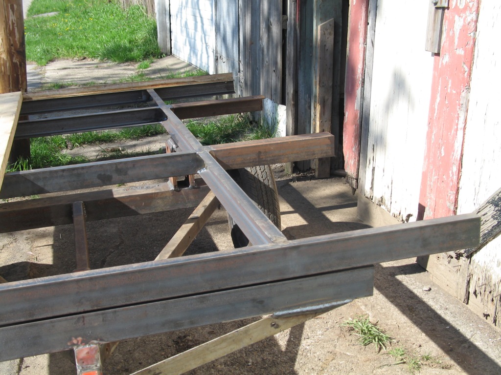

I figured since it was a low speed trailer it wasn't crucial so since I didn't have some I did without. Do you think it will be fine?
Off road, behind a tractor, low speed, yeah. I couldn't tell if it had torsion bar or not. Nice project.

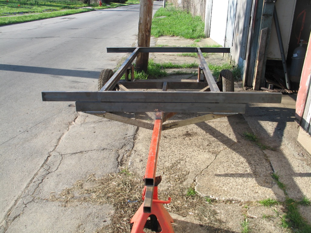

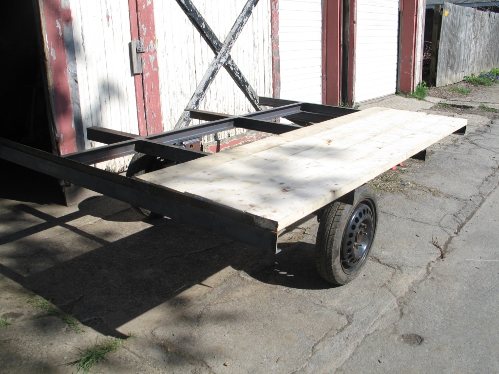

Looks good so far.
The way it appears though, the trailer is going to be built MUCH heavier than either the axle or the tractor will handle:thumbsup:
Yes, I often get carried away with how beefy to make something. You can see I started smaller (the tongue and the axle) and got heavier as I went. I did add a lot of strength to the axle with a large piece of angle iron so the bearings is what would give out first.
And you dont need a suspension for a off-road trailer for behind a tractor.

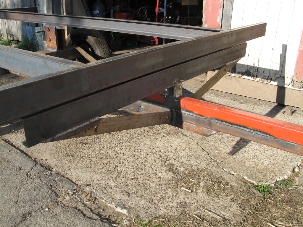

it will be ok as long as u dont overload it

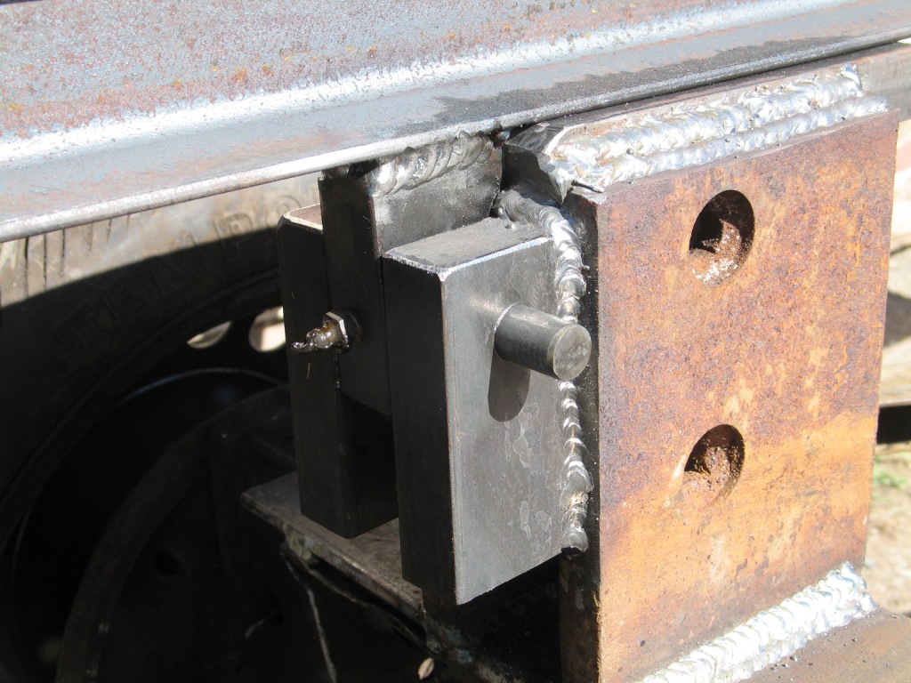

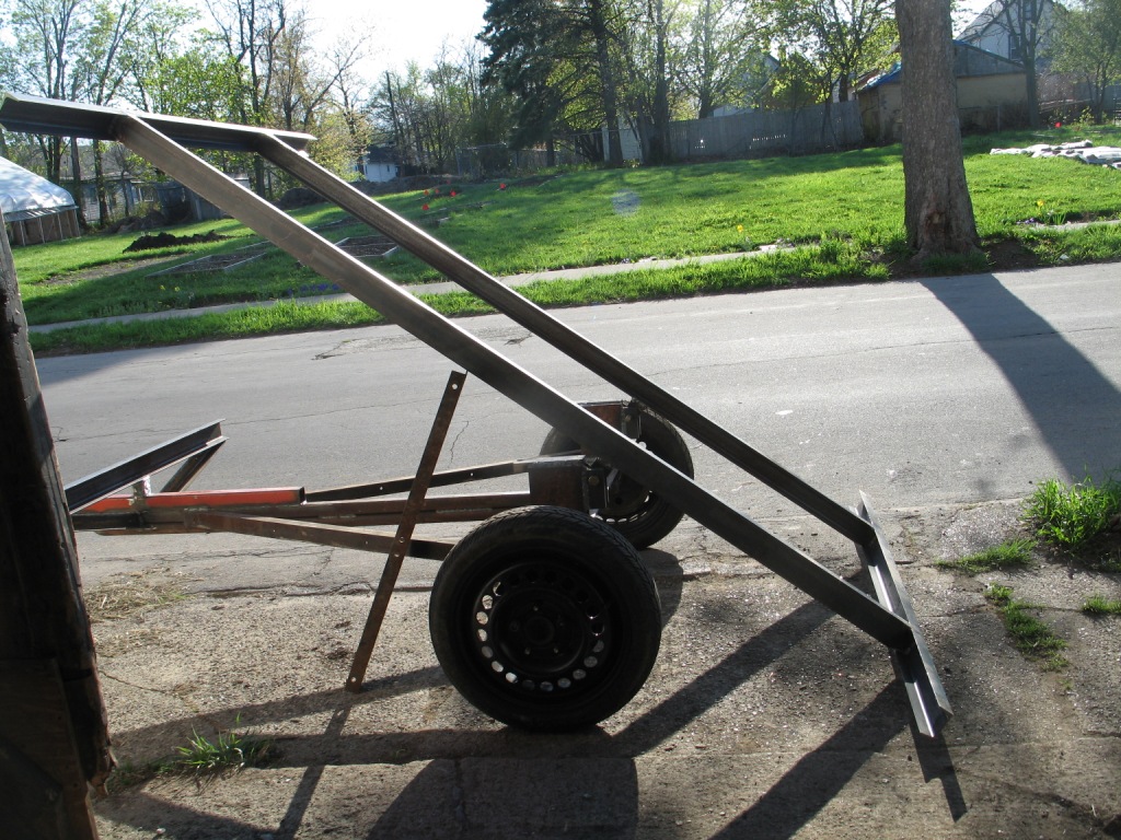

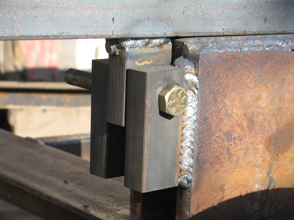

Got a little work done on it yesterday and today. Here are some more pictures.
When I get some more 2 inch box tubing I am gonna cut the small box tubing back about a foot from the end of the larger and weld the 2 inch on the bottom out a little further and either use a pin hitch or a ball hitch on the end.
Does the hinge look alright. That is a 5/8 bolt and 1x2 inch steel.
The upper weld looks terrible cause I am bad at out-of-position welding. I can't keep it from drooping and almost dripping.
Does the welding look alright. I am self taught and have been welding for about a year or two. I haven't had anything fall apart yet although I am lucky cause in the beginning I didn't have any concept of penetration. Now I try to get max penetration without burn though. Sure is fun to stick metal together.:thumbsup:
Comments? Suggestions?

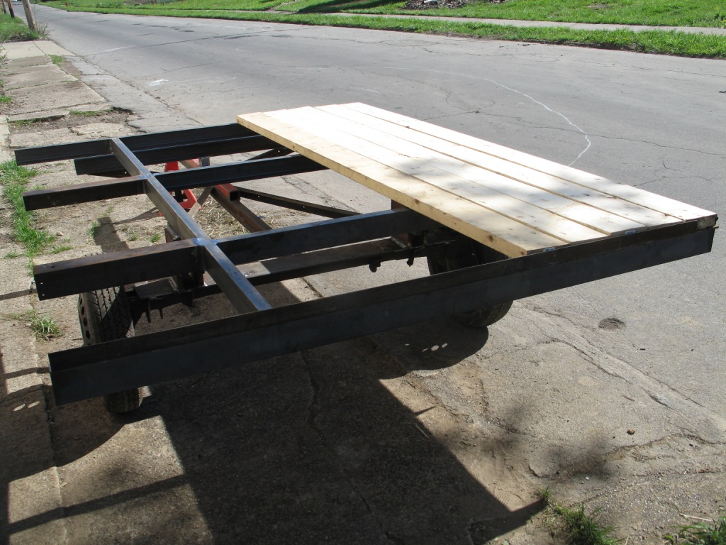

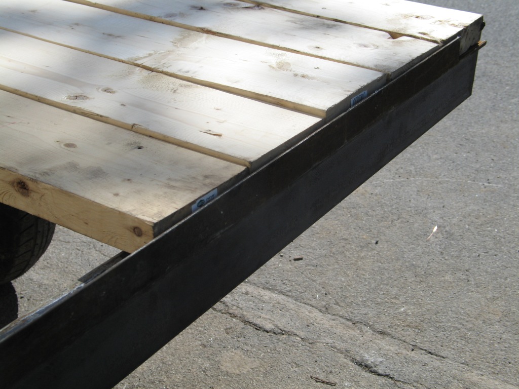

Got some more done today.
I set some boards on that we had sitting around and it looks like it will work great. 13 2x6x8 with no cutting. I left clearance so I can put larger wheels on in the future.

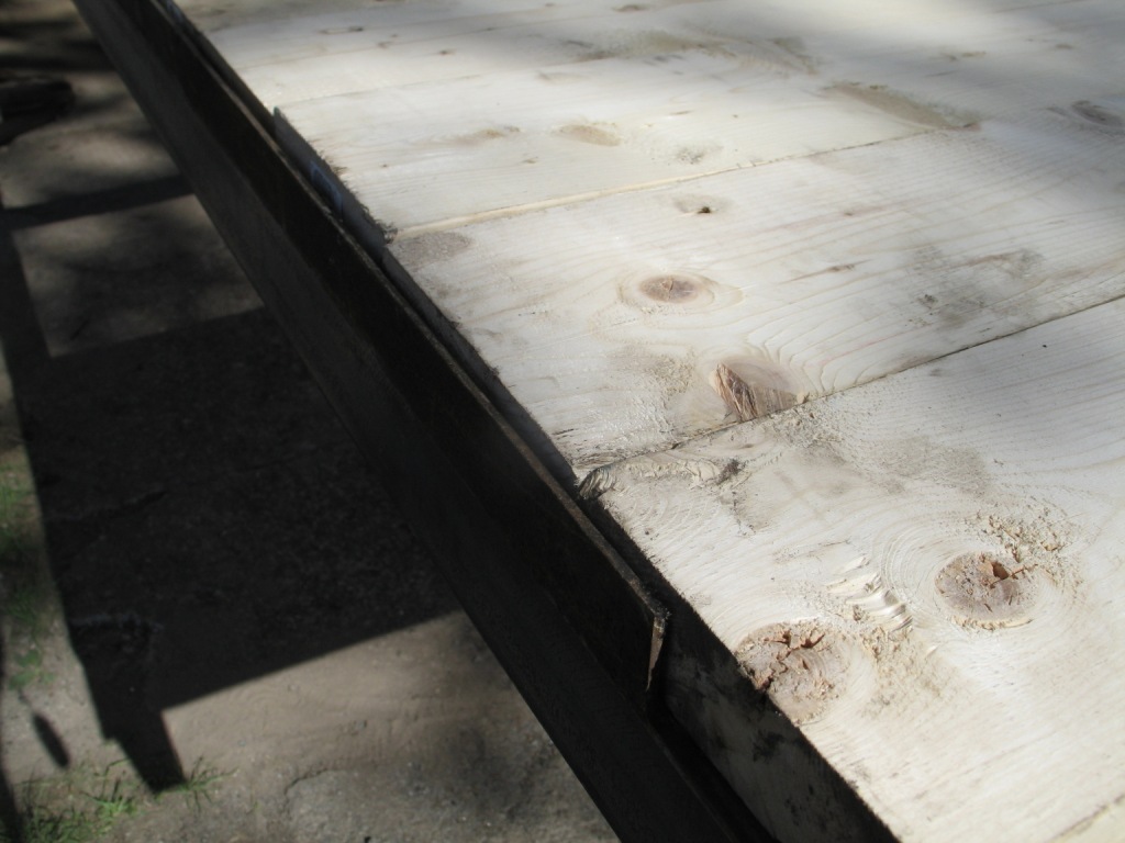

This next one shows the angle iron I am putting around the edge.
I drilled and tapped for grease zerks on the hinges and gave it a few pumps.
It's coming along nicely.

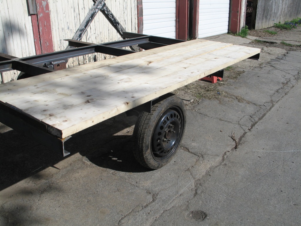

I am waiting for money to get the floor boards and material for the sides so there may be a short wait for it to get finished. Maybe if I can find some paint I could give you-all something to look at in the meantime.
Today I used it. Threw some scraps of particle board on for the bed and picked rocks. Works great. I didn't get any pictures but I know there is one pic that my sister took where you can see it in the background empty. I could probably post that one up tomorrow.
   / My attempt at making a off-road trailer. #30
Looks good and I am sure it is going to sreve you well.
