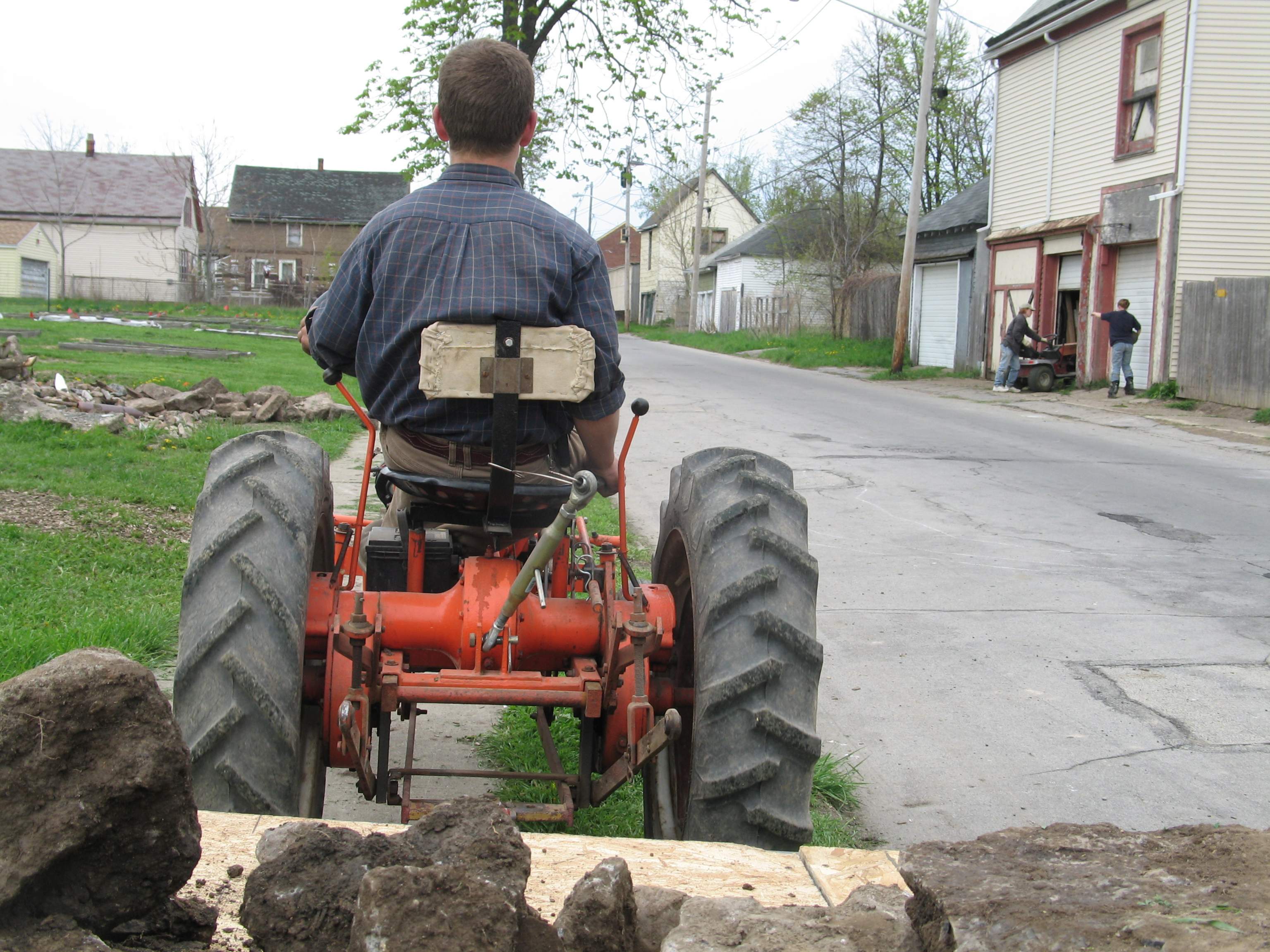

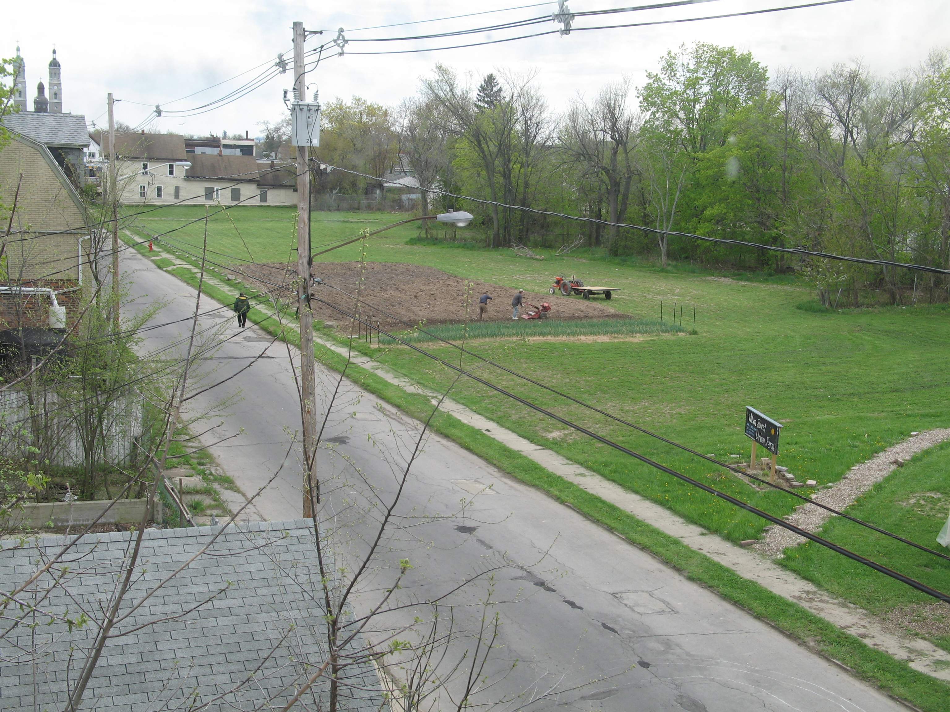

As promised here are the pictures my sister took yesterday. She happened to get the trailer sorta in a few.
(sorry for the size, I am on a different computer and don't know how to reduce them.)
Riders view.
